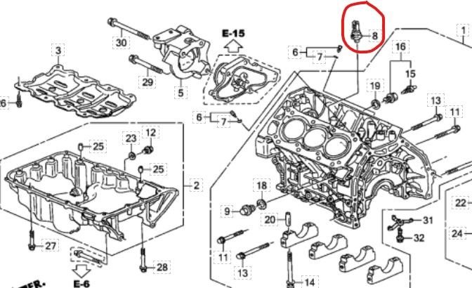

With that said, #8 gives an idea as to where the knock sensor lives.

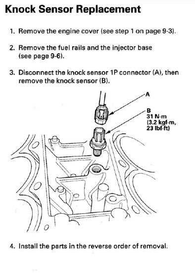

According to the FSM, to get to it the intake manifold & injector base needs to be removed then you have the cost of the sensor, which is $52.
Preferably, you'd want to get the OEM sensor because it is best.
Cylinder Block - Oil Pan - 2005 Acura TL 4 Door BASE (NAVIGATION) KA 5AT (acurapartswarehouse.com)

Agreed, no need for removal of timing belt, but definite removal of the intake manifold is required.
