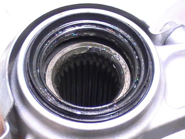

Here are a few pictures, for comparison, of an extra CL-S six speed intermediate shaft I have with only 18K miles.
As you can see, there is some grease within the splined receiver, though, once it would mate up with the inboard
male part of the passenger side axle, the seal would help contain it.
Looking at the inner part, there does not appear to be 'gobs' of available grease that would tend to 'leak' after
many miles of use?

Yours does not look that 'bad' IMHO; however, since you do not mention how many miles are on the one pictured,
I'm not sure to speculate.
Maybe hose both greasy sides down with brake clean and monitor for a few weeks to observe whether the
'leaked stuff' returns?
Good Luck!
