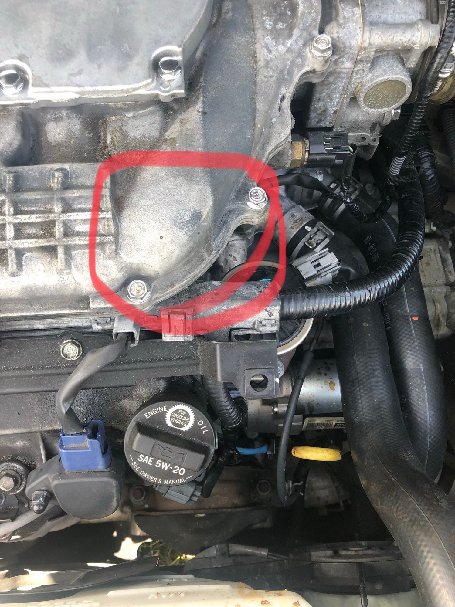

Where is the sound coming from? Is it RPM specific? Where there any other symptoms? Did it just happen out of the blue? Need more context to give a proper reply.

No it is not rpm specific it’s there as long as the engine is running. I literally went in to the store came out and the sound was there. It sounds like it’s coming from the area right where the egr is

Cool EGR sound?
Sounds like sucking big air--like the EGR/hose connection broke or sumpin'.

Sounds like it coming right from that corner

And the sound will actually change a little bit under acceleration

Sorry. Your car has the ebolaids.
Sounds like air.
I'd clean and check the EGR first. Remove it, clean the interior with brake cleaner and reinstall it. Make sure it's on tight.
Then check the PCV valve. Remove, clean, or replace. It's a bit tricky to find. It's attached to the front valve cover, kind of under the intake manifold.
After that, stick some tape around parts of the intake manifold, throttle body and other areas where air could escape to see if the noise changes. If it does at certain places, then you can deduct that air might be leaking from that spot.
Check all vacuum hoses. There are a bunch coming out/going into the throttle body. Make sure they're all tight. Check for holes or cracks in the hoses as well.
Old Apr 6, 2018 | 02:42 PM
sounds like pinhole leak to me!
very high pitched - small hole.
