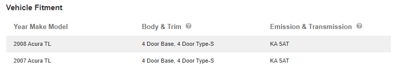

RockAuto:
Even though the zip code is a guess, included shipping to Poland still beats the OEM online price??

Rock Auto Is quite nice - I am collecting the magnets they add to their shipments 😊
They haven't got the Denso radiators 3 weeks ago in their offer. Thanks.
