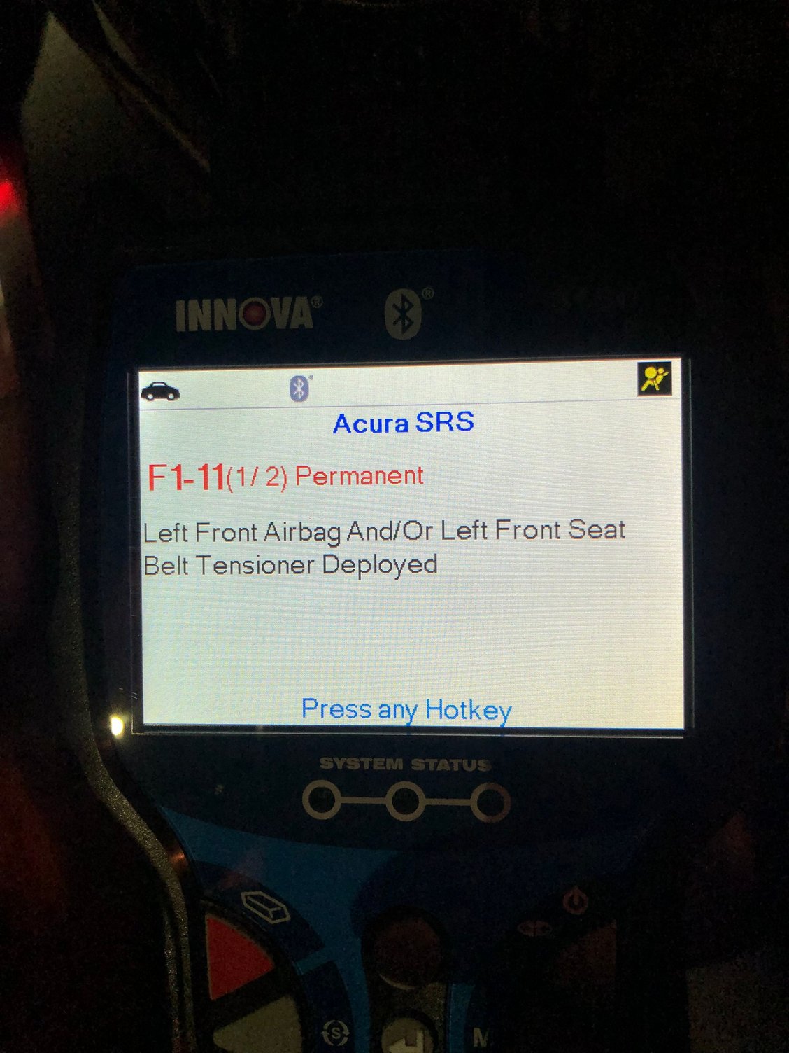

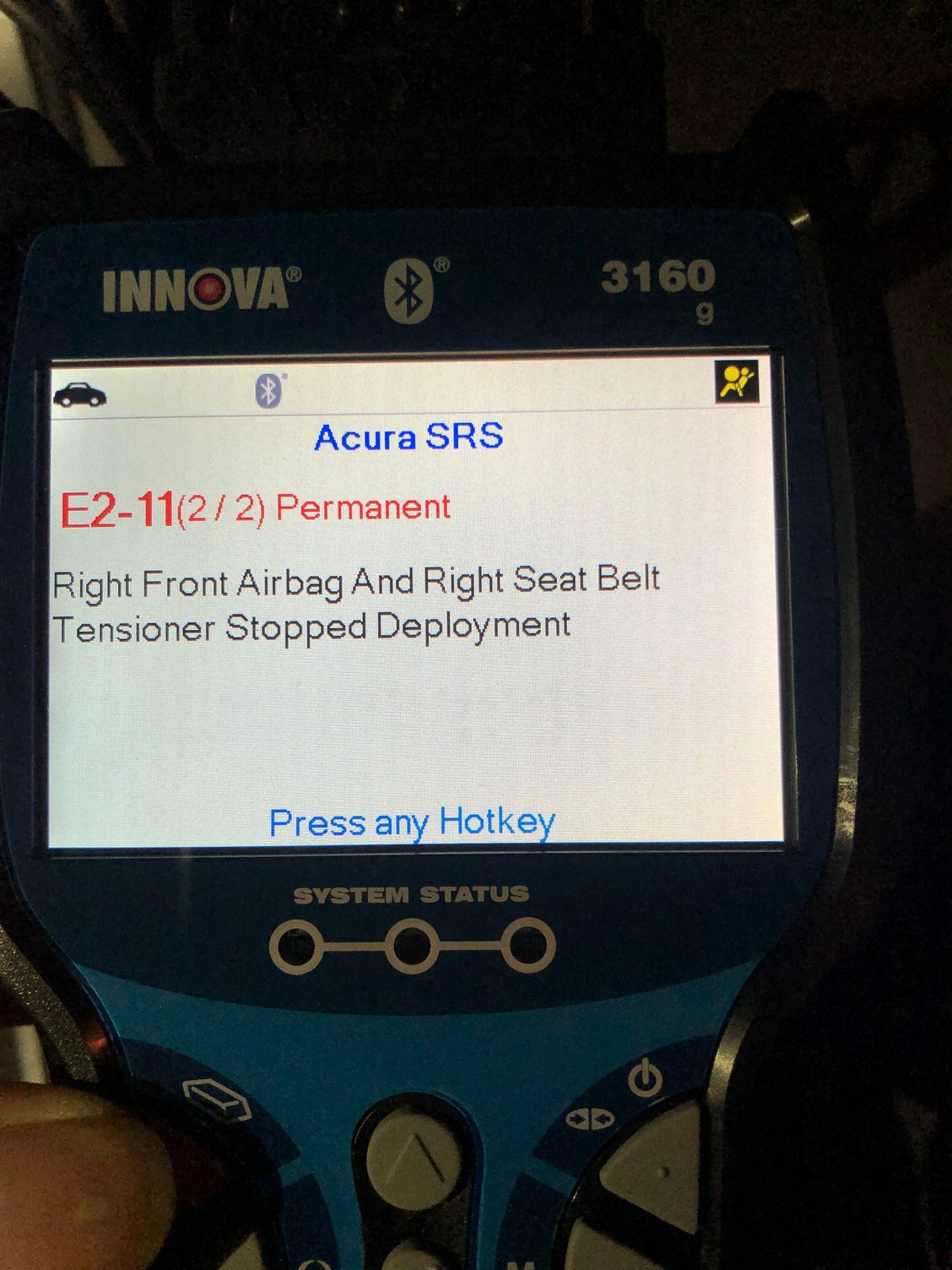

HElp pLEase!!!!!@@
Can anyone help me out? What do i have to do? Thank you !!
Old May 19, 2019 | 06:47 AM
Replace SRS module/replace air bags. Replace Seatbelt/unlock seat belt.
cant really help as those are pretty self explanatory codes that you have thrown.
replace the air bags , unlock the seatbelt.

Usually the SRS system needs specialized equipment to reset, even after a repair is done.
On one of my cars a P/S seat sensor went south and the SRS light was on. Replaced the sensor and the light remained on, so hooked up my scanner for the SRS system, did a reset and light went off.

dont buy a new unit, this company can reset them!
https://www.myairbags.com/product/ai...odule-reset-3/
they repair seatbelts too
