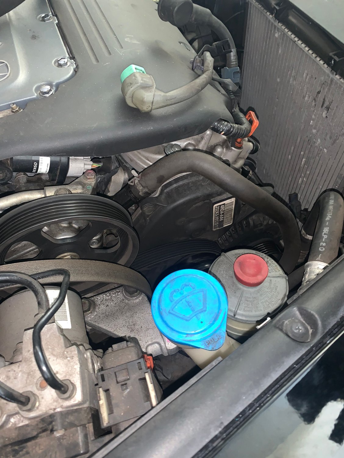

So while changing the alternator to the brand new one, I was shocked to see that the Front Motor Mount was completely toast!! I’m going to remove some covers in order to check the other 2 in the engine Bay. I already checked and the Hydraulic Mount is about 160$ and the rubber mount is about 70-80$. The rear hydraulic mount is also about 80$ if that needs to be changed as well! Any suggestions on brands or other specific aftermarket mounts for my TL?

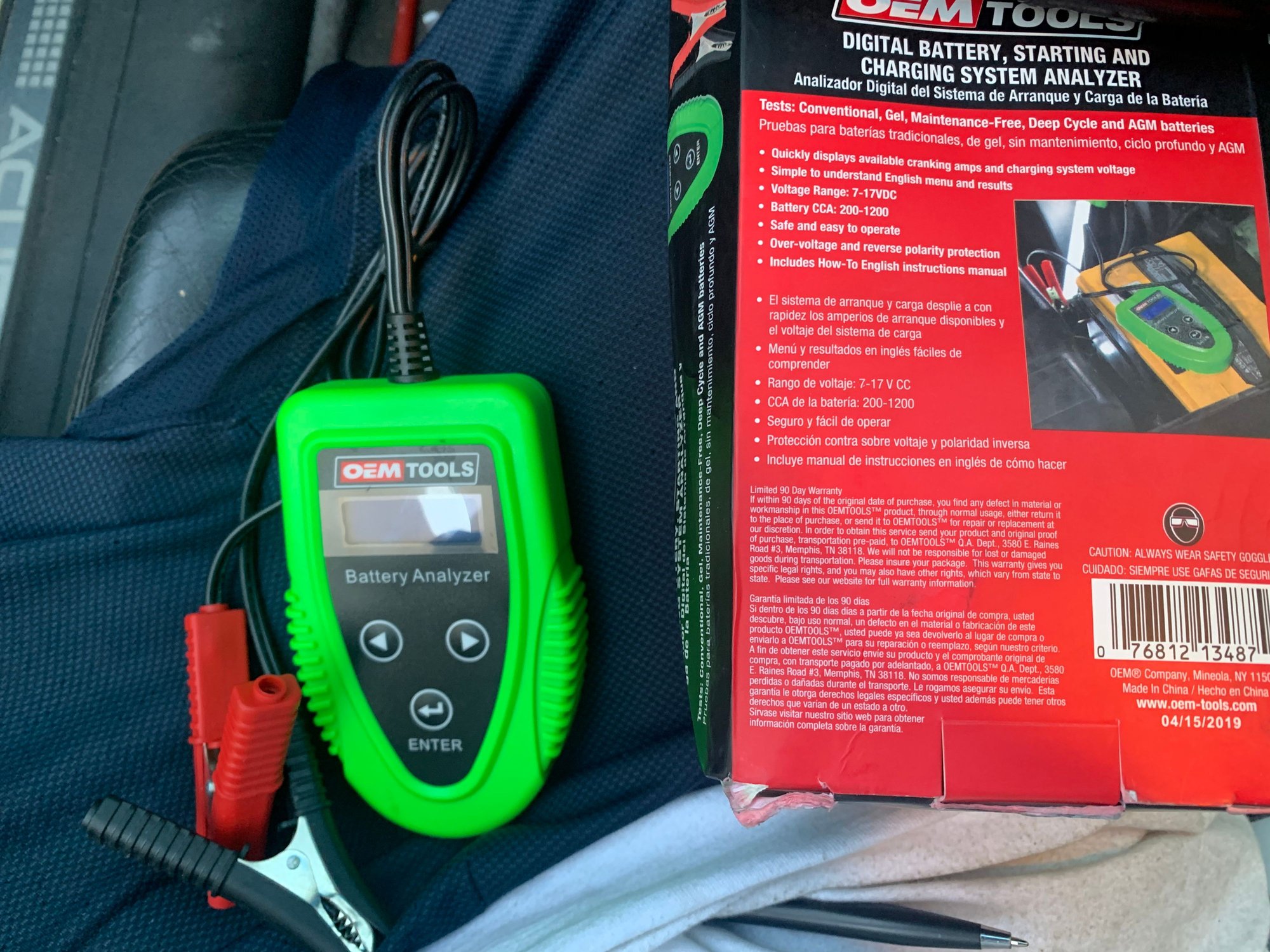

Oh and here is the Tool that I use to check the status of my battery and charging system. I also have an older analog one that just has A regular meter for the battery/charging system but it’s kind of hard to get A good reading on anything besides the battery! This electronic digital analyzer is one of the best and cheapest meters I’ve come across!

That's actually the side motor mount, not the front. The front is right under the radiator in the front of the car.
they have a couple options here on Rock Auto: https://www.rockauto.com/en/catalog/...tor+mount,5552
Correct that you are lol, well let’s say it’s one of the front motor mounts haha? Yeah the one under the radiator doesn’t look like anything’s wrong with it, but I’m also only looking from the very top of it which isn’t letting me see it entirely.
