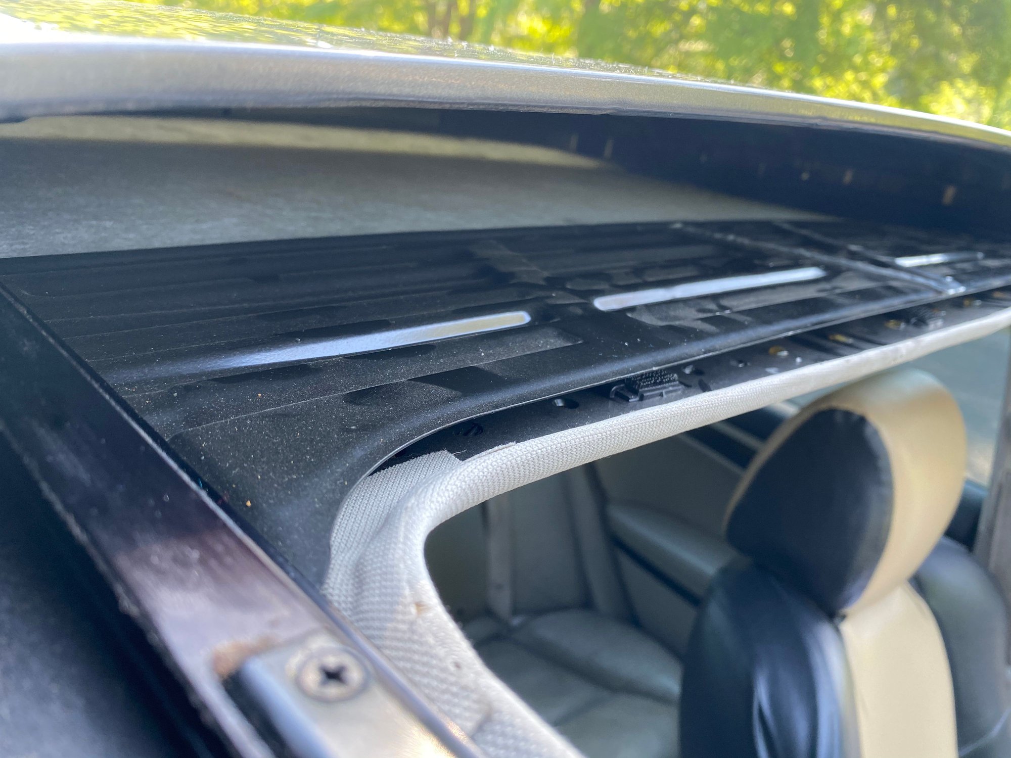

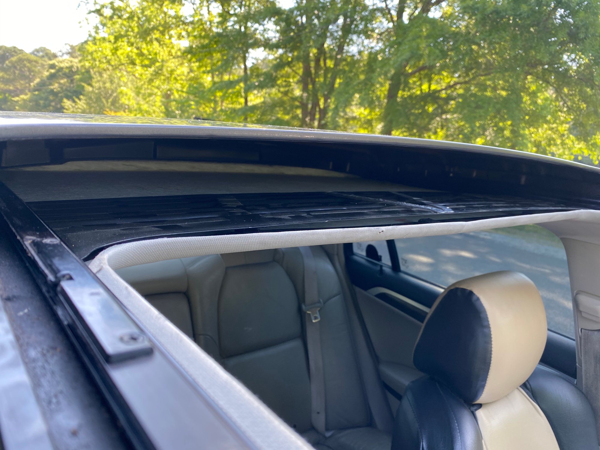

So last night I was pushing the car going around 130 mph on the freeway and all of a sudden a huge and loud pop happens and I look up to where the sunroof used to be and it’s not there. I don’t know what happened for it to just fall out from where it goes and if that is even possible. I’ve looked at the damage today and the entire glass and cover are just gone. When i push the sunroof button I can hear the motors whirring but of course nothing happens. I just want to know what I’m looking at in terms of replacing the entire assembly and glass.

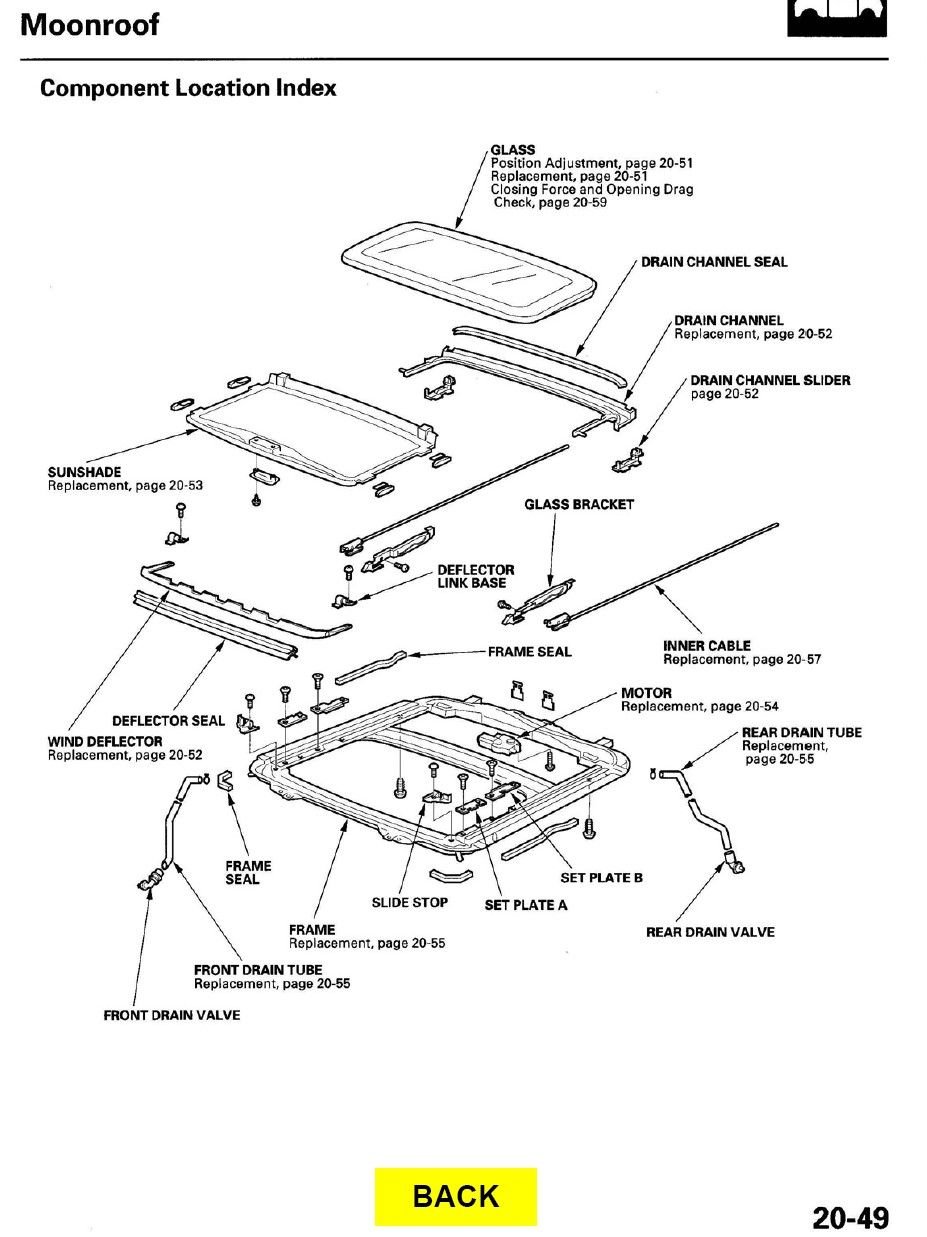

Find the parts you need on the OEM link below and price it out if you want to try a salvage yard near you search car-part.com:

Use service manual and oemacuraparts to figure out what is missing on your car.
https://www.oemacuraparts.com/v-2008...--sliding-roof
Like zeta wrote, might be better option to go through used route, and would be best if you would find "pull your own parts" style junkyard and just replace the whole frame.
