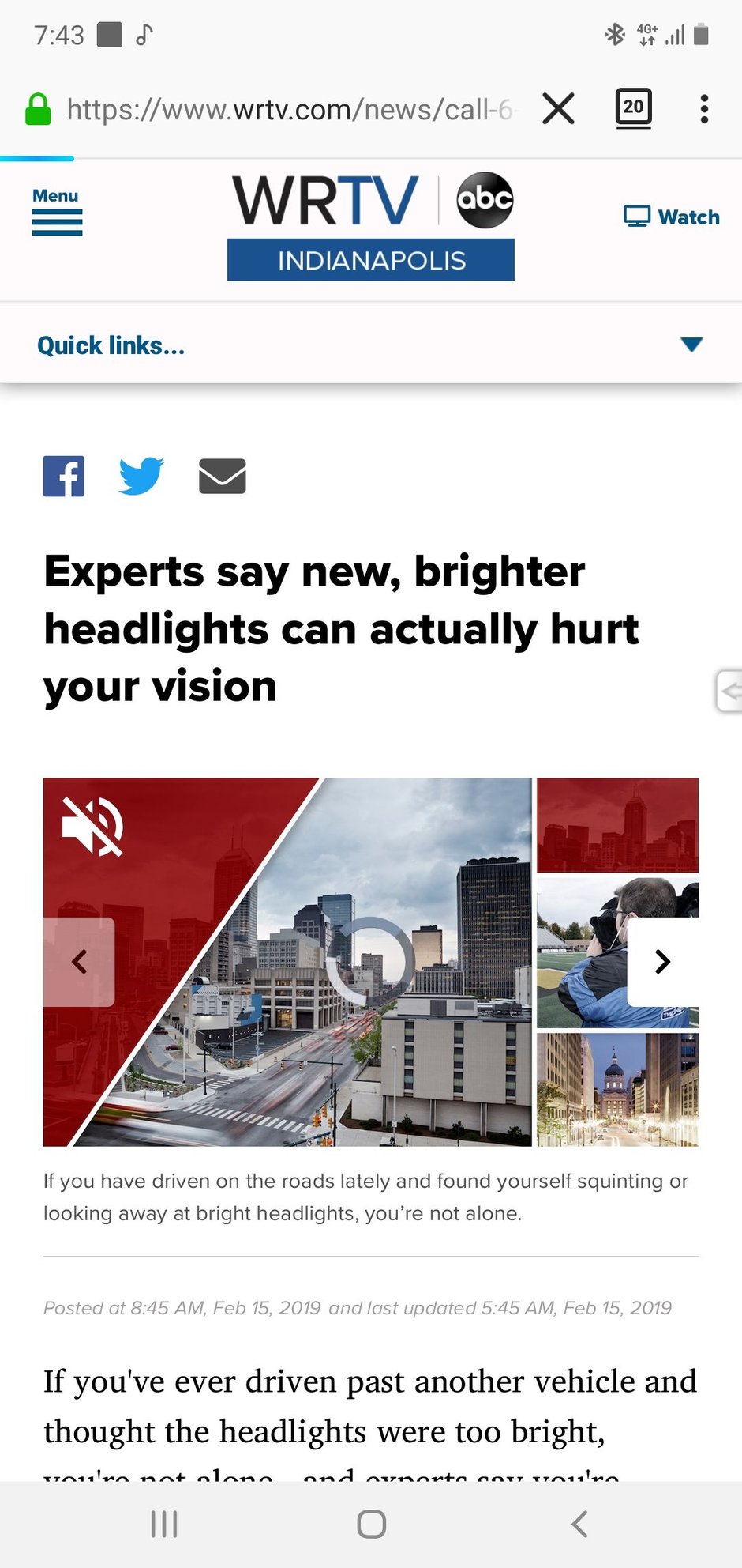

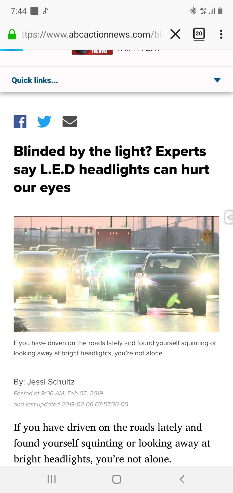

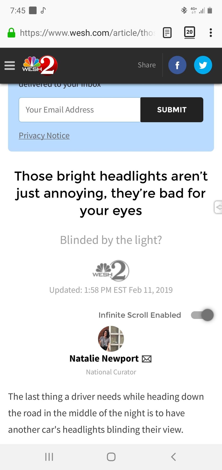

I admit that I don't kmow much about bulbs in so much as i didnt know maybe what i was asking could have possibly been a lower 'k' setting? what ever that means?! I found one set at 3500k, i assume the laser beams i am referring to os a higher 'k' setting
So am i the only one who knows so little about new bulbs that cause eye damage and is also dangerous to on coming drivers? Maybe just a tad of common sense not sure, but i did a search, judge for yourself

1. "K" refers to the color temperature
You want ~4000-5000K for max light output, up to 6500K for good light. Go higher into blue or purple and you lose brightness.
Actual amount of light output is measured in lumens, but method of measurements vary. I might be wrong but I don't think there is standardized test that all manufactures follow.
2. When doing research check the sources. Typing phrase into google and posting first 3 articles is no research.
Do authors of those articles actually did some research or are they also basing their views on "common knowledge"?
Additionally "Experts say that..." articles are usually click-baits (just like "You won't believe that....").
3. Nothing good will come from $12 HID bulbs. Others gave you options and use those or you will be buying another set of bulbs very soon.
4. If you really want shitty lights, just glue H7 bulb to the projector and call it a day or adjust your headlight so they shine straight down.
