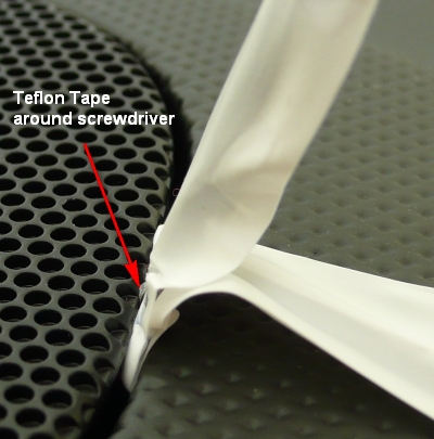

As the car was only 10 days old, I was scared to death of marring the dash or bending the metallic grill (may be plastic, not sure), so I spent a lot of time thinking about the removal. I ended up putting some plumbers teflon tape on the edge of my screwdriver so I could slide it in easily
It went in very easily, and I then tilted the screwdriver until the grill 'popped'. Once the right side was popped, it was easy to grip the front/back of the grill and lift a little, causing more retaining clips to pop. However, I could see the grill bending, and was scared to lift too hard from the right, in case I got a permanent bend in the grill, so I struggled with this for a while. Eventually got the final clip on the left side to release. NOTE: Each clip location has a corresponding recess and you can use this recess to a) know where to apply pressure, and b) use it as a 'pry point' if you really need to.

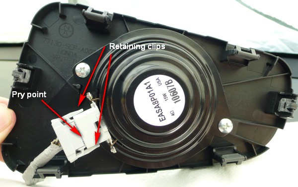

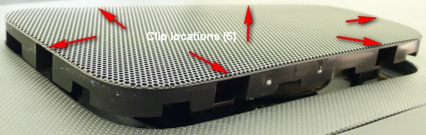

Yes, there are SIX clips for the '07 TL; I don't know when they changed from 4 to 6, but they have added two clips at the back (nearest the windscreen) - possibly to address this issue
. Also, note that the two side clips (left and right) are 'double sided' clips, while the four front/back clips are single sided - that is, they only have a protrusion on one side. Thus, the front/rear clips come out much easier. And while the two side clips, and two front clips, have corresponding 'slots' cut in the dash, the two rear clips (rear=windscreen facing) simply press against the dash material.

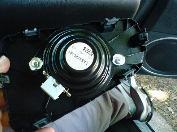

OK, so now the speaker is completely removed. Here you see the six clips clearly, and the connector.

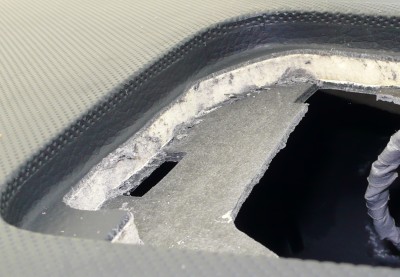

So here's what the previous post said to do (as I read it) - apply tape to the base platform as follows (shown here without tape):
left:
right:

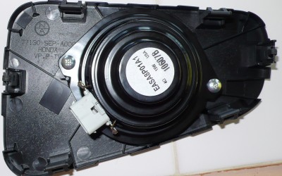

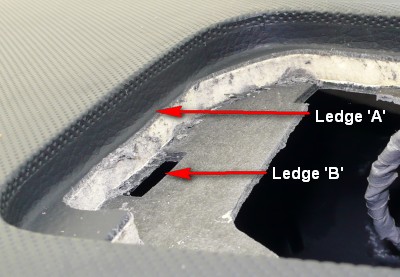

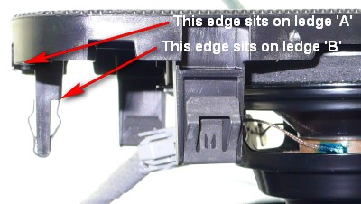

But I feel this won't help because there is no contact between this platform and the underside of the speaker. Look at the speaker grill profile:
and look at the base:
The edge of the speaker sits on the first ledge ('A'), while the clip has a protrusion that sits on the lower ledge 'B'. Thus, any padding applied to the ledge 'B' would seem to do nothing, since there is nothing for it to press against.

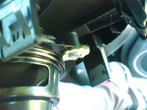

The nature of my noise is very much mid-tone vibration, so I did the following test - I suspended the speaker/grill assembly on one finger, and hit the grill as if hitting a 'gong' or drum -

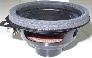

and I could hear a definite vibration. I noticed the speaker, while tightly screwed in, did not feel like it was held strongly against the grill. So I removed the speaker. Here's the top of the speaker:

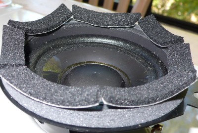

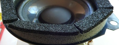

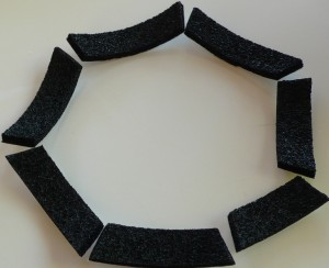

My theory is the foam rim of the speaker is not pressing hard enough against the grill protrusion, so I cut several pieces of foam (this is the 1/8" closed cell foam) as follows - first I did a 'dry fit' (before removing the backing):
Note, I shaped the edges so the foam could fit:
End result, stuck to the speaker:
and here's the speaker/grill, re-assembled:
(the writing on the speaker, for what it's worth, is "EASA8P01A1 4 ohm 15W USA 10607B')

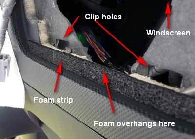

Finally, I decided to put one more piece of foam (1/8" closed cell) in the area, simply because I don't want to have to keep disassembling. I put a long stip of the thin foam along the front ledge, so that the grill would rest on it:
Reassembled; NO NOISE !!!!!!

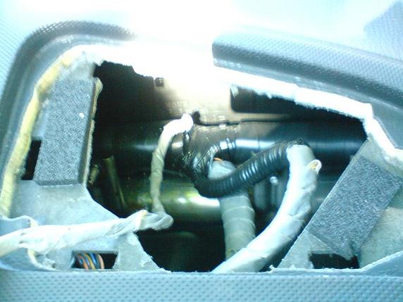

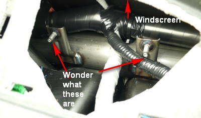

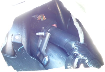

While I had the dash open, took a few pictures of the inside, in case they are ever of use for the future. Figured I'd post them here for reference:
and a view towards the back of the spedometer area:
. Also, note that the two side clips (left and right) are 'double sided' clips, while the four front/back clips are single sided - that is, they only have a protrusion on one side. Thus, the front/rear clips come out much easier. And while the two side clips, and two front clips, have corresponding 'slots' cut in the dash, the two rear clips (rear=windscreen facing) simply press against the dash material. OK, so now the speaker is completely removed. Here you see the six clips clearly, and the connector.
