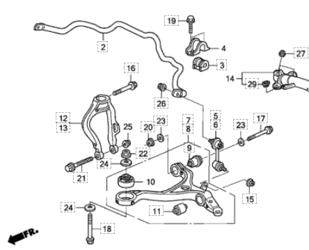

Do bushes #9; 10 & 11 below show any signs of deterioration or tearing when up on the lift?
Are sub-frame bolts #25 & 26 properly fastened?
Are the #3 and two #14 steering rack bushings in good shape / tight?
Otherwise, outside of everything you have listed that was checked, not sure.
Bushing 10 has a little bit of wear, the subframe bolts seem to be tight as well. As for the rack the passenger side looks a little worn, theres a leak but i haven't noticed any steering issues at all or big loss of steering fluid (not sure what the symptoms of that would be) i will also double check the subframe bolts as well, can't leave any stone not double checked lmao I've been triple checking everything
