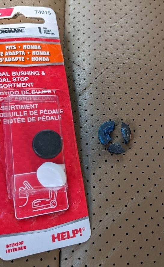

Got back home and noticed my brake lights were stuck on no matter the pedal position! Contorted under the column and pulled off the black plastic cover that hides the stuff above the pedals. Found the brake switch and also the problem!

If you look at the switch in above pictures, the switch touches a WHITE CLIP that is attached to the brake pedal. My clip (blue) came apart and the switch was not operating correctly.
Part is only $3.17 from acura:
https://www.acuraoemparts.com/oem-pa...bC12Ni1nYXM%3D
but almost $10 at local auto stores!!! Next time you buy anything for your car, pick up an extra one as this one was factory from the car almost 17 years old!
here's the autozone one I had to get:
https://www.autozone.com/interior/br...015/343710_0_0
Save yourself some time and energy and have the stupid clip on hand.

I was tempted to use some self adhesive pads for the bottom of dinning chairs as a temp fix to save $5 and wait for the $3 on ebay vs $10 from autozone. But decided wasn't worth having an issue a week down the road before the bit arrives. Either way I got it fixed properly. Autozone had the doorman part:

Thanks for this thread. Sure enough I found telltale broken bits in the footwell.
While I waited for the part to arrive, I pulled the 20A "STOP" fuse in the engine bay to stop the bulbs and battery from suffering.
$4 part.
Amazon Amazon
Takes about 1min of total effort. 0 out of 10 on the difficulty scale.

Clip just broke on the 07; 2 pack is $6.39 now at my local autozone.

Thanks for this. I was going to bed last night & saw some brake lights reflecting off my neighbor's window. I went outside & checked things out. I saw the blue clip shattered on the floor.
I ended up having to pry the panel screw out, it wouldn't back out. I ordered the part from Amazon as that was the least expensive option. However, they bumped the delivery for 9 days from now. So, as a temp measure, I put a bolt in. That seems to be working fine.
