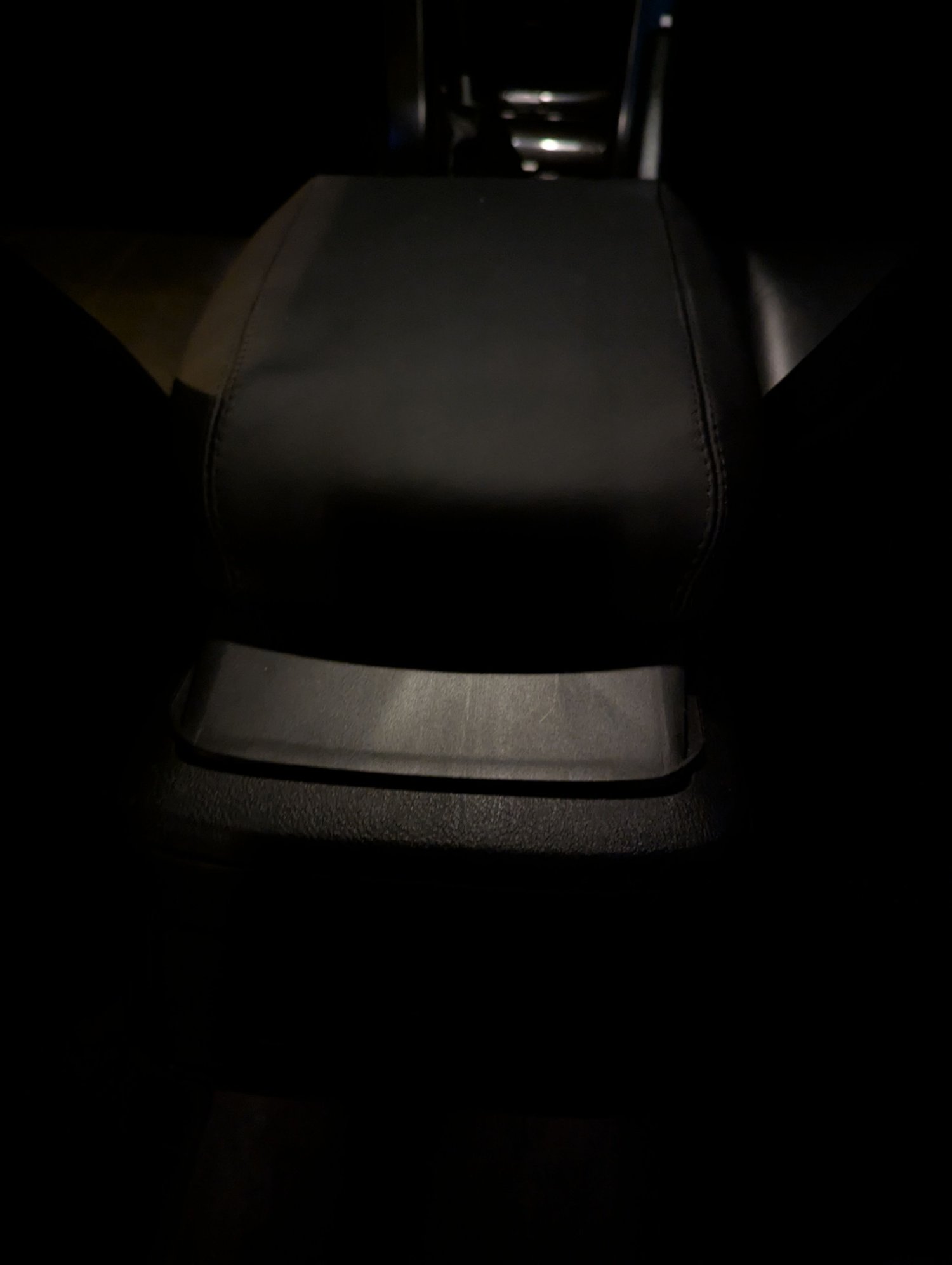

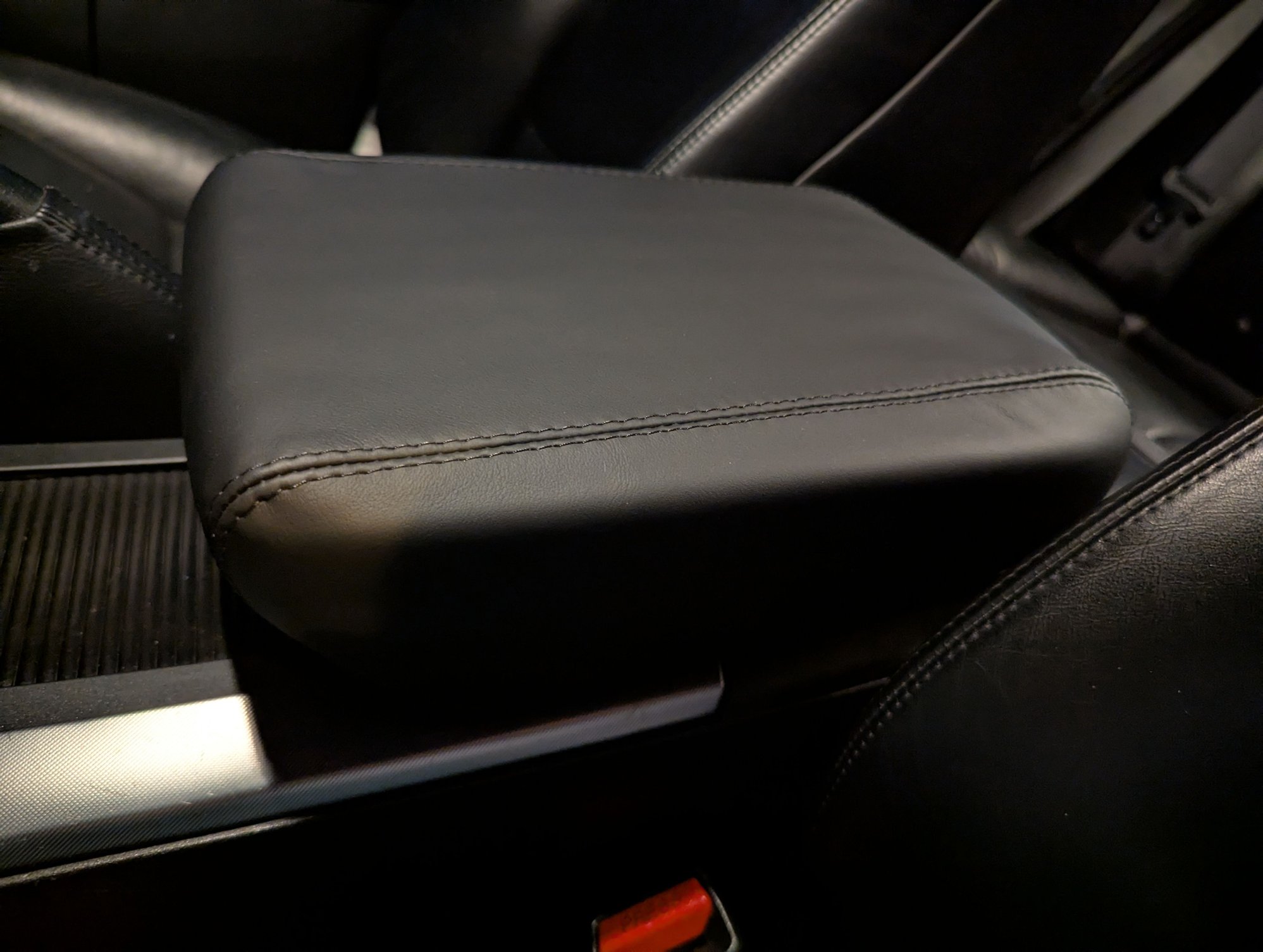

For anyone curious about how my (2nd) armrest surgery with stiffer / denser foam turned out, I actually ended up returning the STV Customs cover as it was the same size as stock and wouldn't fit over the thicker padding.
This led to me looking into the Redlinegoods cover, and lo and behold they actually sell an oversized one for my specific use case, and I opted for the Nappa leather option which truly feels heavenly compared to the stock and STV Customs pleather. Now my armrest looks & feels like it came out of a luxury car 10-20 years newer (minus the squeaks / creaks from the flimsy plastic underneath), giving me yet another reason to keep driving it til the wheels fall off
So for anyone wanting to use thicker + denser padding underneath, Redlinegoods is likely the only choice...and a great one at that, as their customer service was also super helpful with the barrage of questions I had from start to finish. Obligatory pics:
