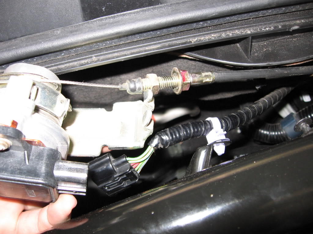

OK, I got my new APP sensor today and the install was as easy as I expected. The only difficulty was with the bracket. I couldn't get the whole assembly out between the firewall and the strut brace. No big deal, though. Only two bolts hold the sensor to the bracket. Turn the bracket over after removing the bolts that hold it on. Then remove the two bolts holding the sensor on and the pieces will come out individually.
This is the sensor before and after replacement.

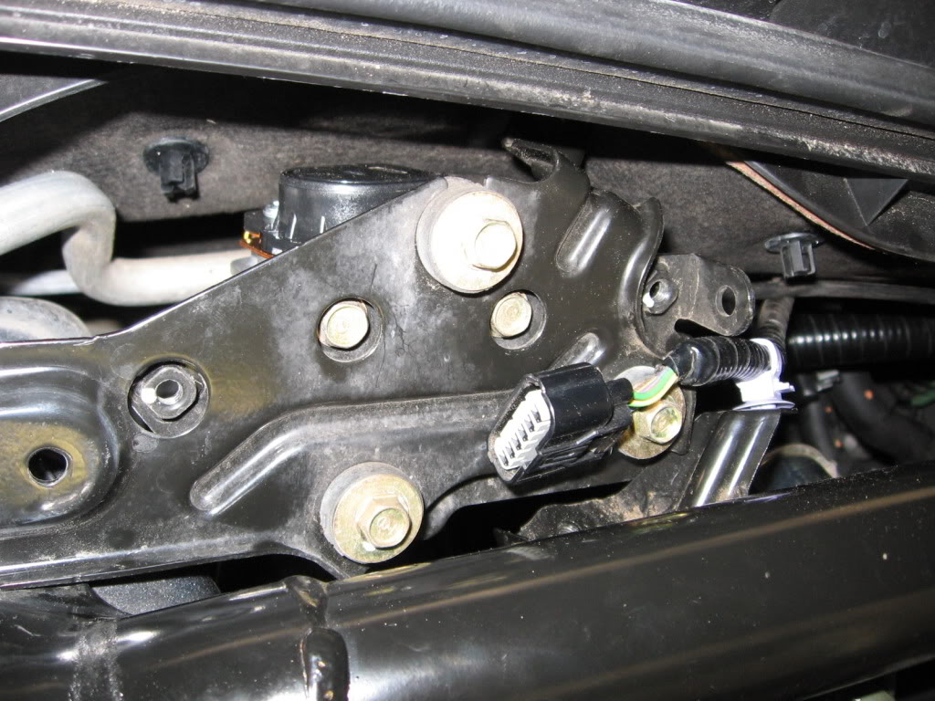

Flip the sensor assembly over and remove the two 10mm bolts (the recessed ones) that hold the sensor to the bracket.

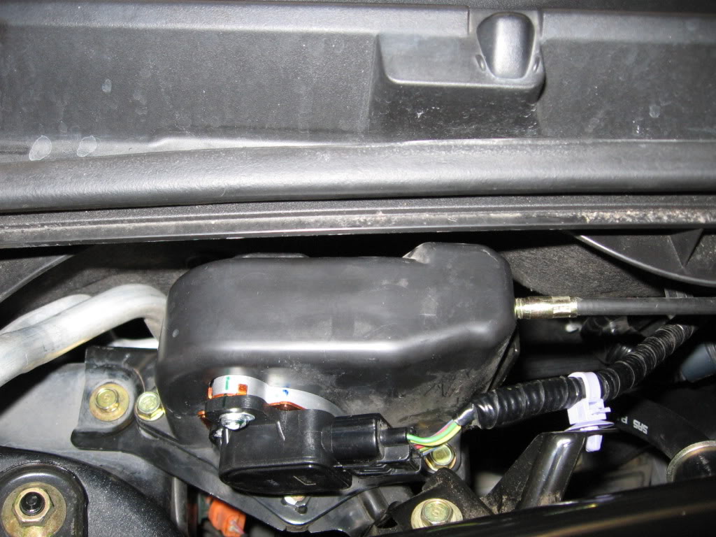

Loosen the nut holding the cable to the APP sensor. I adjusted the jam nut after I installed mine, so I wasn't worried about where the nuts were.

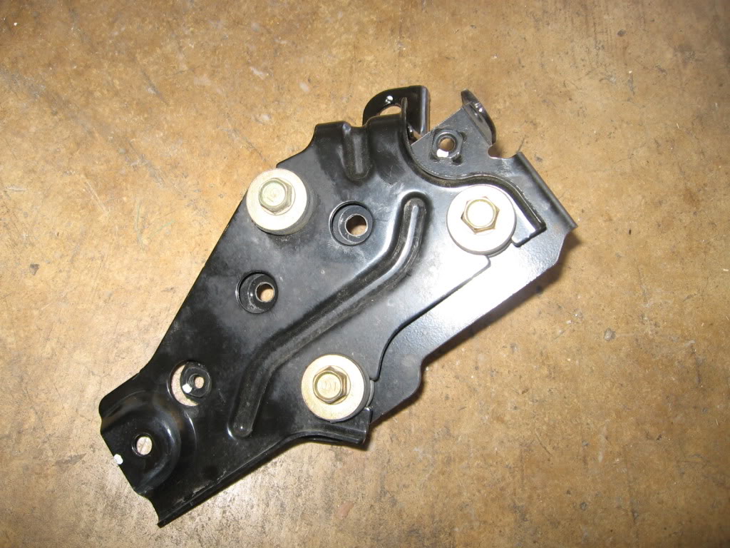

And this is the bracket after removal. Just set it aside after removing the sensor from it.
Place the bracket back behind the strut brace and bolt the sensor back on. Then bolt the whole assembly to the brace and firewall. I adjusted the slack out of the cable and tightened the jam nut.
Attachment 54585
Attachment 54586
Attachment 54587
Attachment 54588
