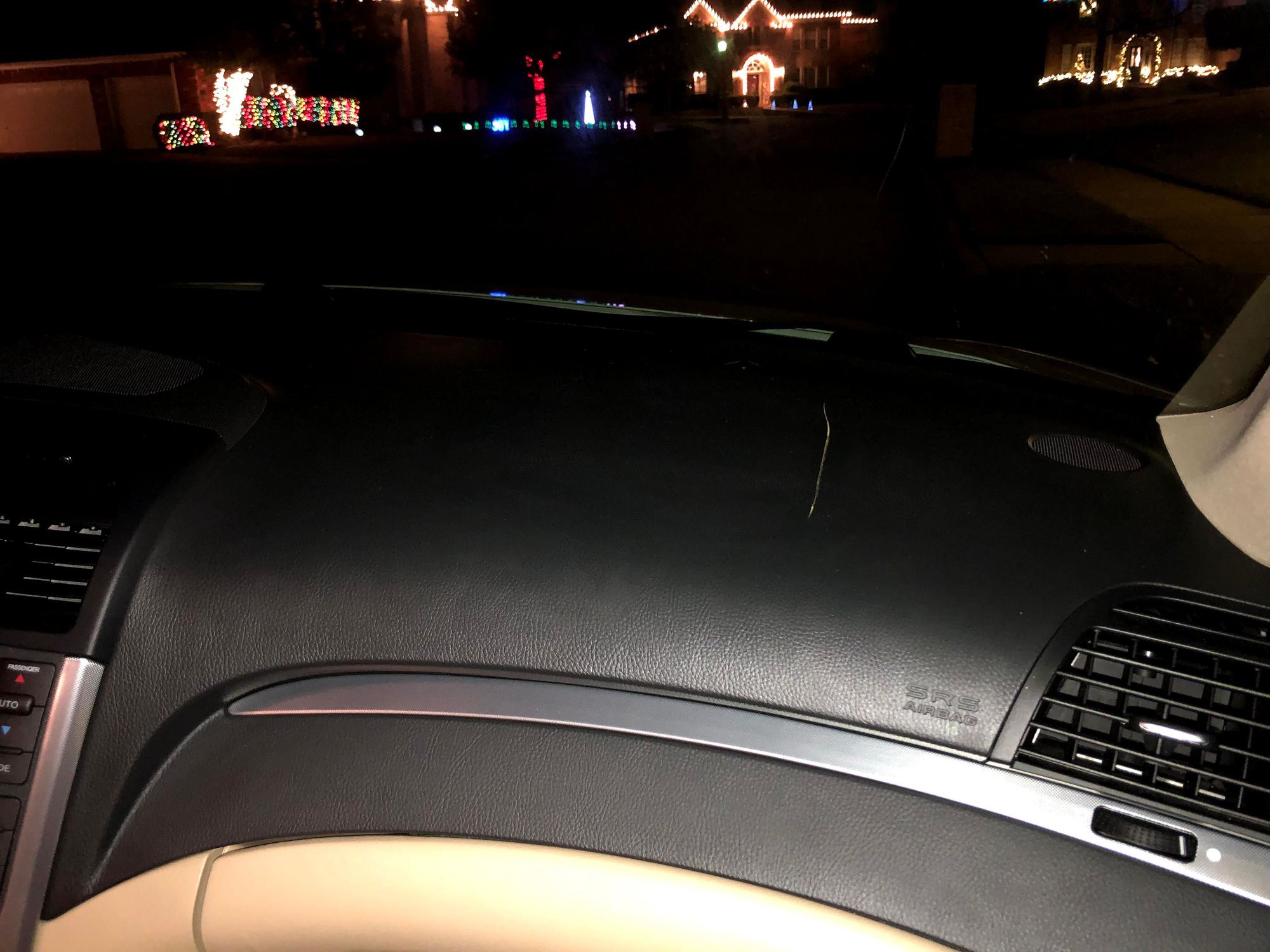

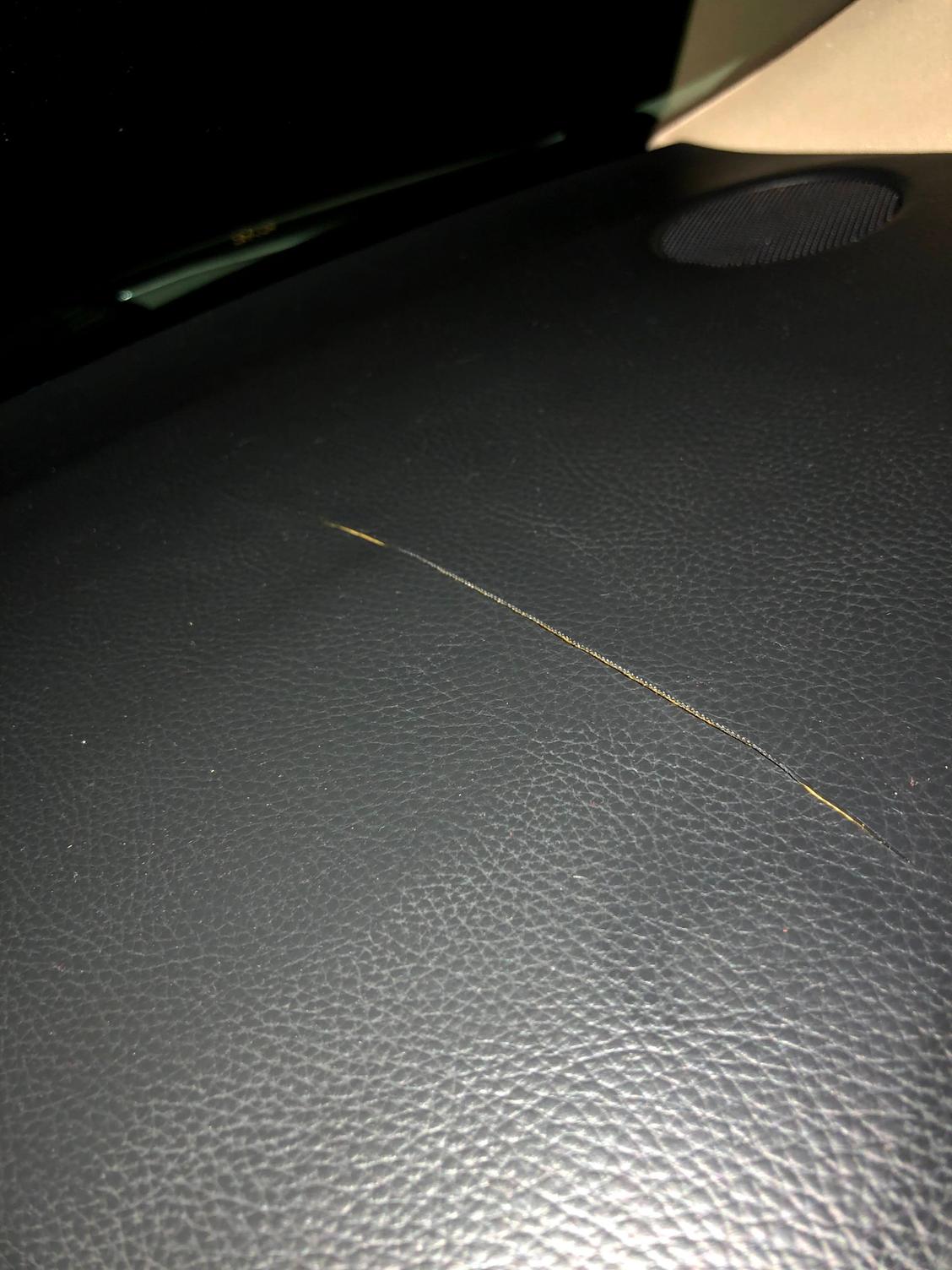

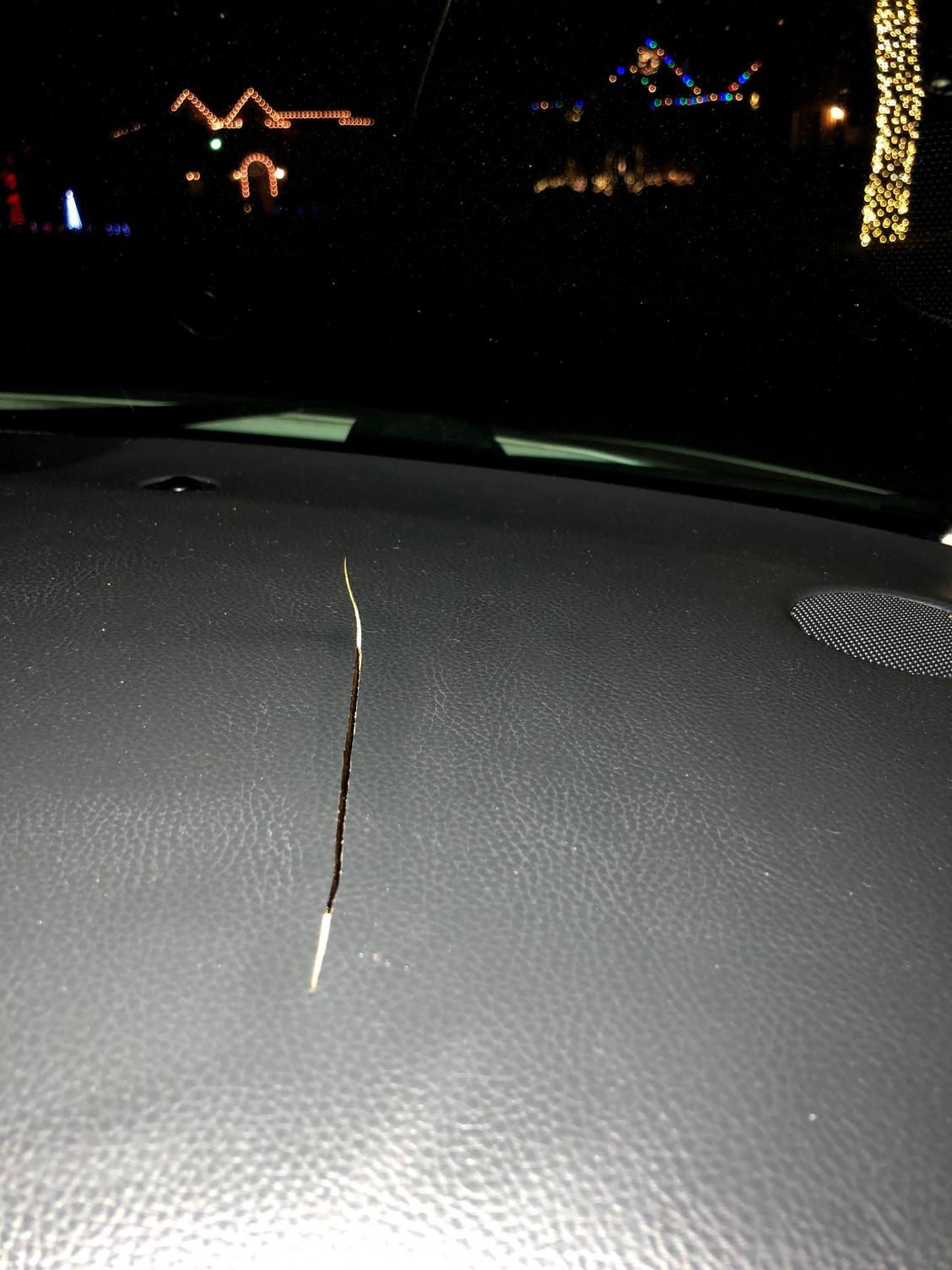

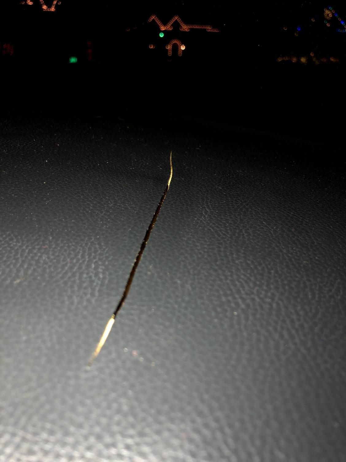

I got my 2008 Acura TL over the summer and have taken good care of it since getting it. When I moved home from school right around thanksgiving I noticed a split in my passenger side dash. I was surprised since their was no spits, cracks or fading before. Also I didn't do anything to cause it like cut it, or put pressure on it. I have cleaned the dash regularly and also use Armor All Original Protectant after cleaning, and I put a liberal amount on their. Now the split is starting to get more noticeable and I am wondering if anyone has any recommendations on how to fix it, stop it from getting worse, or covering it up. Any information is greatly appreciated. Also let me know if you had a similar issue and how you fixed it. Do '08 TLs have common issues with the dash splitting?

Common problem. Live with it, cover it or replace with another dash.
Old Dec 4, 2020 | 07:58 PM
gatrhumpy's Avatar
Chapter Leader
(Northeast Florida)
Posts: 35,532
Likes: 1,654
Armour All contains silicone, which dried out your dash. Don't put that on there again. However, these dashes, all dashes, new and replacement, will eventually crack. It's a combination of heat, cold, materials, weather, location, cleaning materials used, etc. It eventually happens to all these dashes. Recommend either a good quality carpet dash, complete dash replacement, or a dash cap like Coverlay.

Thanks for letting me know about the Armor All, I will stop using it. Definitely going to glue up the crack so it doesn't get worse and try to fill it in best I can. I will look into getting a dash cap/cover.

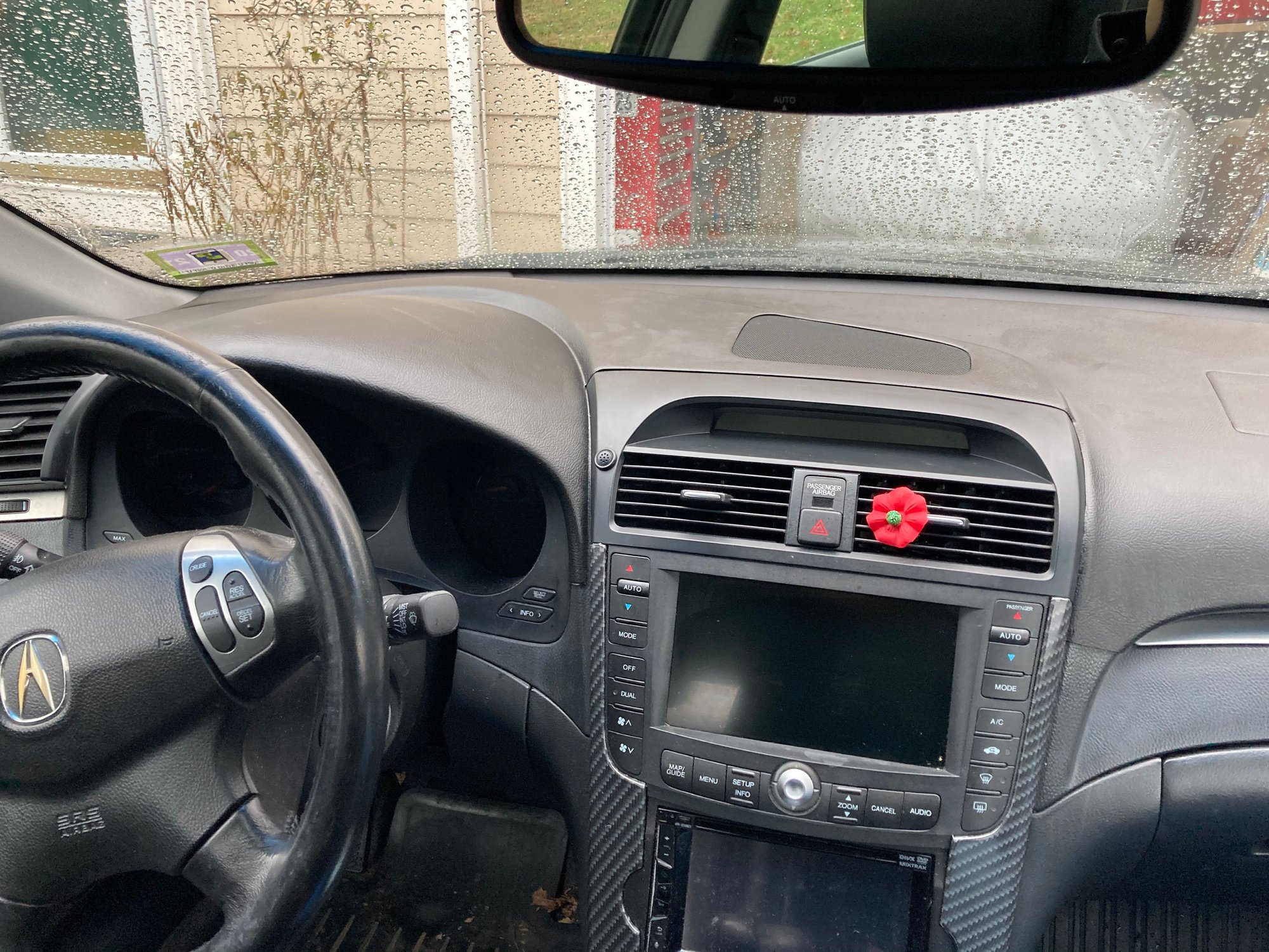

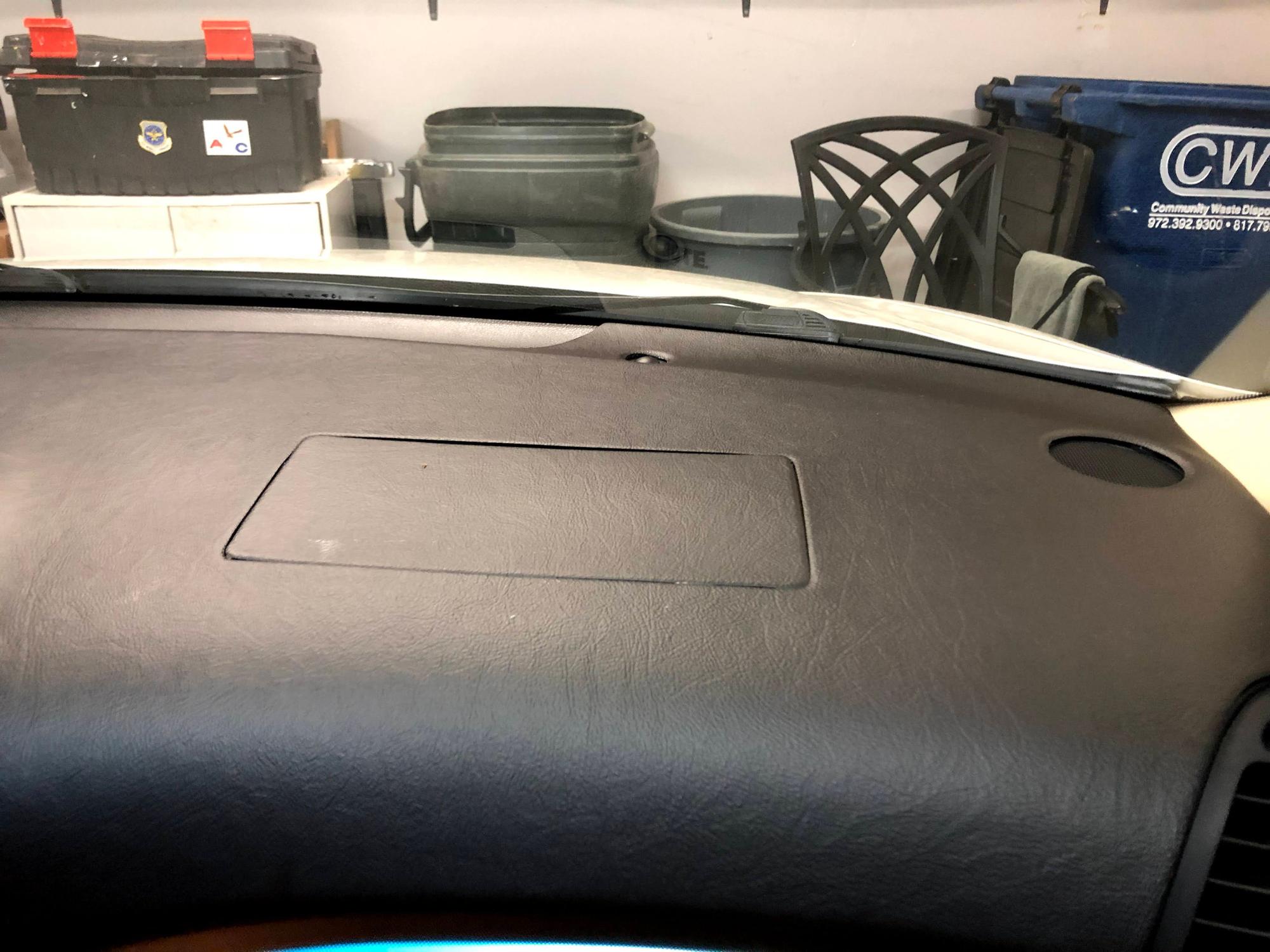

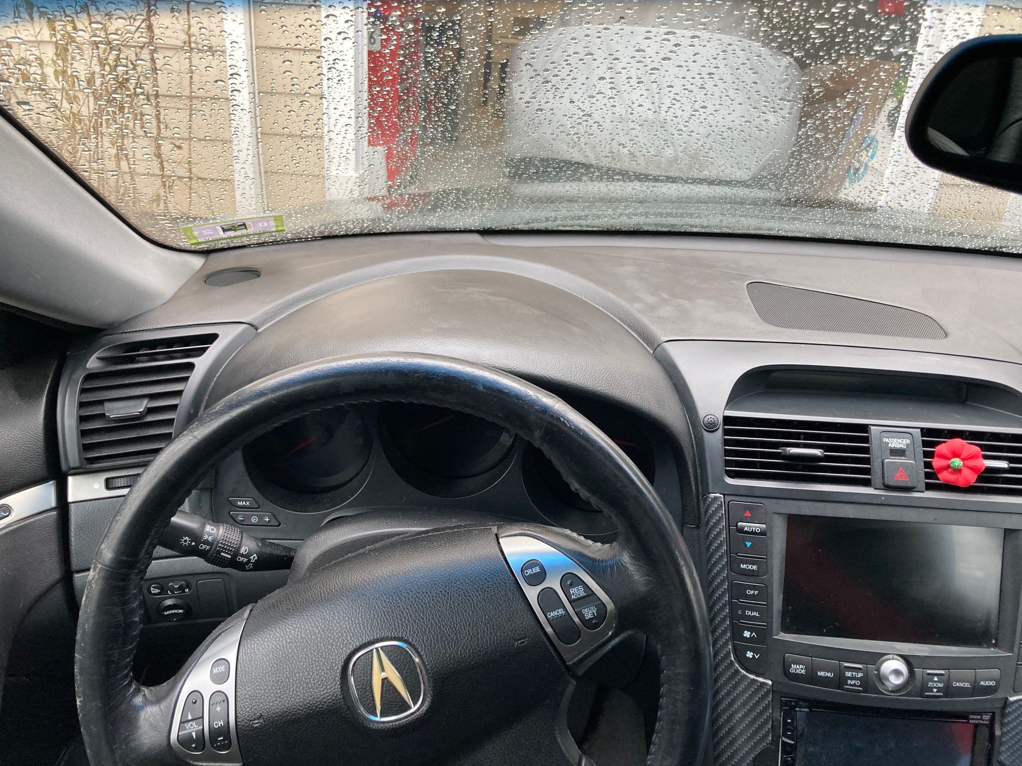

From: Sacramento, CA

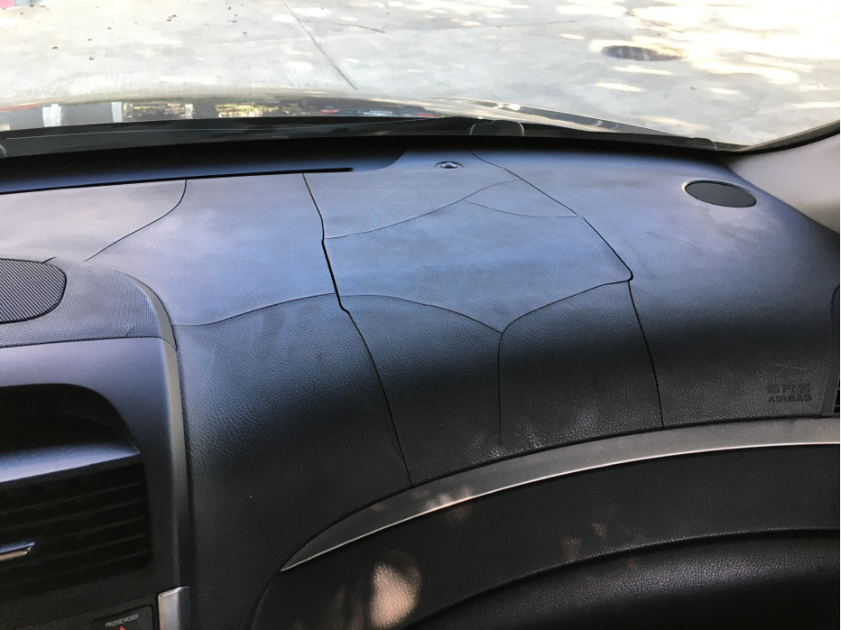

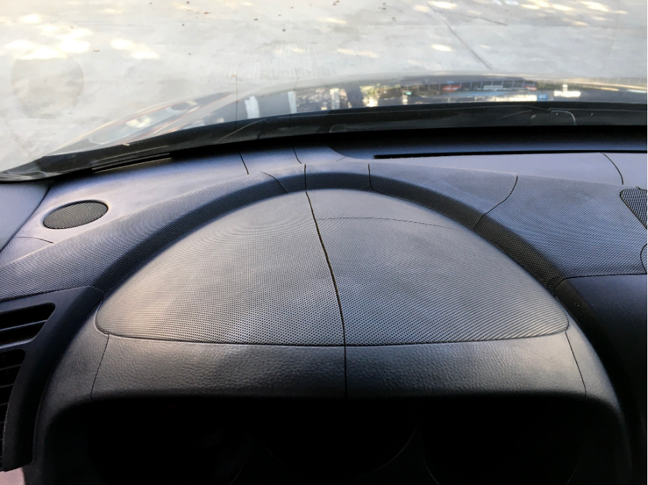

i got my 2005 base TL in october and this was the condition of the dash:
i installed a COVERLAY dash cap and now it looks like this:
i'm very satisfied with the results and highly recommend Coverlay!

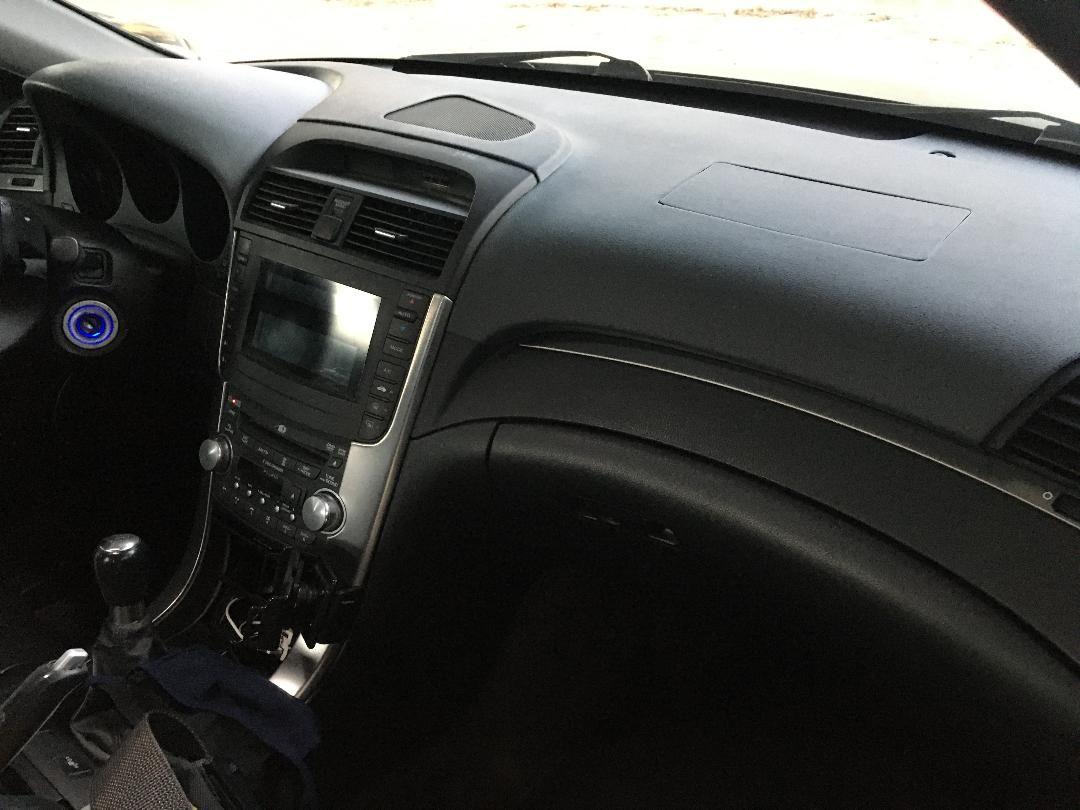

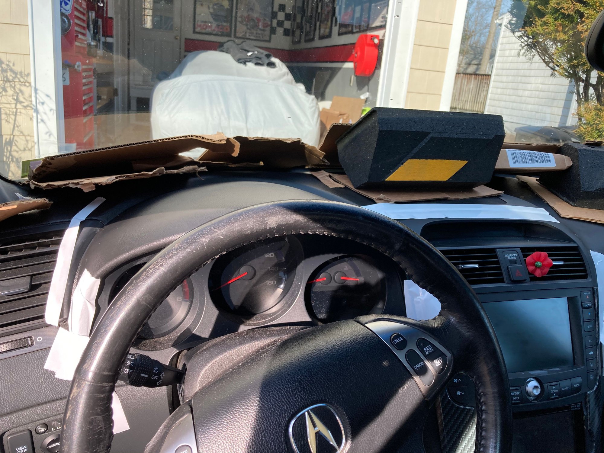

Went the cover lay route yesterday. I had three cracks that started about 6 months ago. 2005 with 230k on the clock
easy install and it looks 99% better. not pebble beach but way better than a carpet type cover. Don’t think anyone would know it’s a cover. Cleaned everything with alcohol a few times with a scotch pad. Wiped it clean. I used the provided silicone sealant. Holding well.

Looks much better! What were the black things in picture with all the cardboard (I think weights of some kind?). Good idea using cardboard on edges of windshield to keep the adhesive holding that part. I’m thinking of getting one of these cover lays...
Old Dec 15, 2020 | 08:01 AM
BillMFD3's Avatar
Joined: Jan 2009
Posts: 158
Likes: 66
From: NYC or Laguna Beach
Cover lay recommend the cardboard. The black things are roof isolator mounts for conduit runs. They work great as wheel chocks too.
I would have put the car in the garage to work but “baby” is under the cover hibernating until spring 🏎
