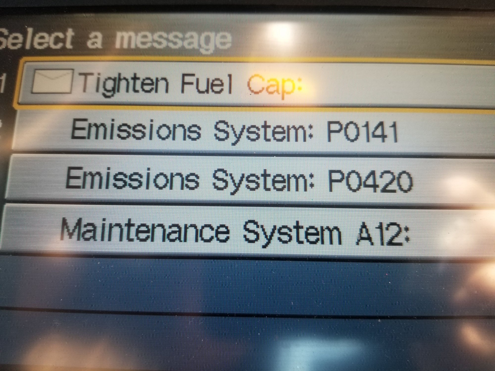

There's 2 relays underneath that cover, one for DRL's (if equipped) and one fan control relay. Sounds like one of them is constantly clicking on/off, probably killing your battery.
Which is unrelated to your CEL's pertaining to 02 and cat converter.

Thank you! Yup taking care of the codes today.
