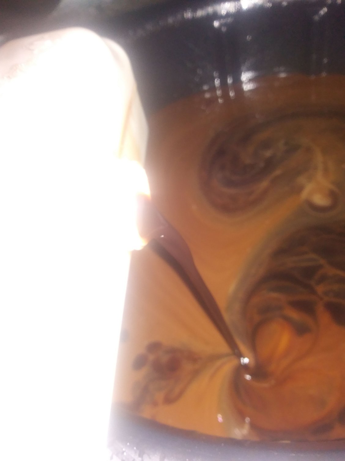

Hey guys,
Took my TL 08 (160,000 mi) to Drive in AutoSound today to get a window tint. After agreeing to get a $230 job, dropped vehicle off and headed home. 20 minutes later I received a call recommending a felt lining for windows for additional $250, I said no. Another 10 mins later they called me saying that my vehicle was leaking fluids and I need to come take a look. When I got back to the store, my vehcial was in the garage with my fluids all over their shop floor. My hood was also up, and my reservoir cap was unscrewed.
There were a lot of fluid on the floor, and it looked like oil/coolant/transmission mixed together. My Coolant reservoir tank was filled with dark purple/ blackish goop (almost as if it was filled with a quart of oil). I started the vehical and fluids starting spilling all over their floor. I used their hydrolic jack to lift the car, pooped the plastic protector off the front underside of the vehical, started the engine, no visable leaks, until the fan kicked in, then everything started coming out the top of radiator reservoir cap rapidly.
Drove home, automatic transmission was barely grabbing gears, drained radiator (oily-trany fluid came out), filled back up with 50/50, started, same thing, same goop pumped out of the reservoir cap again. Checked trans fluid, dry as a bone (and I topped trans fluid off less than 7 days ago).
I do my own maintance on vehcial, check oil & trans fluid regularly, and the vehicle has been operating perfectly fine, and was fine when I dropped it off. All this suddenly came about in the 20 feet they pulled the car into their garage, after I had left. Besides flushing the system multiple times, do you think I need to replace the Radiator? And, have any of you encountered anything like this before?
when i came back to shop
coolant shouldnt look like this
Looks like oil
Fluids other than coolant at high speeds coming out of cap
leaking again after draining radiator and replacing with 50/50 mix
Draining radiator

Looks like your radiator failed internally. ATF lines run through the bottom of the radiator. I've heard of it failing and causing coolant/ATF to mix.

+1 on everyone. Radiator is bad. Get a new one (Denso) from Amazon. 2 gallons of Honda Type 2 blue coolant. I'd also get a couple bottles of universal ATF to flush out the transmission to try and get out as much of the coolant as possible and then finally replace it with Honda DW-1 . Pop open both fill and drain bolts and pour it through. The universal ATF is just to cut costs on using just DW-1 the whole flush process. Alternatively, you can just go get it flushed professionally somewhere
