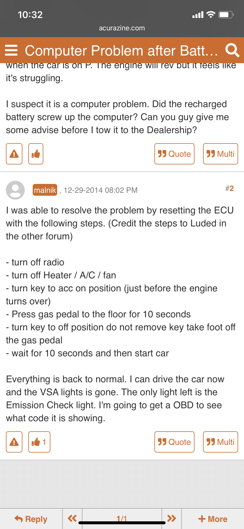

I seen on another forum that someone reset the ECU (pics below) and I did that and the cel disappeared and so far has the"limp mode." do you still think I should still replace the app sensor, etc?

Not unless it comes back, if it doesnt fix it (it should) you can always return the part.

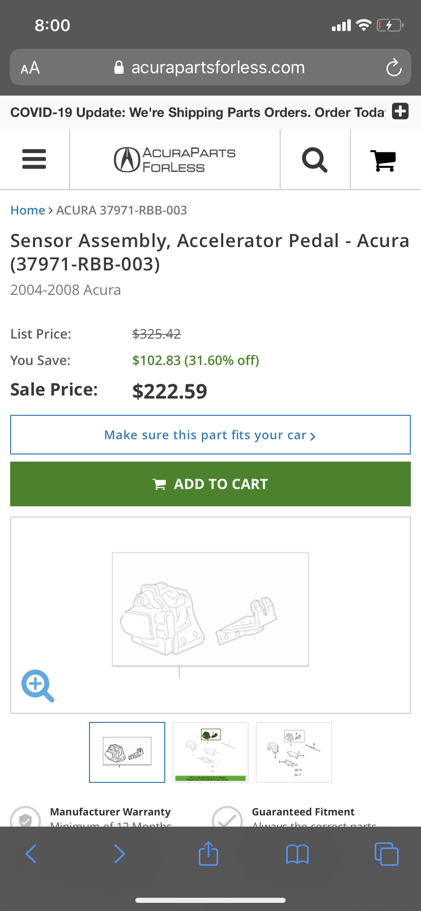

part recommendation...
do y'all think this would be bad part if I got it from eBay? I'm only 16 I can't afford tooooooo much and right now I'm looking at having to replace either the app sensor or the throttle body. my car is going into limp mode and idling funny. the cel throws codes p2176 and p2101 but everyone is saying just replace the app sensor before replacing the throttle body. what should I do? think this part is worth it??

APP Sensor
where can I find a RELIABLE, CHEAP accelerator pedal sensor ???
Old May 2, 2020 | 07:08 PM
GhostTL09's Avatar
Joined: Mar 2014
Posts: 2,173
Likes: 864
From: Georgia
Junk yard.
I
I bought cheap off ebay and was crap. I hit up a pick n pull yard. $20

With non-OEM sensors you often end up paying twice.
In your case, what if new sensor will end up not working correctly, and then you will throw throttle body at the car, and it will still run bad?
Overall it's your decision but I wouldn't recommend getting cheap ebay parts

As for you posts about getting parts off of eBay. Your guess is as good as ours. As others have already suggested, you may be better served by going to a local junkyard and picking up a used one. I have absolutely zero faith in buying stuff off of eBay. I barely have faith in buying car parts off of Amazon. I usually buy from Rock Auto, one of the Acura dealers on here, or when I can't wait I hit up my local Honda dealer or generic auto parts stores.
