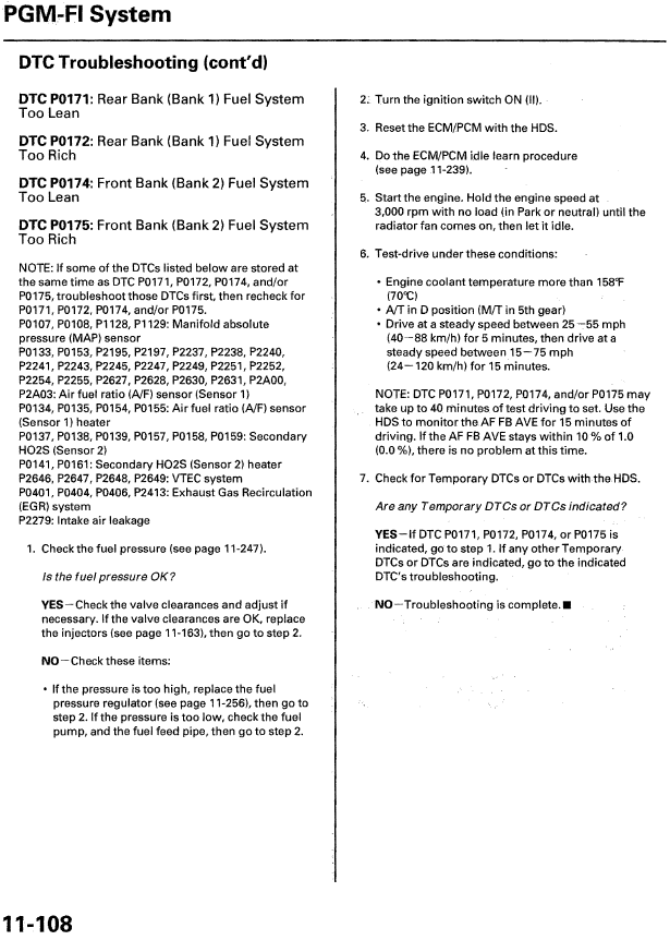

Here's the service manual scan for P0174, if you need it.

adjust the valves first then replace the injectors if that doesn't work but valve adjustment has fixed it 99% of the time.
