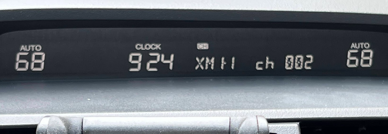

Hello - I have a minor issue with my 2005 TL that is driving me NUTS: the clock above the factory navigation screen is NOT accurate by several hours. I tried looking for ways to set it in the navigation menus but I the menu options refuse to adjust the time. Whenever I disconnect my car battery (which I just did to replace the battery), the clock resets to 1PM. My strategy to fix this might seem simple: which FUSE under the steering wheel powers the clock? What I would like to do is disconnect the user until 1PM and then plug it in. Ideally I would do this without disconnecting the battery all together.

FOUND THE FUSE !!!! For those with navigation on the 05 Acura TL the fuse is #7 (which is labeled "backup"). This controls the clock along with navigation, power locks, etc. if you pull the fuse you can always plug it back in at 1:00 to get the clock to reset
