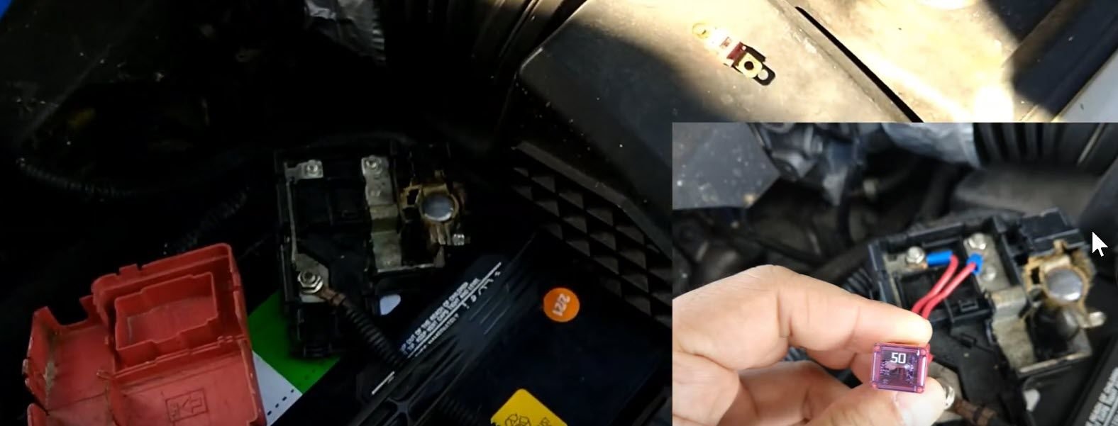

Wanted to catalogue my experience with the 50-amp battery terminal fuse issue with my 2006 RL for posterity. The sequence of events are as follow: Battery died; Jumped the battery and replaced with nearest equivalent at Costco; Battery jump unknowingly blew the 50-amp fuse which connects the radiator fan circuit; Radiator overheated and blew the plastic reservoir cap, leading to coolant loss, resulting in engine overheating condition; ghetto-hacked radiator cap repair and made youtube video; ghetto-hacked further the 50-amp fuse replacement to reanimate radiator fan.
Actual vehicle-relevance of this instance will be more far-fetched with passing time, but the underlying problem will remain with Honda/Acura vehicles until the design is changed. Acura/Honda Engineers should keep fuses with the fuse box and not just install them willy-nilly wherever it's convenient for manufacturing (in this case, under a tacky red plastic cap atop the battery terminals). The cascading effect of a seemingly benign fan malfunction is, ultimately, catastrophic engine failure that renders the vehicle useless. Vehicle reliability is the primary reason why my entire family is on the Honda/Acura platform, don't fudge it up by trying to be cute or lazy. Thanks for reading my blurb.

I replaced that fuse with an inline 50 amp circuit breaker when I upgraded my battery terminals...much more reliable and cheaper than buying a new fuse if it ever blows...which it isn't likely to do since most of that wiring is pretty solid. You likely blew the circuit because you jumped it from the wrong side of the fuse...
