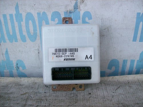

Climate Control Unit is part # 79610-SEP-A45. It is located behind the glove compartment and is very easy to replace. Remove the glove box, surrounding trim, and panel underneath glove box. You'll see the climate control unit on the left side as you're facing the glove box opening.
Here's what it looks like:
A brand new one retails for about $300 from Acura and usual parts suppliers. I found a used one on Ebay for a fraction of that and so far it works fine.
