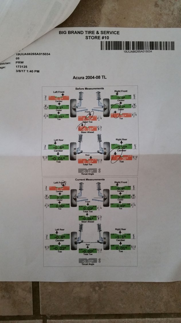

Picture of alignment

Your left front camber is only out of spec by 0.1....
Is something still bent? Maybe, maybe not. I'd probably address the vibration issue first.
Not sure I'd start with replacing the LCA... but as long as you're there, you should have them go ahead and press in some PCI compliance bushings
yeah its not dramatic , but the steering won't line up again it pulls to the right with the vibration. ....and PCI bushing will be good if i hadn't spent over 1k
