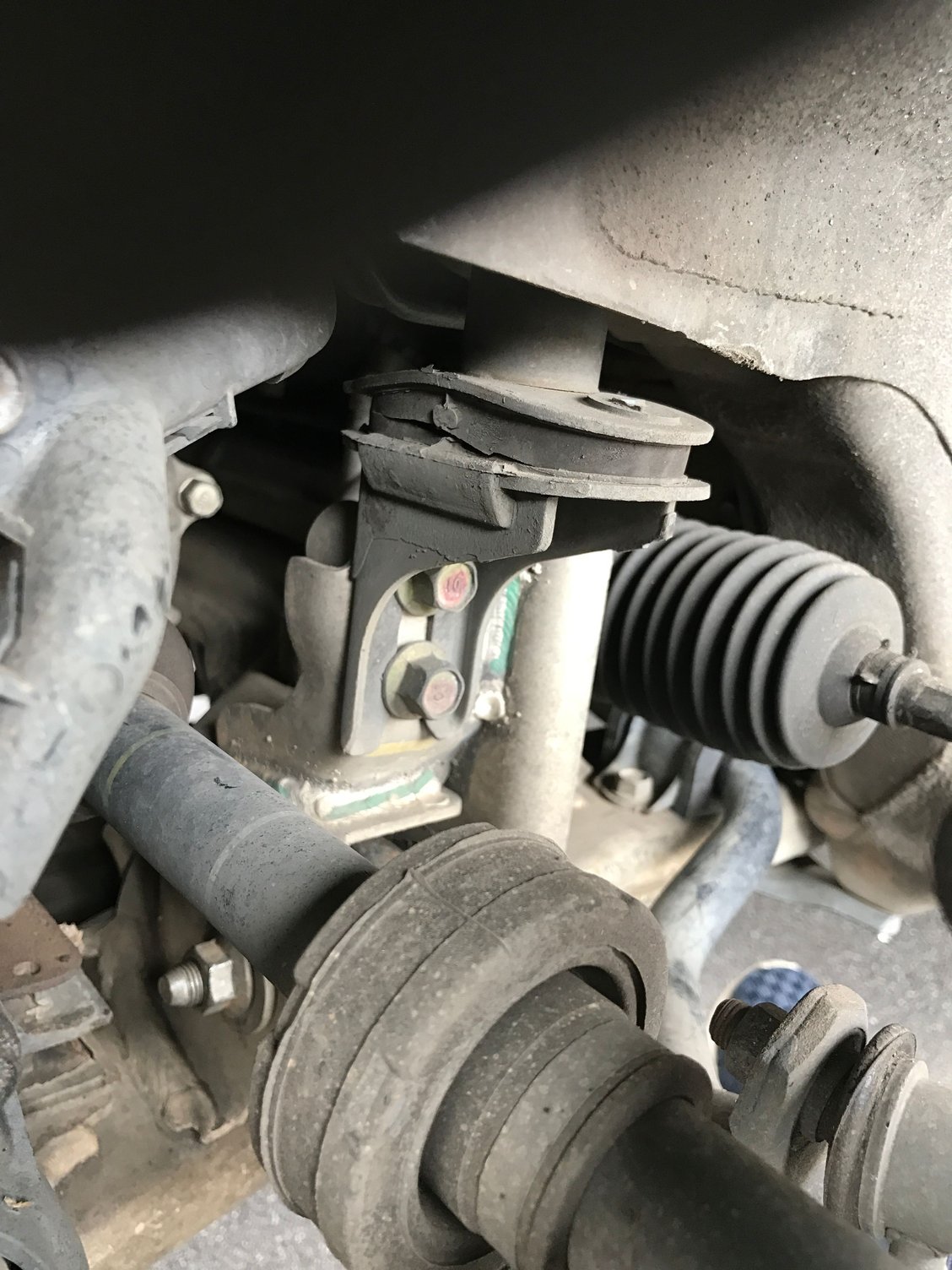

I am fairly sure this is a sub-frame bushing. I am looking for a part number (quickly), so I can place an order tonight and hopefully have some parts for this weekend.
Pictures of part in question:

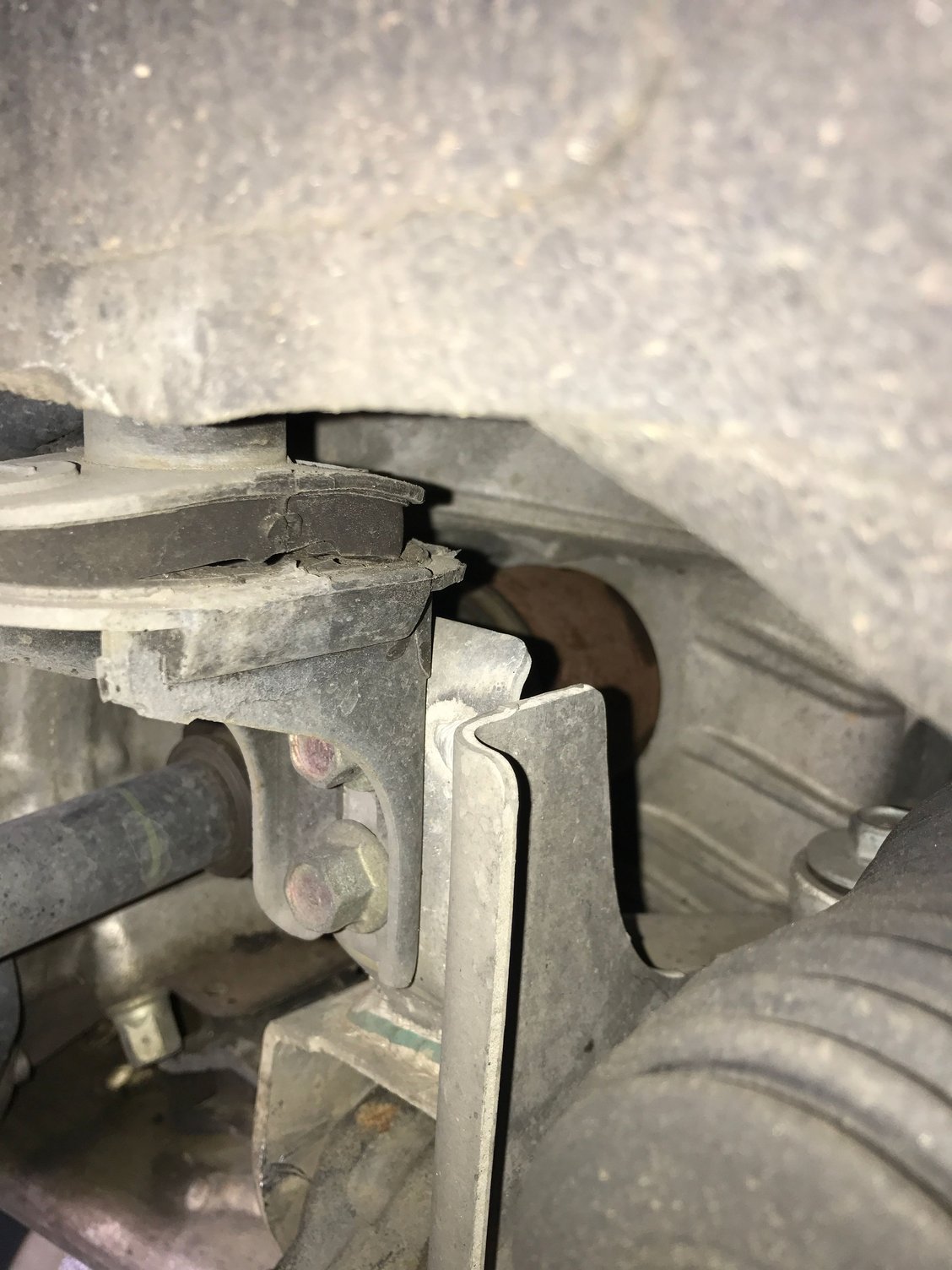

I am a little concerned that the metal part (I think it was metal) on top looks like it has been bent fairly badly. I am wondering if replacing this could be a hassle.
I am thinking this may also be playing some role in my car vibrating a lot at idle.
My main guess is that my rear, lower transmission mount is completely torn in half. I got in with a pry bar and had no issues just moving the transmission around. I am going to order the two lower mounts. While I'm replacing those, I want to look at replacing the part above as well.

50280-SDA-A01 Rubber, R Front Sub-Frame Middle Mounting
50285-SDA-A01 Rubber, L Front Sub-Frame Middle Mounting

Oh man, thanks so much again!
Not sure I would have ever thought to look at the "Front Beam - Rear Beam" section. I don't understand how some of these parts are categorized. All the parts have "sub-frame" in the name, why did they not name the category "Sub-Frame?!"
