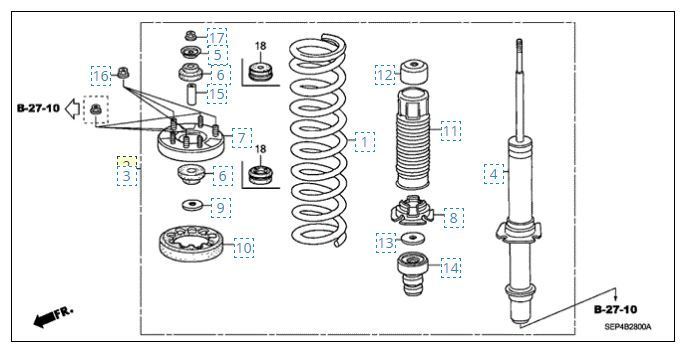

Looking at a diagram of the front strut assembly:
I have the following parts installed:
4 - Shock absorber
1 - Spring
7-Top Hat
10-Rubber Spring Mount
17/5/6/15-Top hat assembly. The rubber bushings around where the strut comes through resemble this.
So...the rubber spring mount (#10), is very soft and pliable, could it need to be replaced? When I pump up and down on the LH forward quarter panel, I can replicate the creaking sound.

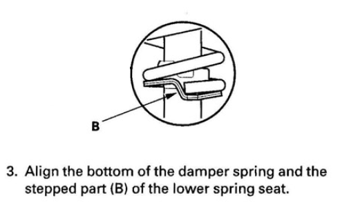

Is the bottom of the spring affixed to the lower rubber mount in the correct orientation?
If I'm understanding your question correctly, I don't have any rubber mount installed on the bottom of the spring. The bottom of the spring contacts the metal flange around the shock.
then that's your problem. If there's no #8 on the spring seat, you'll get some noise.,

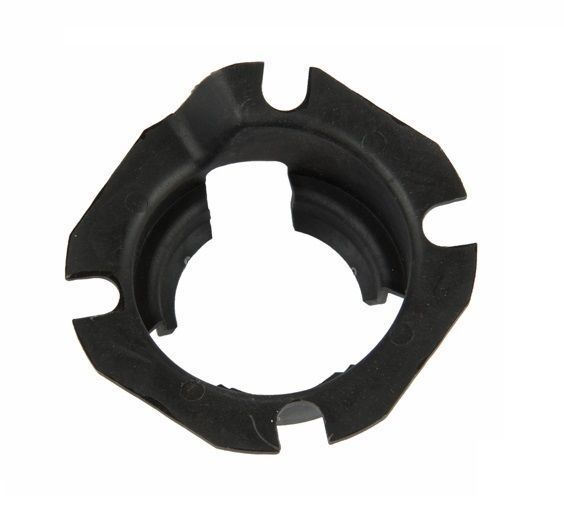

That would probably be the source of the noise. Honda calls it a "lower spring seat" or "Lower Coil Spring Insulator":
and it looks like this(upside down):
Thanks for the information. Guess it's time to order some more parts. Thanks again.
