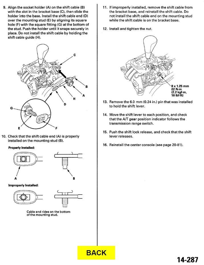

recently i had my interior changed and the car wouldn’t go into drive so i took it apart and found that the shifter was not plugged in. so i plugged it back in and now the car refuses to start. i’ve check for anything unplugged i’ve done the security reset im not too sure what would cause this. codes popping up on dash are 1726 driver rear up switch circuit open. 1140 driver side power window position sensor circuit error, 1108 diagnosis sensor error

updated got it to start by reading some of the thread but now the car is saying neutral is drive any way to fix this?

need to adjust the shift cable:
Originally Posted by peter6
You can do the same test with D. Just move it slightly towards the N, and D should light up.
For adjustment:
https://acurazine.com/forums/3g-tl-p.../#post16101585
