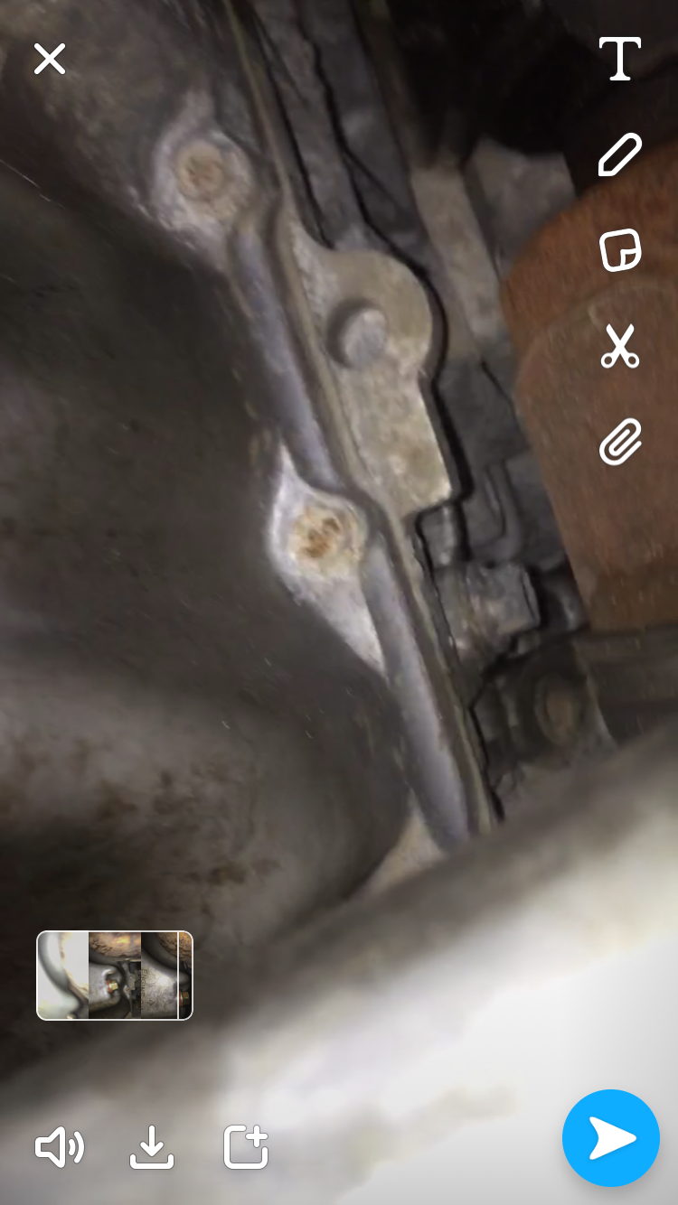

This is taken directly from the leak location and puddle, this is right above the oil drain plug, direct shot.
This is of the oil drain plug shot, this is the only place it is leaking from and the only place a puddle is forming. From my pictures and late night inspection, I feel like it has to be dripping from the drain plug? I Don't see any clear oil leak signs from above.
Every single puddle left on the street or driveway is on the right side and its oil for sure. Maybe the washer is garbage? Re-tighten Plug?

Typical Honda crush washers are silver, not red. Could be a bad washer, could be that the oil pan has been stripped and now you need to replace it.

That washer is suspect. Also no trail from above
