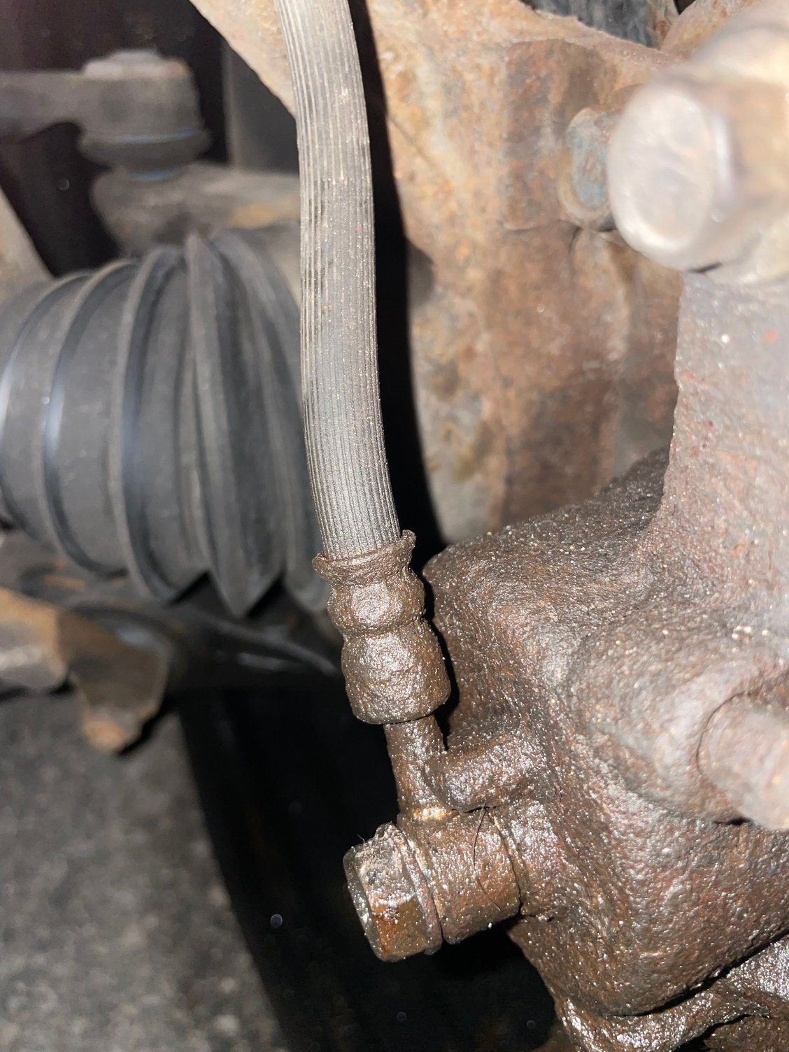

2005 acura TL. I’ve noticed leak spots in my parking lot and found out it was a break line feeding the caliper. Any fix suggestions or link to parts? Thanks
ive tightened this bolt, but idk if it solved the issue
after I tightened it i had someone constantly pushing on the break pedal and I didn’t see any leakage, however there was still some new leak spots coming for the same wheele after I checked on it for a few hours, im not sure if it was just leftover fluids or if it was still leaking, since I didn’t clean it up lol. I might just need to change the flex line and bolt, and links to parts (canada) I would appreciate, thank you
Find the OEM part #'s, for everything you need, on the US vendor link below then perform an online search, on said part #'s, to find the best prices in Canada.

You might just need to replace the copper crush washer...
cleaning it would make identifying where the leak is coming from loads easier

Does that brake hose look like it has a bulge in it??

Update I just tightened it up it didn’t really fully fix it but it stopped about 90% of the leak. I think I just need to change the copper washer like one you guys mentioned, thanks
Be careful tightening the brake line banjo bolt, they are not as strong as a bolt the same size since they're hollow and have side holes to allow the brake fluid to go to the caliper.
I don't remember but the torque value is not high (IIRC ~15ftlb)
I also found power steering leak, ill post a new thread about it if you guys are interested in helping me out, thanks again
The washer is #26
https://dreamshop.honda.com/s/catego...g0000004HomGAE
Honda part number 46472-568-000
