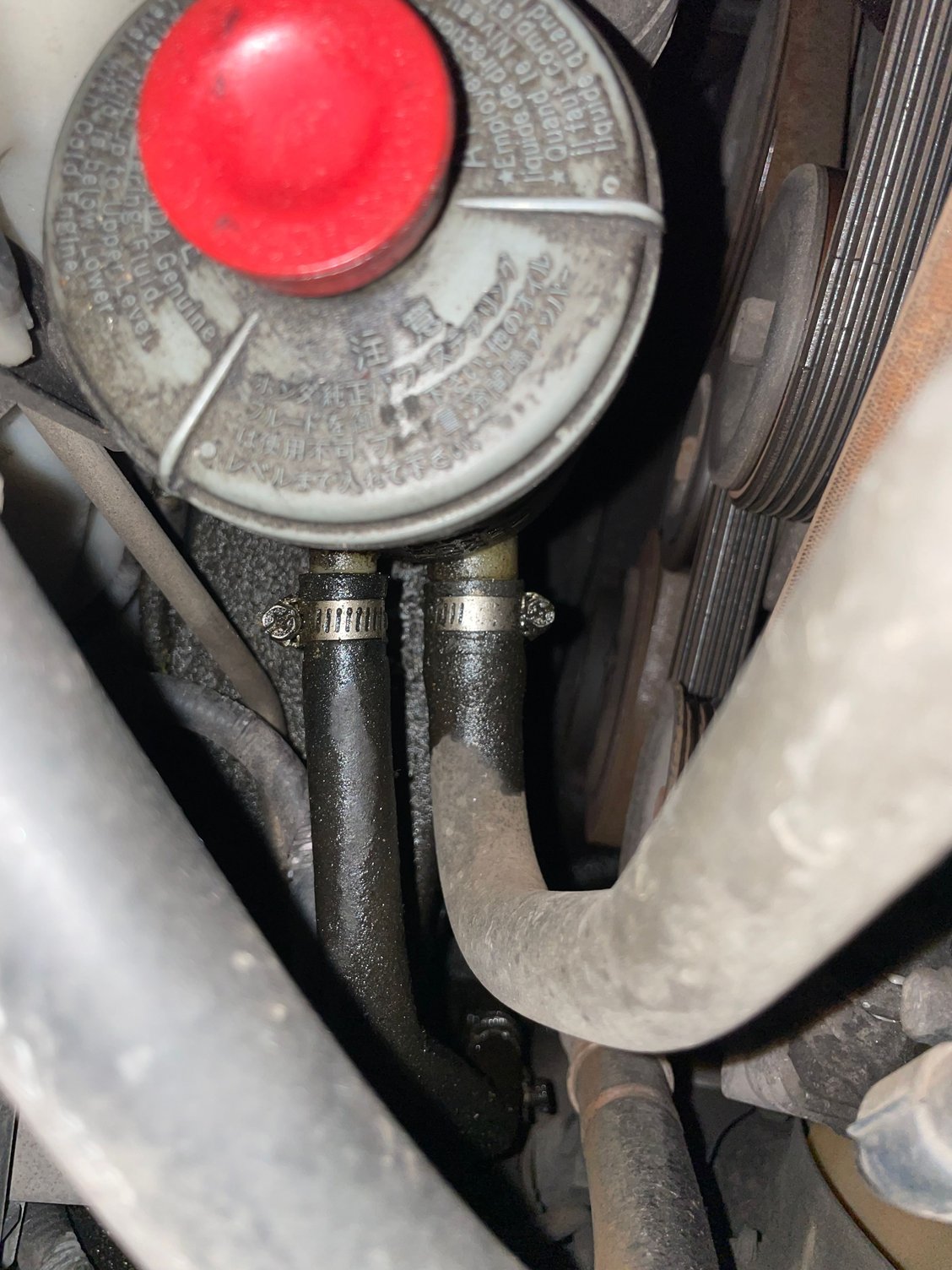

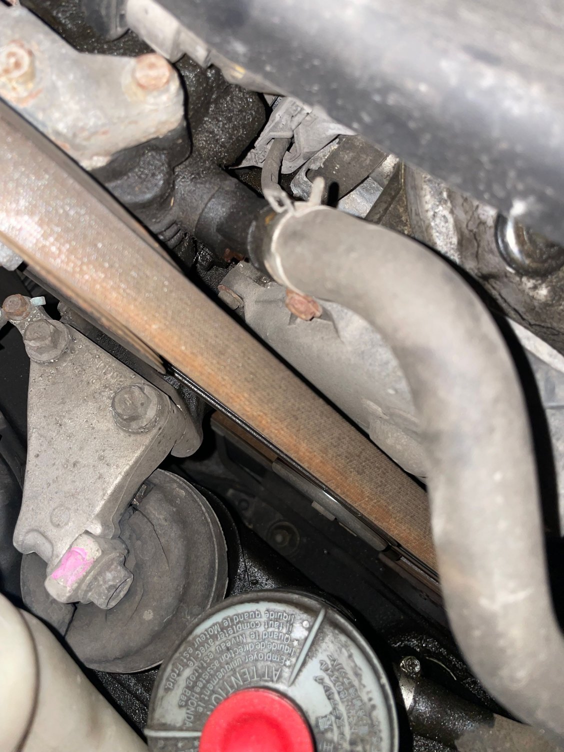

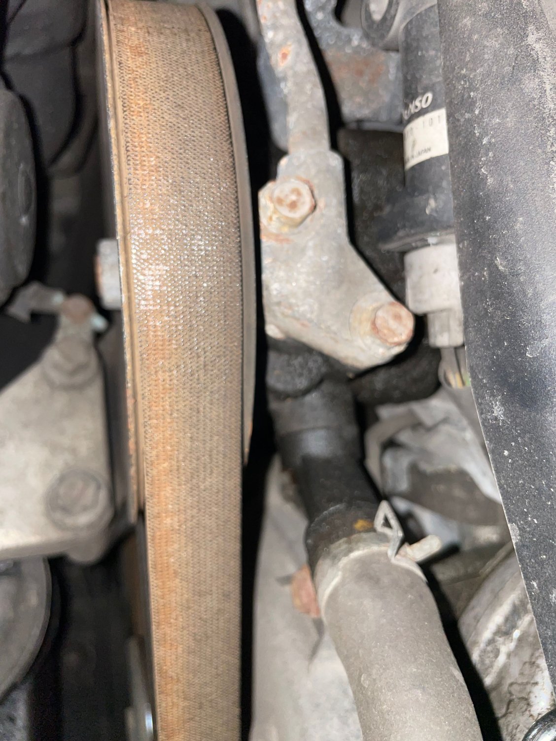

Hey guys, found leaks in my power steering both in the pump and reservoir. Im not sure how bad the leak is. I was just planning on keeping the fluid topped off ; is that a good idea? I got this tl more than a year ago I topped off the fluid at the max level about 8 months ago, and as of now it’s reaching close to the lower level. I have 230k kms on it (155k miles). Thanks

About one of the easiest DIY jobs on this car. Do a search for "power steering o-rings"
