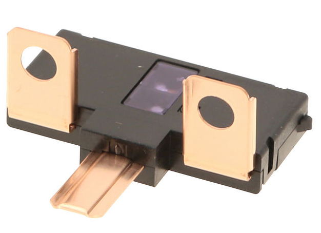

Fix for no power but horn blows & brake light works after battery installed backwards
Originally Posted by riveraj33
I know im a bone head. it was late at night i was in a hurry and i installed my battery backwards. Positive to negative and negative to positive. When i installed it that way i heard a weird humming noise coming from around the engine....It was soo late i thought the new battery was charging and left it there for like 5 or 10 minutes. i put the battery the correct way And now power does not work at all. The horn works but thats it. I took the battery to autozone to test it and it is fully charged still.
I am in desperate need of help. I just has a baby and I am soo short on money. How can i resolve this problem? Please help! Thanks
Solution......... the 120/70 fuse inside the fuse box under the hood. You have to unscrew fuse in order to remove it. Relace this fuse and your issue will be resolved. The fuse cost $10 @ advance auto or you can find it at the dealer.

acura tsx 2012 battery installed backward
i went through the posts and found that not all acura models react the same way. Just in case some one does as i did with my acura tsx 2012, here are the incidents and solutions that i went through.
incident: installed battery backwards; side lights went off and the ecu started whining till i disconnected the battery as i discovered that it was hooked up wrong.
fuse : its a dual fuse that has 100amp/40 amp (specific to this model) was burnt.. not really visible as it was a slight break
location: fuse box next to the engine/air filter
100/40 amp fuse acura tsx 2012
action: 8mm socket wrench was used to take off the two flat hex head screws(do not use screw drivers) and was replaced
this specific fuse was not readily available at the dealership so had to be ordered, not sold by autozone/oreilys
Good luck.. do not panic.

Same shyt happen to me but I was working on my car and put a long wrench on top of the battery, slightly making contact w the positive and negative🤦🏽‍♂️😂 All I heard was sparks scared the living shyt out of me... Blew a fuse like a dumb ass easy fix tho.
https://www.partsgeek.com/83lwsx4-ac...erm=Acura+Fuse

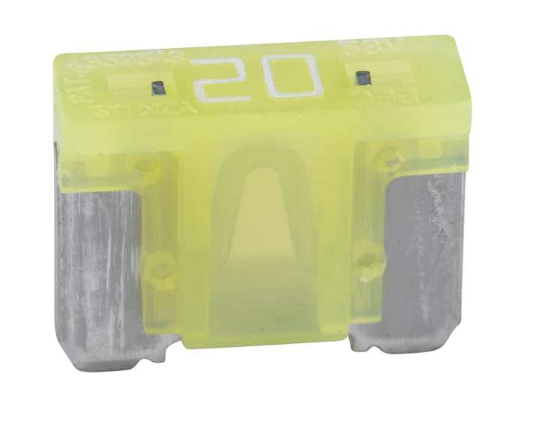

Second problem: radio turns on but no sound from the speaker
Scenario:
so after getting the car running, had to call the dealership to unlock the radio/navigation through the codes: (easy fix : self done, no charge)
but there was no sound through the speakers while the radio turns on and connects to the bluetooth and what else what not..
Kudos to the engineer who designed the electronic circuit in the ACURA TSX 2012 ;
There are three fuses in the vehicle regarding the stereo system, 2 for the radio and 1 for the stock amp
radio fuses are in the fuse boxes one in the hood, the other below the steering wheel and fuse for the ample is in the third box/spot below the passenger dash section, more towards the door.
The cap to this third section how ever is a slider that pops in and out as we slide it towards the seat.
Given that there was no sound but the radio was working, it must be the third fuse below the passenger dash or could be the wiring from the radio to the speakers/amp
in my case it was just the 20 amp mini fuse located in slot 15 in the above mentioned third fuse box.
20 amp mini fuse for the stereo amp location 15
used a plier to take it off and put a fresh one back in.
It worked well thereforth.
I hope this helped people with the similar problem.
