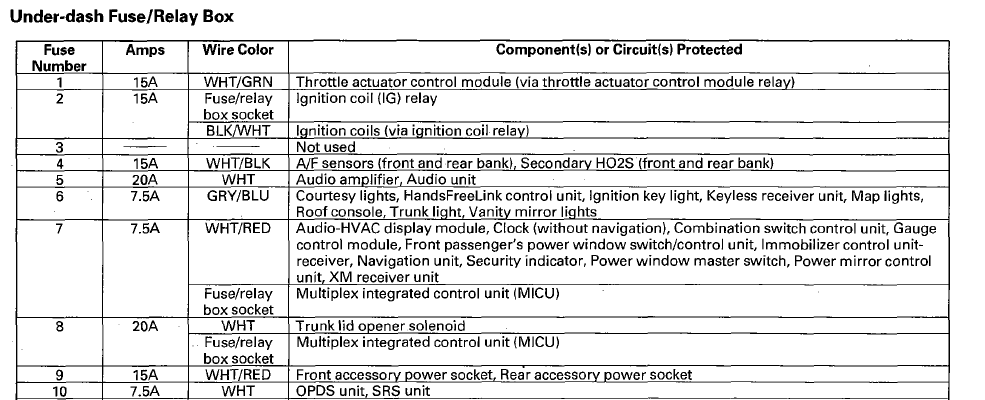

i just checked, it's actually fuse #6 under dash. If I plug the fuse back in, I'd have to go through each component and try unplugging to find it? Is there a faster way to do it with a multimeter? I understand voltage, current and resistance, just need some guidance on how to trace it down.

Cycling on/off is normal. The current should settle down to ~0.05 Amps
The No. 6 fuse controls most of the interior lights so you can put the car in a dark area to troubleshoot. Close all the doors and trunk. Leave the trunk fold-down access open. Wait until the car modules settle and see if any of the lights remain on
If that doesn't work then you'll need a wiring diagram to locate all the components connected to fuse No. 6. Then you'll need to disconnect one by one until you isolate the cause. Start with the easiest accessible one.

Turns out last year when I checked the bluetooth module, I did it incorrectly. When I check it now after the bluetooth module is disconnected with the same fuse plugged back in, as I connect the multimeter between the negative cable and the battery post, the current immediately goes up to 1.3A as I believe the systems are all powering up into standby mode for about 10 seconds and then drops down to 30 mA after that and stays there for at least 2 minutes, and assuming forever after that, as I held the multimeter there for only two minutes.
