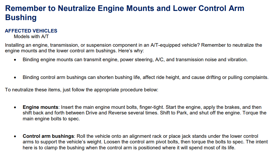

Also make sure to "neutralize" the mounts as well.
How do you do neutralize a mount?

As long as you have an auto anyways.
