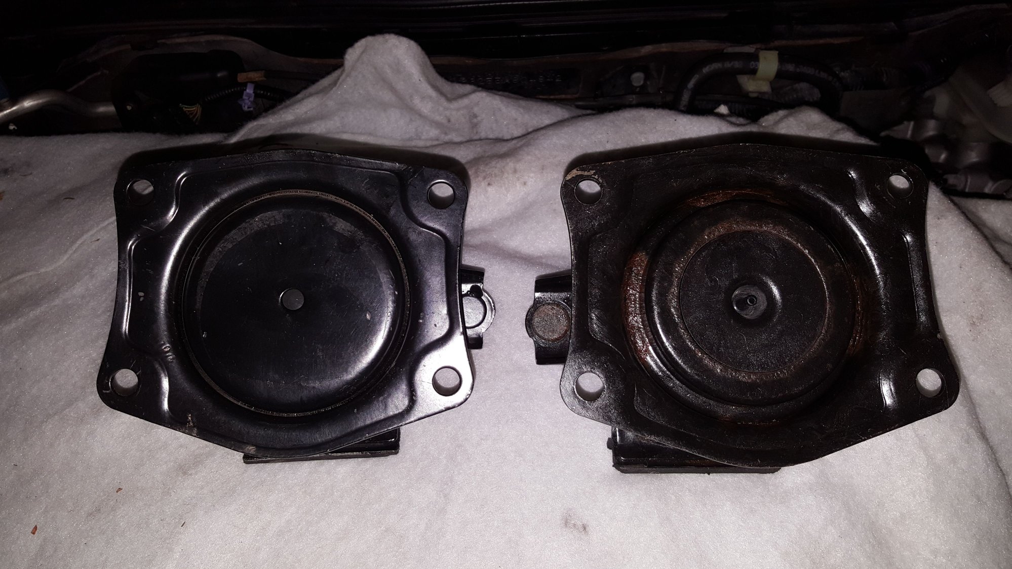

So about 4-5 months ago, i bought a set of 3 mounts from the biggest mount seller on ebay, front, passenger, rear. I did the front and passenger almost the day i got the mounts but because the back was not too bad, and also much harder than the 2 others, i decided to wait a little.
So tonight i decided to do my rear. I took out the old one only to realize my new one is nearly identical, except on the bottom, it has no vacuum line connector. Is this normal? The rest of the mount looks 100% the same. The front mount I got had the vacuum line.
I don't really know what to do. If it's not normal, it's a little late to open a claim since i waited so long. What do you guys think?

The front AND rear is supposed to have the vacuum line. You must have gotten a wrong one. Doesn't hurt to msg the seller.
The manual transmission TL doesn't have vacuum line on the front but rear still has it.

I contacted the seller, he offered me to ship item back for a refund. But that doesnt solve my biggest problem, my car is on jack stands in my garage with no mount, the old one is broken, the new one has no vacuum line. What are the consequences of installing that one without the vacuum line and possibly capping it?
Old Oct 7, 2015 | 01:09 PM
nothing.
cap off the vacuum at the back of the Intake Manifold, close to the firewall.
if you need to, follow the line from where the mount is supposed to go all the way up to the Intake Manifold.
as stated, the aftermarket stiffer mounts from XLR8 DONT USE THE VACUUM lines...
so, every one just caps it off.

if you dont cap it, all that will happen is a hissing noise, which can get annoying

And also from what I understood, the rear mount has much less impact on driving comfort than the 2 others because it's mostly used to absorb shock when shifting in R and back to D, am I right?
Old Oct 7, 2015 | 02:00 PM
when you're ON the gas, the vacuum creates suction to activate the mount to get stiffer.
this would mean that NOT hooking it up will have no effect on comfort, as it's always in a state of non-vacuum.
if your rear mount was torn and beat up, this would mean your other 2 mounts were blown, as the rear is the last to go.
when I changed out mine, my rear was still in great condition.
Old Oct 7, 2015 | 03:24 PM

My rear mount was starting to fail, the other 2, i could detach the top metal bracket completely. This one i couldnt, but it was moving a bit

I agree. The front should have vac line. The rear, from the research I did could go without one, since the biggest stress of rear mount is when shifting or driving in R. I can confirm that i've driven about 500K without a rear vac line and so far so good. The car runs smoother since i replaced rear mount, especially when taking the car in the morning and shifting in reverse, before i'd feel a hit and now it's almost not noticeable. Next maintenance is replacing the 3rd and 4th shift sensors. I had my tranny done last year but i dont think they replaced the switches and the car always gives me a slight bump when driving a low speeds and shifting from 2 to 3 and 3 to 4. I was told the switches look used and not like if they were 1 year old.
