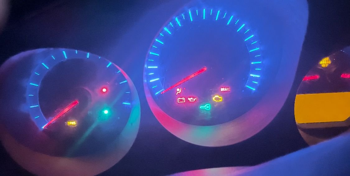

Last night I tried turning on my car and it wouldn’t start. I can turn my key and the lights turn on, on my dash but they flicker really fast and theres a sound coming from the dash area making a struggling type noise. I checked my battery and it’s all good. I just put a new starter in 7 months ago, I’ve been having trouble with my car starting when I put the key in for a while now. If I take my car for an oil change the mechanics always have to ask me to get the car started for them. I have to turn the wheel, foot on the brake and when I put the key in I have to turn it really fast. Sometimes I have to try several times before my car turns on. Could this be my ignition??
