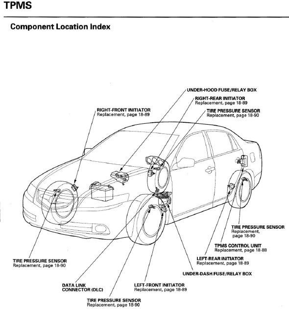

Hi guys, complements of the season. So my tyre pressure shows correctly on my instrument cluster, the issue is it shows a TPMS error after few minutes of driving which shows a - for all tyres. I believe the issue is the tpms module, Can anyone direct me to where the tpms module is on this vehicle so that i can replace it. If there's picture of this, i would appreciate.
Old Dec 17, 2023 | 01:30 PM
Posts: 6,944
Likes: 2,221
This is from the 07-08 Helms, hopefully it's accurate for the 06 TL?

It looks like one has to remove the rear seat-back to replace the TPMS control unit; therefore, if you were doing the indicated work above it's possible you 'tweeked' the control unit base to affect communication?
