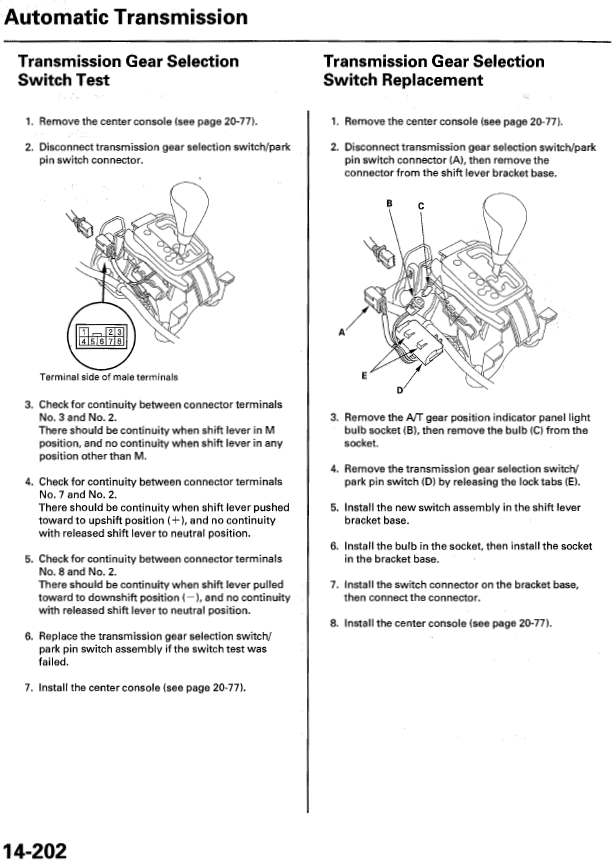

OP, test the switch.
Step 5 is what you want to do.
