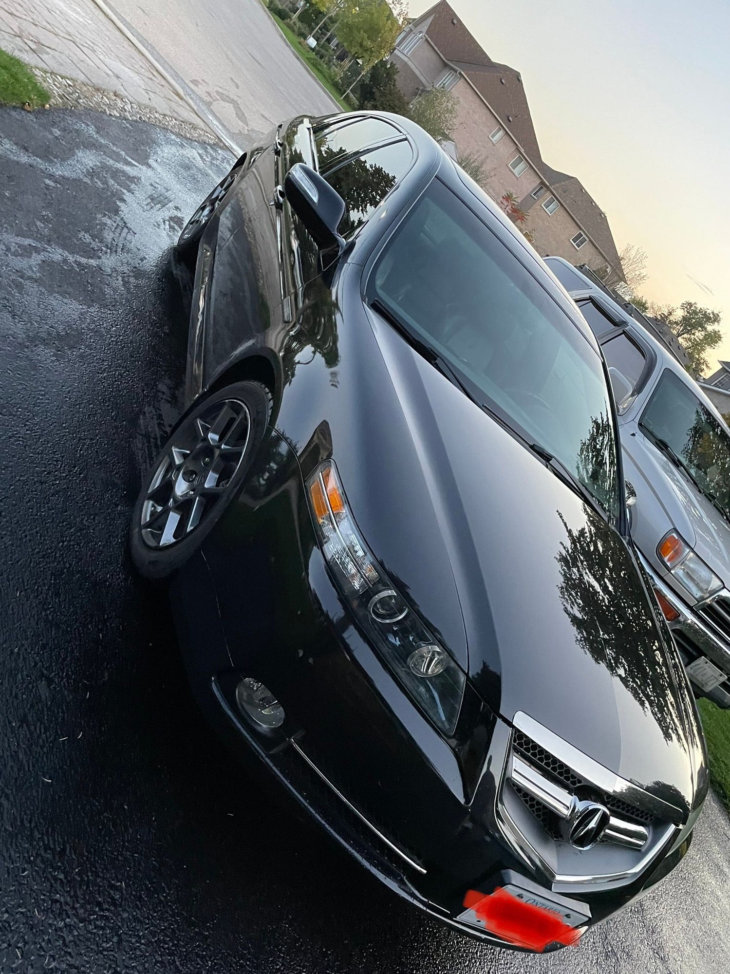

pics attached of the car just to hopefully bring attention to this thread. Thanks. 🙏
