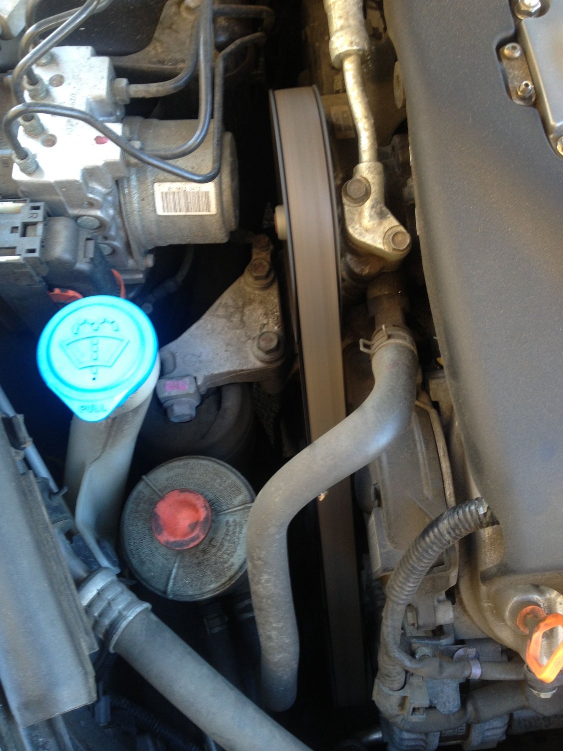

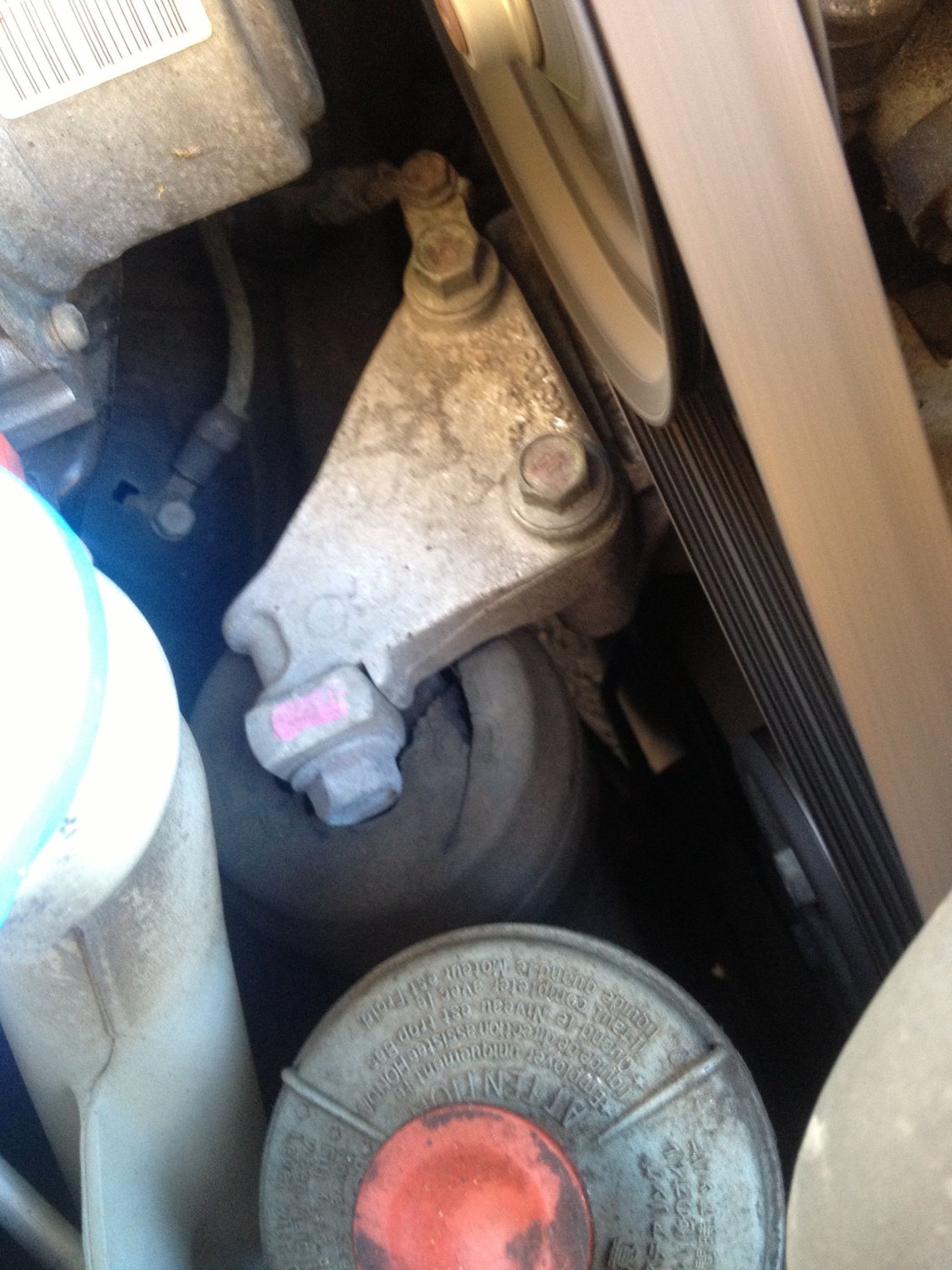

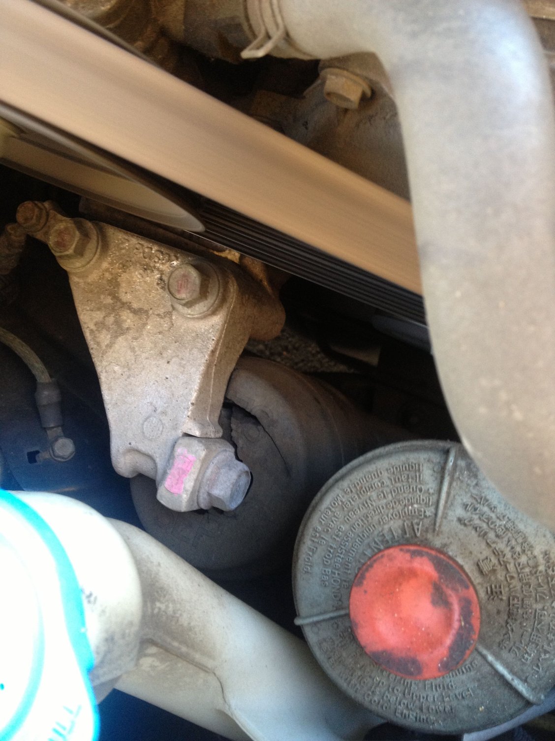

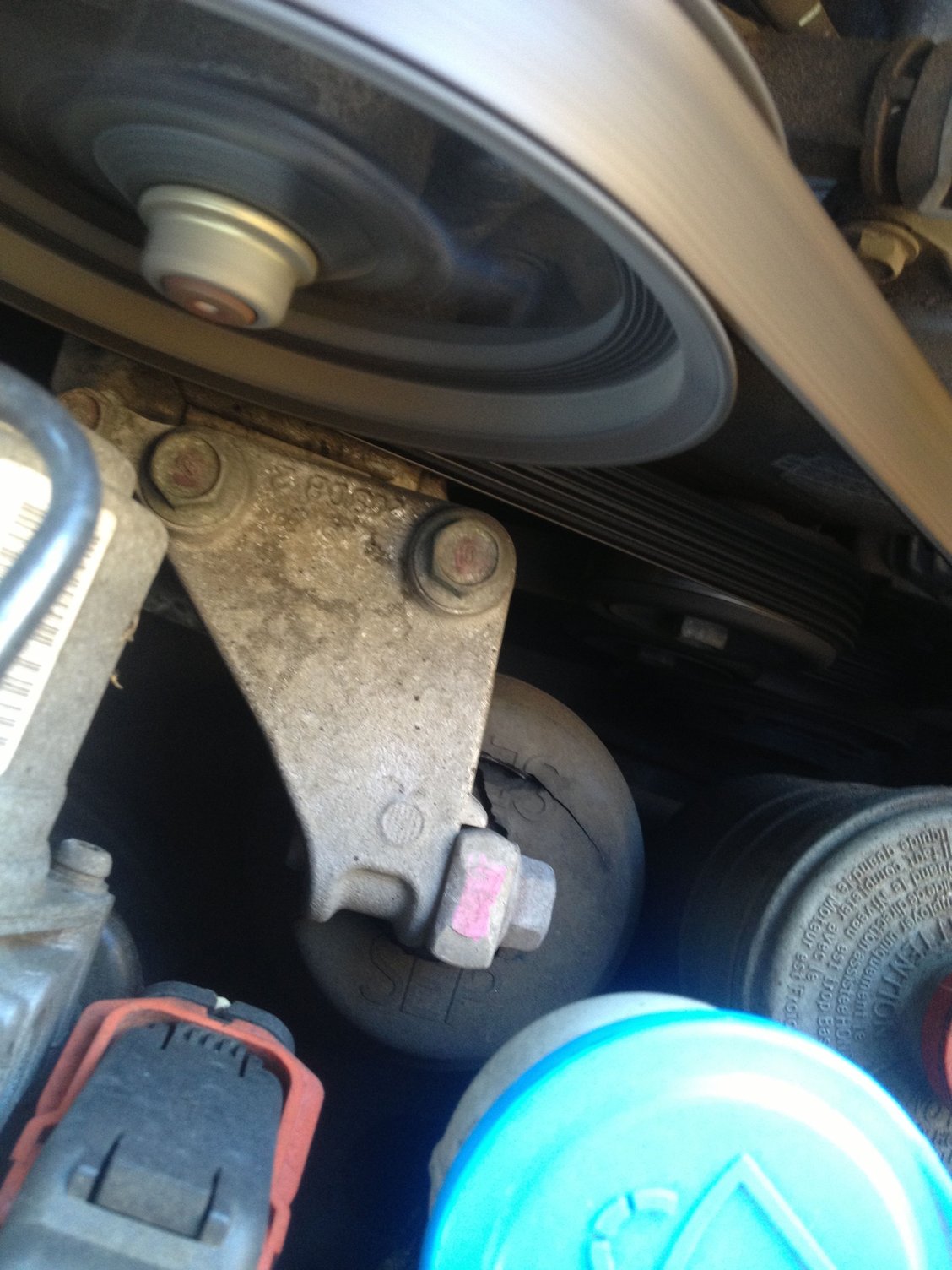

What is this part here? Looks broken. Could this be causing a thud sound with every bump in the road? Engine mount?

Yup looks like an engine mount and that sucker is broken.

Side engine mount.
it is indeed broken.
and it could be the source of the sound you're hearing as it holds the engine in place.
