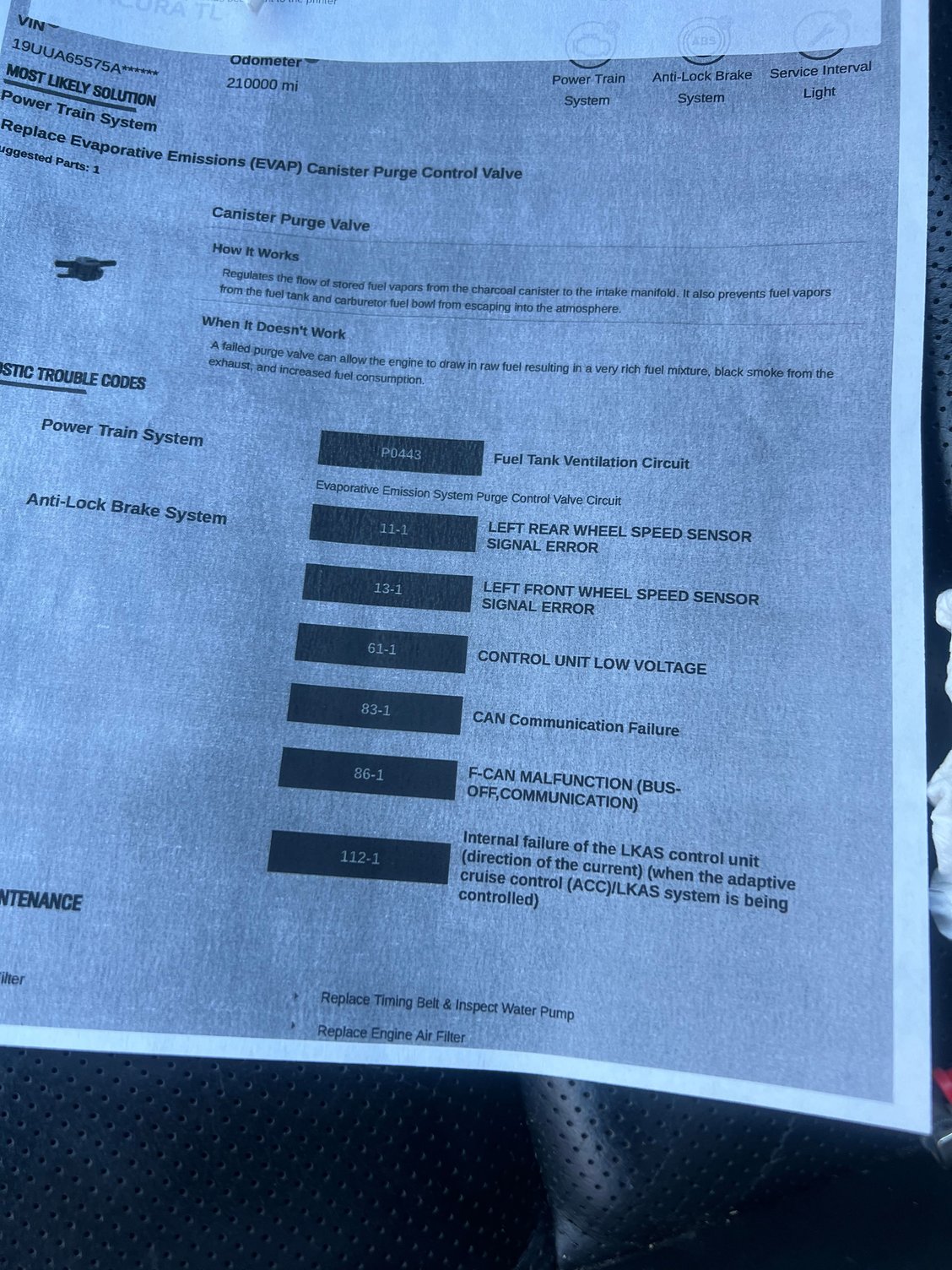

Any threads relating to this post? I bought this car previous owner changed engine I checked abs module seems to be connected maybe faulty ?

You should fix that low voltage code first: 61-1 Control Unit Low Voltage
A lot of false codes pop up with low voltage.
