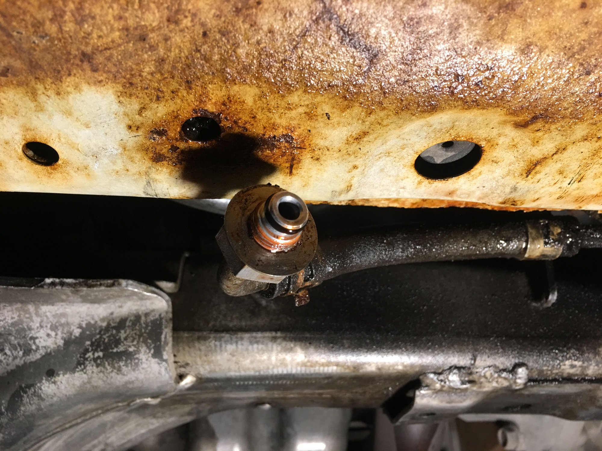

Old Nov 22, 2016 | 04:15 PM
StefanThePro's Avatar
Joined: Nov 2016
The fitting I found loose
The radiator port where it broke clean off
I'm diagnosing the exact same issue, it was the radiator, the fitting broke loose and leaked dark oil and green coolant.
Ill replace the radiator and go from there
