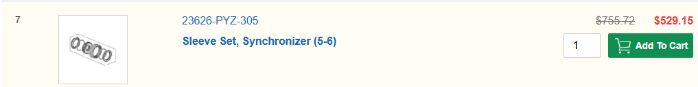

Try the ACDELCO 104014 friction modified fluid, see if it improves functionality. It can be found at rockauto for cheap.
Otherwise, the fifth gear & 5-6 synchronizer sleeve set may need to be replaced? It is still available as shown below.
There was a third gear grind / pop-out issue in a past TSB (attached) that called for the 3rd gear sync set to be replaced.
Maybe you'll get lucky with the 104014?
