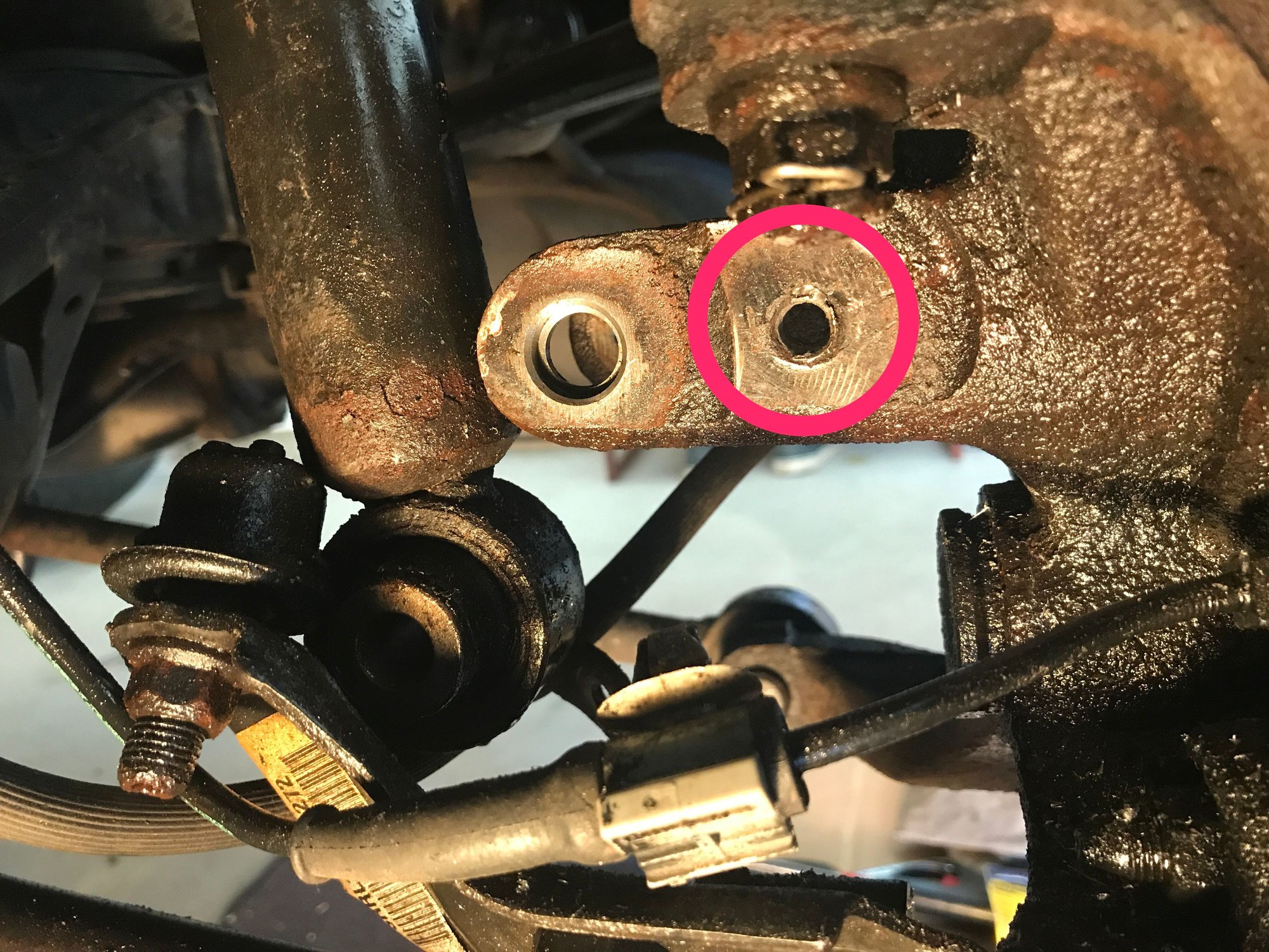

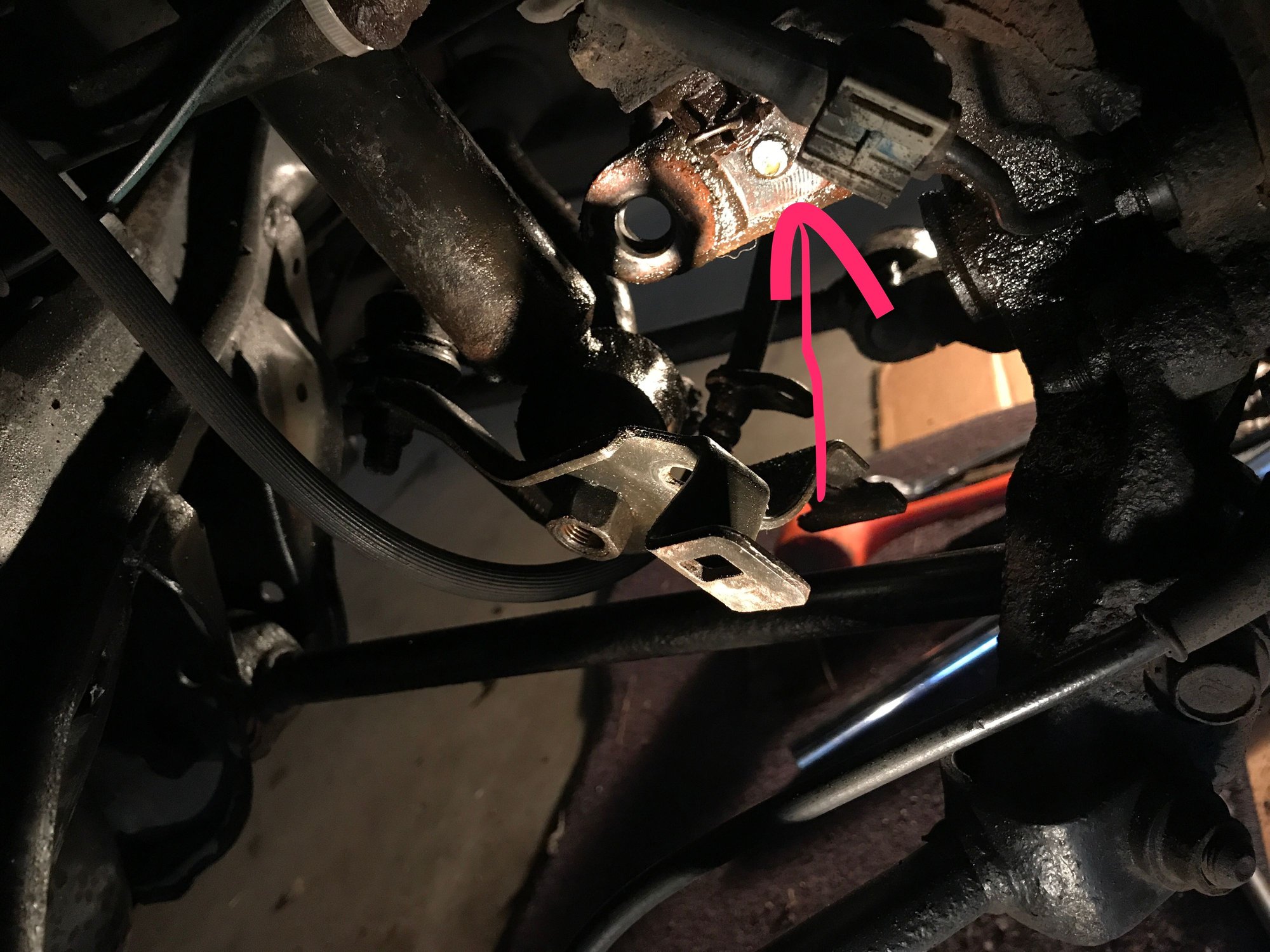

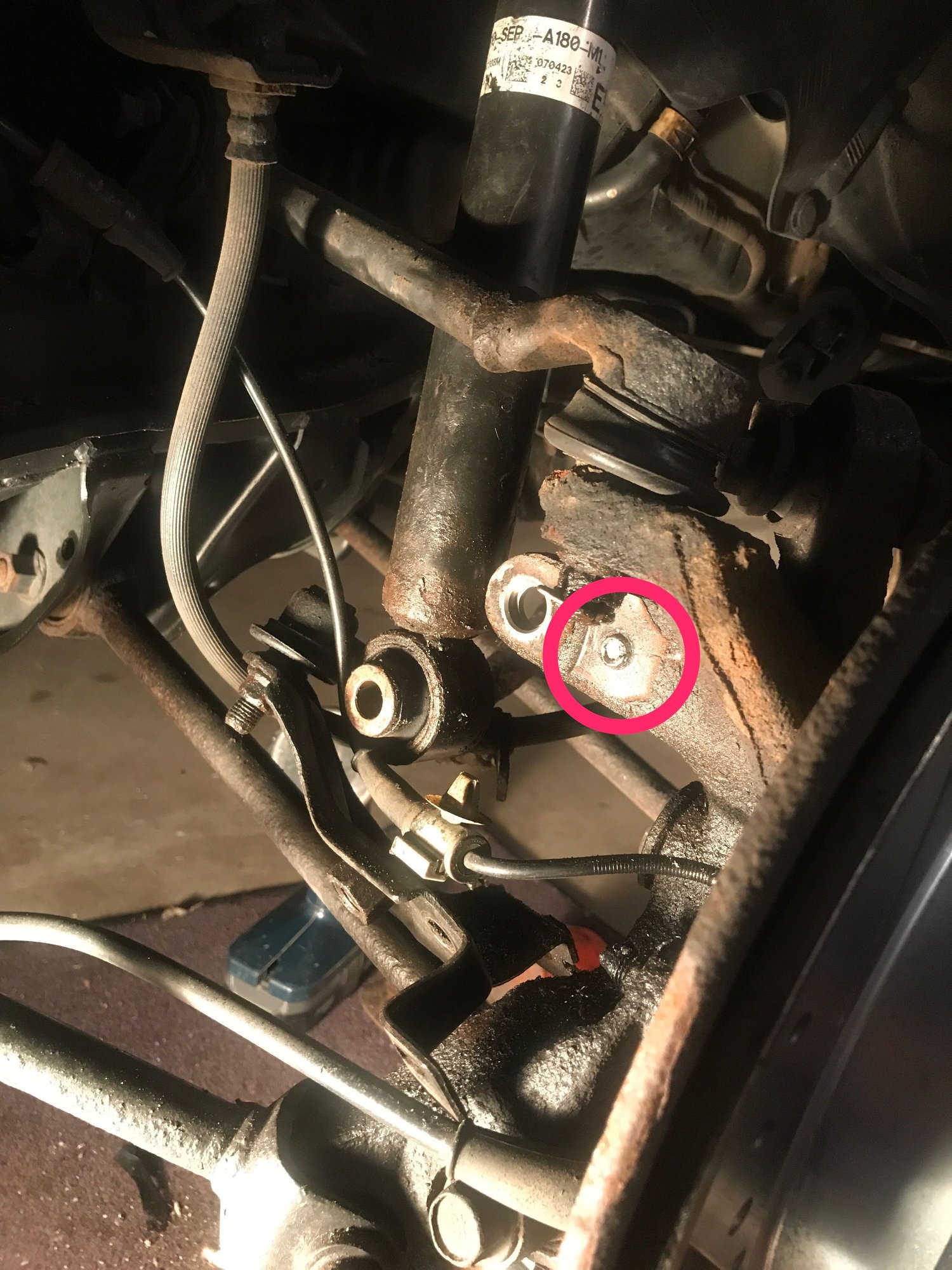

1. ok long story short I was trying to remove the rear driver strut and in order to do that I had to remove endlink but instead of removing the swaybar I tried to remove the whole bracket ( I broke this 12mm bolt here ) that holds the brake line , ABS wires and the endlink.
2. We all know when you broke the broke bolts either you have to use the bolt/screw extractor or drill them out and retap ...correct ?

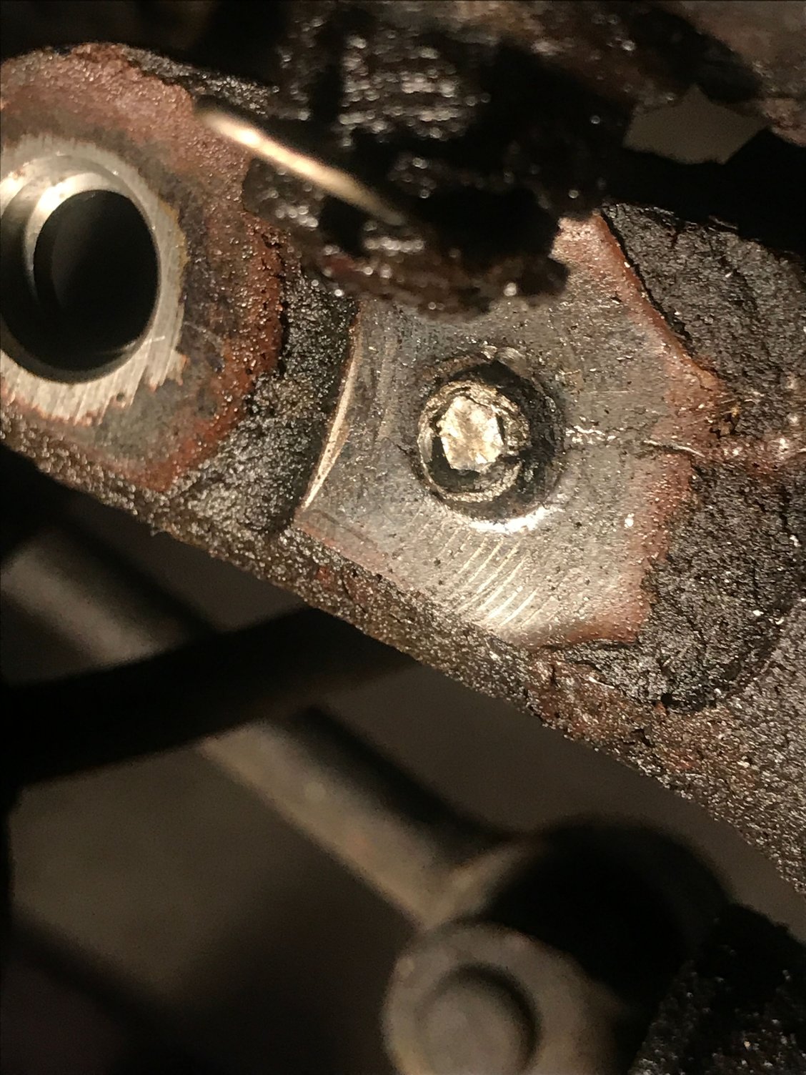

3. I decided to use the bolt/screw extractor .... fast forward 10mins later I broke the extractor ( see pics ) .
4 . NOW half of the extractor ( broken piece ) is inside the broken bolt and YES this car is corroded on every bolts .
What do I need to to do now ?

Thanks fellas but I did try to drill that extractor tips out but the bitch is made out of some kind of hardened steel ... couldn't even make a marks on them .
I am not trying to save the hole or anything ... I can always retap them but what's stopping me is that extractor tips is broke inside the broken bolt .... I'm not sure if you guys really understand the situation here .

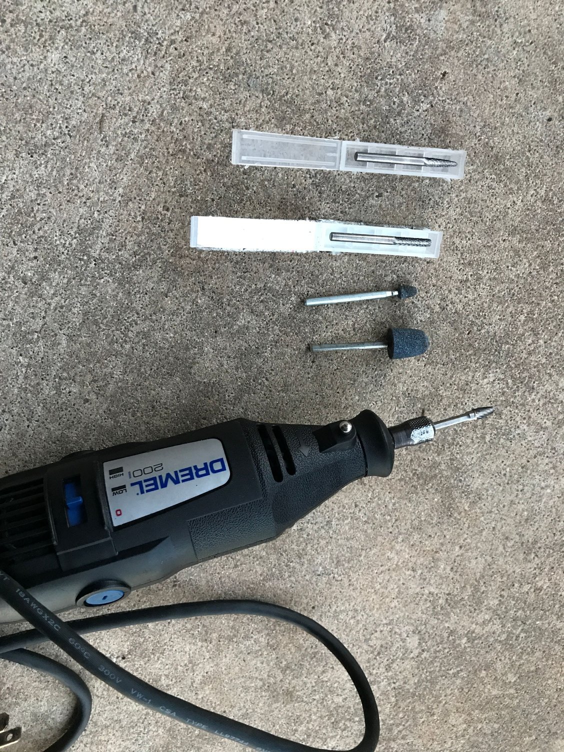

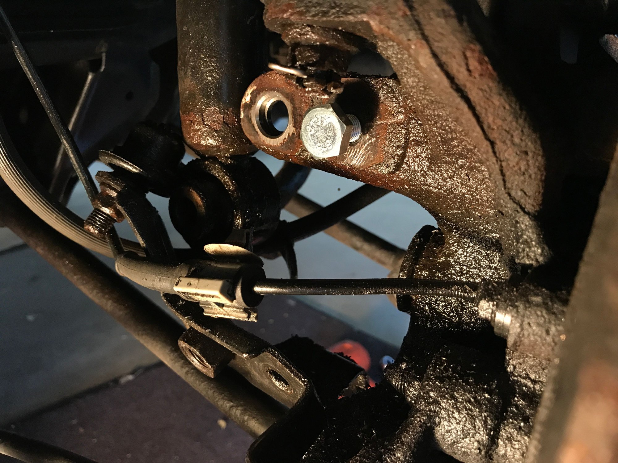

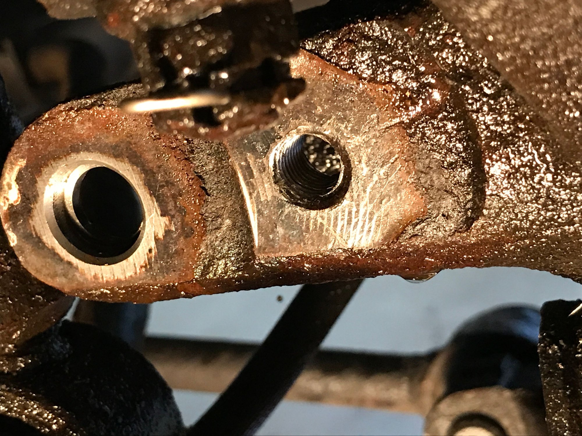

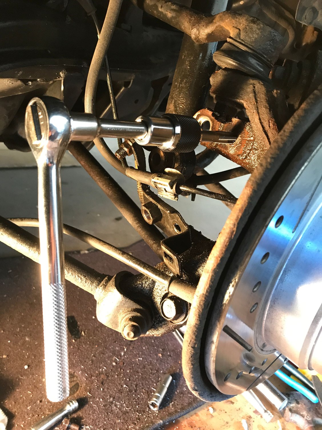

Ok guys got it fixed w/o removing the spindle or torch . Let's the photos do the talking ...

Old May 17, 2017 | 10:27 PM
Le7316's Avatar
Joined: Aug 2013
Posts: 204
Likes: 13
But how'd you get it out?
First , I used the first bit ( top one ) then the second one next to it then third one ( the one on the dreamel ) to make the hole larger I then used to grinding stone ( I've used 3 of this ) then a regular drill bit to clean up the rest . The final step is retap then new bolts ... it came out vey clean hole as you can see from the photos .

Wow, I would have never thought a dremel bit would work. Great job
you will have to get that kinda bits that I used otherwise it won't go thru the steel ( EZ-out) . Lol
