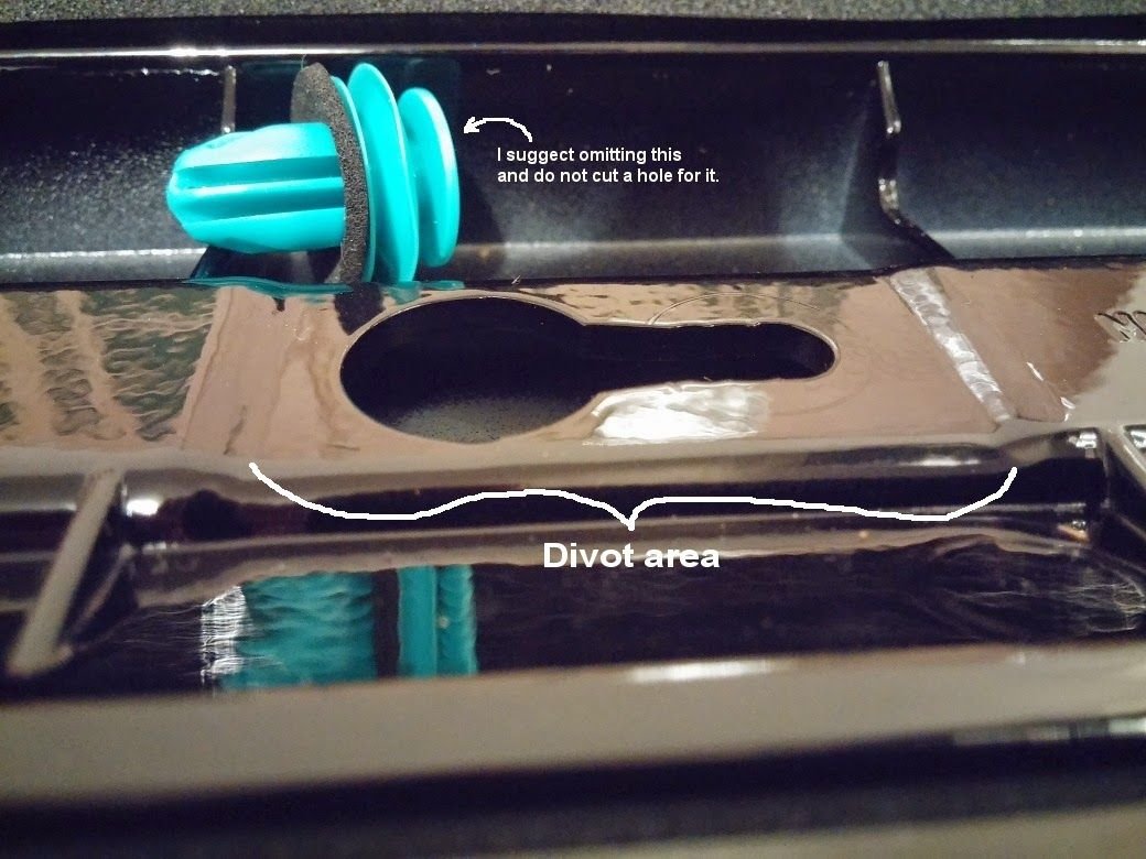

I scored the bottom because I wanted a little more friction to secure the nut a bit more surely. I did not have a lock washer that size, so I just scored the bottom. OEM does not require a lock washer, but I just wanted one for added peace of mind.
By the way, I suggest drilling the 2 holes for those metal screws ONLY. I would not drill for the 3 white plastic tips that use the yellow caps. And I would not drill for the 2 green/blue plugs as shown below. Those green/blue plugs do not have much margin for error because of the way they are designed. And the yellow caps are super duper hard to get on, especially in the angle you have to access it. So, Leave them off! Between the 2 metal screws and THIS double sides tape, your spoiler will be on like concrete. And if you have to pull it back off, you can just replace the tape because they give you a lot in that roll. So, put 2 pieces of tape in the "Divot" where the Green/blue plugs located AND where the white male/yellow female caps are located on the ends and the 1 in the middle. I used a heavy duty velcro in the center divot only but I could have used 2 layers of that double-sided tape. All other areas only need 1 layer of tape because they are not "recessed". The velcro I used is the same velcro I used to fix my headliner! And it has been holding for at least a year and that suffers heat exposure.
This is the velcro I used This is the velcro I used
but I think they changed the packaging. It used to be Yellow like this: http://dylbs6e8mhm2w.cloudfront.net/productimages/500x500/105831.JPG
But you don't have to use velcro. That double-sided tape is probably more "stable" than velcro. But I have so much of the tape installed that it makes the velcro irrelevant. So, you know, its just touch and go, try this and that. Just take your time to drill those 2 holes.
To help to find an accurate location for the holes, I put a tiny piece of yellow tacky putty on the end of the metal screws and when it touched my trunk lid, it stuck to the trunk lid. And I lifted the spoiler off, and then I drill a mark on the lid where the indention was made on the tacky putty. You might have another method! But this tacky putty sticks easily. It comes in Yellow or white or blue. LINK

by the way, You dont really have to put anything at all in the "divot area" that I showed in the pictures, for those locations. Because if you put tape on the adjacent flat areas, then you are more than covered for a stable installation. So, really, you can choose how much tape you want to install and where you want to place it. Just know that if you put tape down in the divot area, then you'll need 2 layers because it is recessed. So, lots of room to improvise! Just make sure you install the screws and nuts for the 2. Everything else can be taped 1 way or another. And if you make a mistake, pull it off and redo the tape. No sweat! There is probably enough for 3 spoilers in that roll I proved a link to at harbor freight.

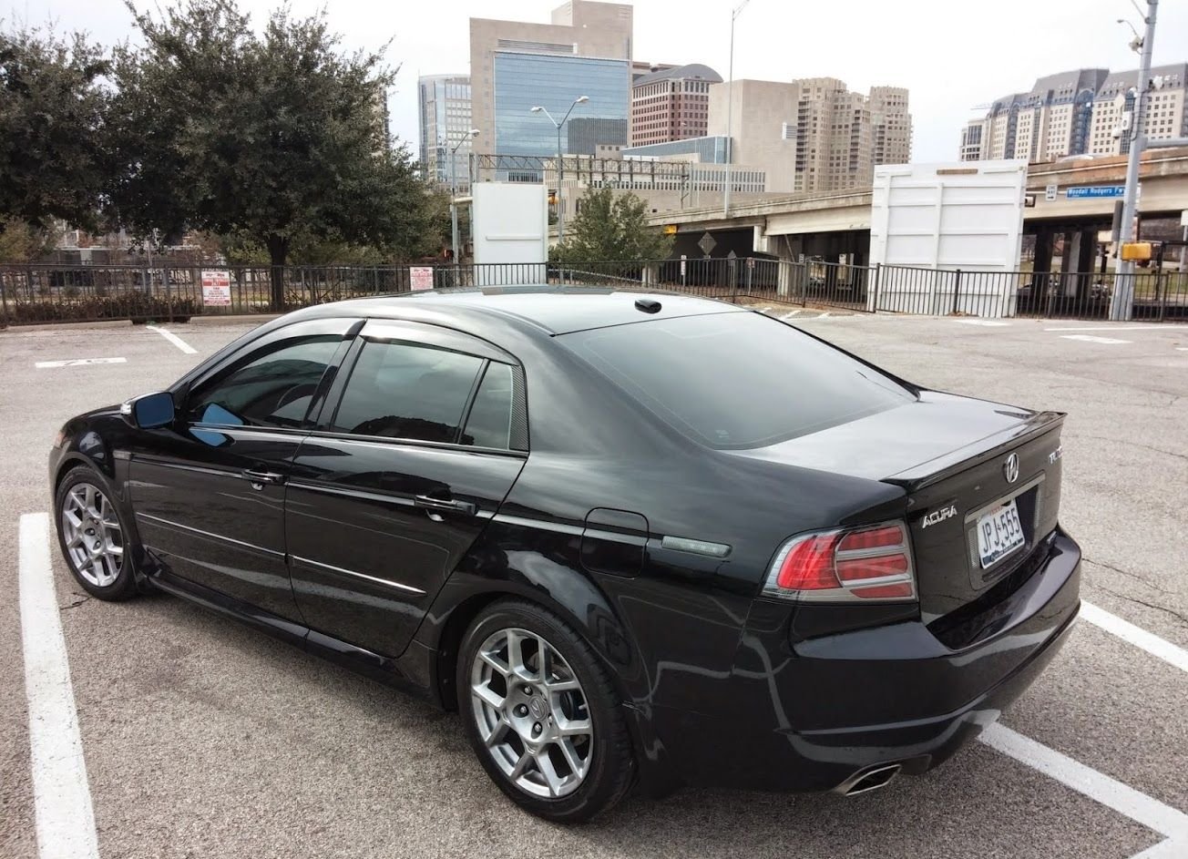

I just pulled it out of the garage for a coffee run. (btw, it is sitting on eibachs, I removed the teins) pic taken with LG G2.

The black looks so delicious in this pic...giving me car envy over here. The spoiler looks great, the height is great...
