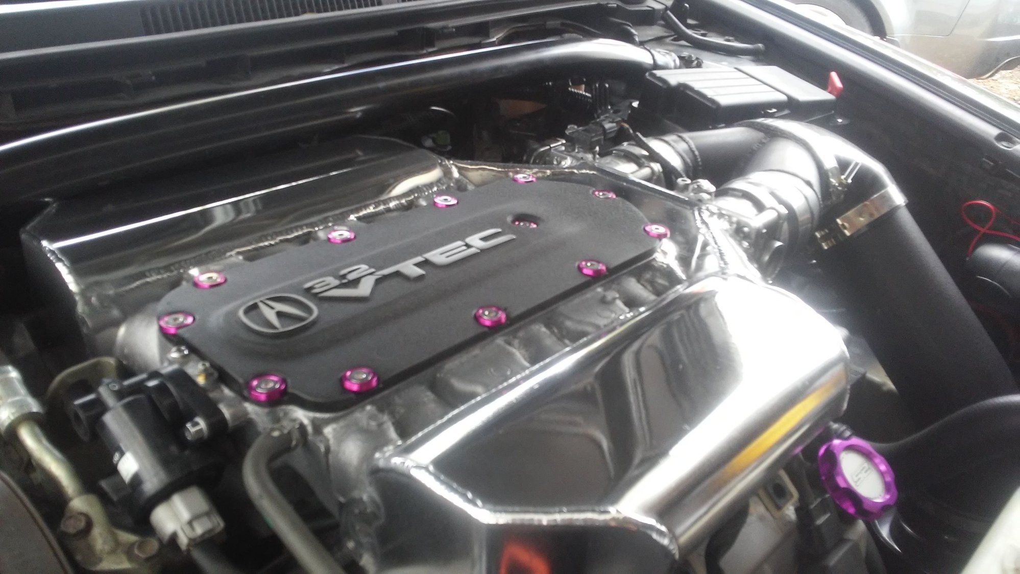

Here are some pics of the car. Picked it up stock about 3 weeks ago. Wife had an 04 auto, found this 6 speed, got it and I switched all the parts over and have been working on the dual tb setup.

BB6 your intake manifold mod looks fuking amazing.. Don't mean to thread jack but could you please tell me how it was built
Thanks! It was built in my shop, I had gone through two other designs before finalizing on this setup, but it looks promising. It was built mostly with .125 6061 Aluminum, TIG welded, press bent plentums, cad designed. The TB's were dissected and shaved, shafts extended. It's a pretty complicated setup, easily 100hrs into the project all said and done, but I could do another one in 40hrs if I had to. Going to wait to see how it performs before anything else. Runners were also fully ported as well. Car made 239whp with only the exhaust mods, nothing else done, so the intake system and tuning should really wake it up. I have an instagram if anyone wants to follow progress @52eightyperformance

Sick intake.

that intake mani looks crazy, what exactly are the gains from this?

I am currently waiting for an HDS cable so I can calibrate the DBW because there is an idle surge. Once the tuner is installed then I will dyno to see gains and I will post them. Last Dyno was stock with full exhaust, so I will get results for the intake untuned and tuned to see how much can be gained from timing and DBW control.
