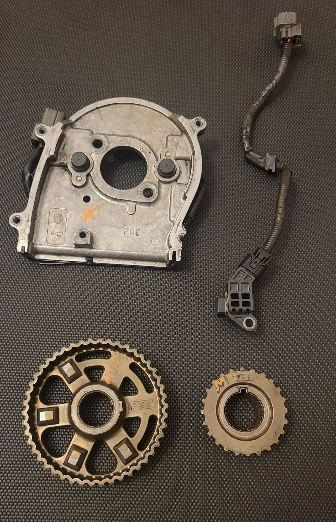

At minimum expect to change the front cam gear, backing plate, crankshaft lower front timing gear, ckp and cmp sensors. All easy stuff with both motors out and timing belt removed. Do the timing belt, tensioner, and check adjust valve clearance while you're at it. Mind you this is not considering changes to the engine/trans harness and ecu, pedals, shifter etc already mentioned. GL.

Originally Posted by 619rcr
At minimum expect to change the cam gear, backing plate, crankshaft lower front timing gear, ckp and cmp sensors. All easy stuff with both motors out and timing belt removed. Do the timing belt, tensioner, and check adjust valve clearance while you're at it. Mind you this is not considering changes to the engine/trans harness and ecu, pedals, shifter etc already mentioned. GL.
I get
“belt, tensioner, and check adjust valve clearance while you're at it. changes to the engine/trans harness and ecu, pedals, shifter etc.”
But why
“change the front cam gear, backing plate, crankshaft lower front timing gear, ckp and cmp sensors.”

Originally Posted by Acura TL Builder
But why
I stand corrected. These were the ones I set aside from an 05 RL J35A8, Same p/n for 3G TLS MT.
Apologies for the misinformation.

Originally Posted by zeta
It's more or less the same swap components needed to make a 2G CL / TL automatic J32A2 or 01-02 MDX J35A3 manual transmission compatible to work with the CL-S6-speed ECU?
And yes, these are the parts for 2G 6MT. Interestingly enough the TDC sensor is the same between 2G 6MT and 3G MT/AT.
Oh, that’s what you meant about ‘back plate’. Yes One of the 2G cam gear back plates has two timing sensors while the 3G only has one. The cam gears are also wider on the 2g, so if you putting 2G heads on a 3G block, you will need to swap the cam plates and cam gears, as well as tap a new hole for the sensor bolt.
And seal/weld the oil return drain on both 2g heads to fir on the the 3G block.
