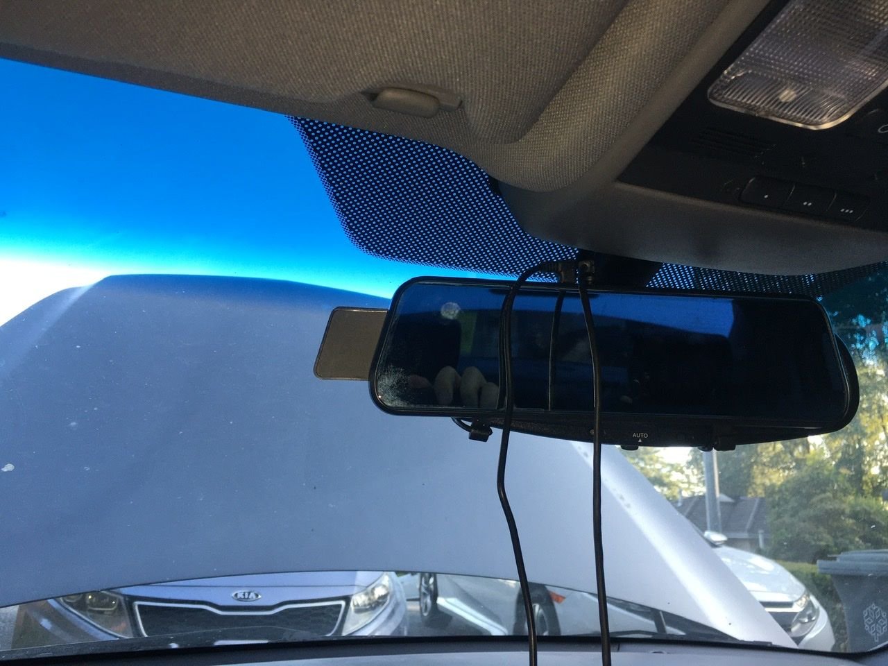

Backup cam monitor

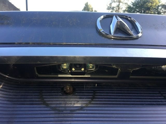

Backup cam wireless adapter (transmitter part) connected to the backup light wire both plus and minus(grounding) on the left. the one on right is for the LED license plate light connection. The LED light successfully turns on when I turn on the light
Honda style LED license plate light with backup cam
