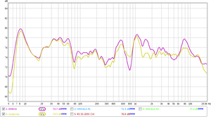

I've been reading up on this alot lately.
True RSA is great, but to get useful resolution you have to pay. Room EQ wizard is pretty much the same thing, but free.
http://www.hometheatershack.com/roomeq/
As for a mic, I just found out something awesome. You have a newer HT reciever with the audessy dsx multieq room correction? That mic is actually amazingly accurate.
Its response vs a professionally calibrated mic.
Available for like $30 new, or $10 on ebay. I already have one. No special preamps or anything needed. Just hook it right up to your soundcard.

I've never actually tried using the laptop to edit the 3sixty.2. I opened it up in demo mode and fooled around with the eq, but never in a live environment. I remember it wasn't super intuitive, but it should do it.
Oh, if you use Room EQ wizard, make sure you do the sound card calibration. Some people suggest using a cheap USB sound card, but I'd give it a shot with your internal sound first and see what happens.
Yeah I'm not sure if it is either. I'll just buy the little $15 mic or whatever if I have to..not a big deal. So you're saying you opened it up on a laptop and you were able to move the EQ bars up or down for all the frequencies on the specific channel you were on. I know the sub only has like 12-band or something but the others should have like a 31-band EQ or something like that.
Is this correct?? You run the RTA to figure out where you have peaks and valleys in your car. Then use the 3sixty.2 EQ to level it all out. Re-run the RTA and see if you have a somewhat flat response. Yeah? As BeachTL said, most don't like it completely flat so maybe I'll read up or make a thread on DIYMA about what kind of frequencies people like to boost or cut and why.

Sounds like you have the general idea, but you should be able to do it in real time. Just play back pink noise and eq your listening position flat.
Figured out the problem with the 360.2 software not showing the EQ...or should I say the small laptop with a low resolutions problem! You need a resolution of 1024x768 to see the EQ on the bottom and this little laptop I'm using is 1024x600. I knew I wasn't crazy!
