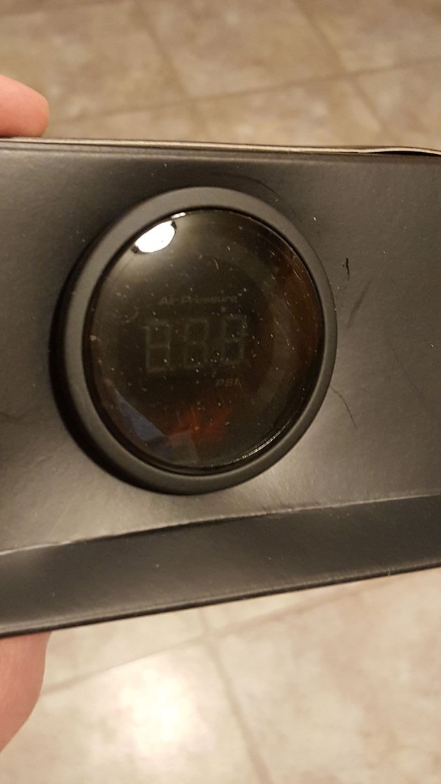

Got some products in the mail yesterdayyy. My horns and solenoid are here! Unfortunately the electronic guage is on back order so I'll have to use my glowshift tank gauge for a bit.
Old Mar 1, 2017 | 02:38 PM
SkyDiv3r14's Avatar
Joined: Feb 2017
Posts: 21
From: Northern Colorado
Apparently the gauge was on back order but I just got it in the mail! What a nice surprise!

Welcome to the TL train horn family. I installed mine back in the early fall. I have the hornblasters conductor special 540 series. Best investment I've ever made. A smile every time I hit it. I really like that pressure gauge, is that from them? The shocker series is phenomenal but I'd love to get a K5LA at some point. Obviously not for the TL, it wouldn't fit. I've been in the process of converting an old sub box to properly mount the 5 gallon tank and compressor and conceal it but have not installed it yet.
One thing to look into with your horns would be to upgrade your air lines to 1/2" to the solenoid. Makes a huge difference. Mine came with them but my cousin ordered the lower edition shocker and it was only 1/4" (I think) and the difference between mine and his is pretty significant.
Beware of the provided push-connect air fittings. The ones I had were good for a while but they over time have started to leak pretty bad. About 40-60 psi overnight. Lowes has the fittings in much better quality in the plumbing isle. They are about $7 but they seem to be much better quality.

Hell yeah man! Didn't know there was more of us out there haha. The pressure gauge is indeed from HB. Its just white in their photo.
Now do you mean 1/2" inner diameter or outer diameter? The hose I have now is 1/2 OD and it worked great when I had it on the integra.
I've heard the same thing about their fittings.. Do you have a link to exactly what you're talking about? aka which fittings??
Thanks dude! Any pictures or videos of your set up?

I'd love to get a gauge but I'm not putting a pillar in my car. If they had a smaller one, I'd put it in the cd holder in front of the shifter. Oh well though, the pressure switch is automatic anyway. It's O/D. I couldn't tell in the picture if it was or not. I ended up taking back the push connect and just picking up a crimp fitting. It seems 10x more solid and no leak at all. In about 2 weeks I'm gonna pull off my bumper and fix the front solenoid fitting so I'll snap a picture of them then. Well a better one at least.
I dont have a link, I just went to the store and found them in plumbing. last weekend I gutted an old sub box and put my tank and compressor in it. It has a clear front and a mirror base and looks pretty good. Plus it hides the wires and secures the tank. I'll take a picture of it tonight.
