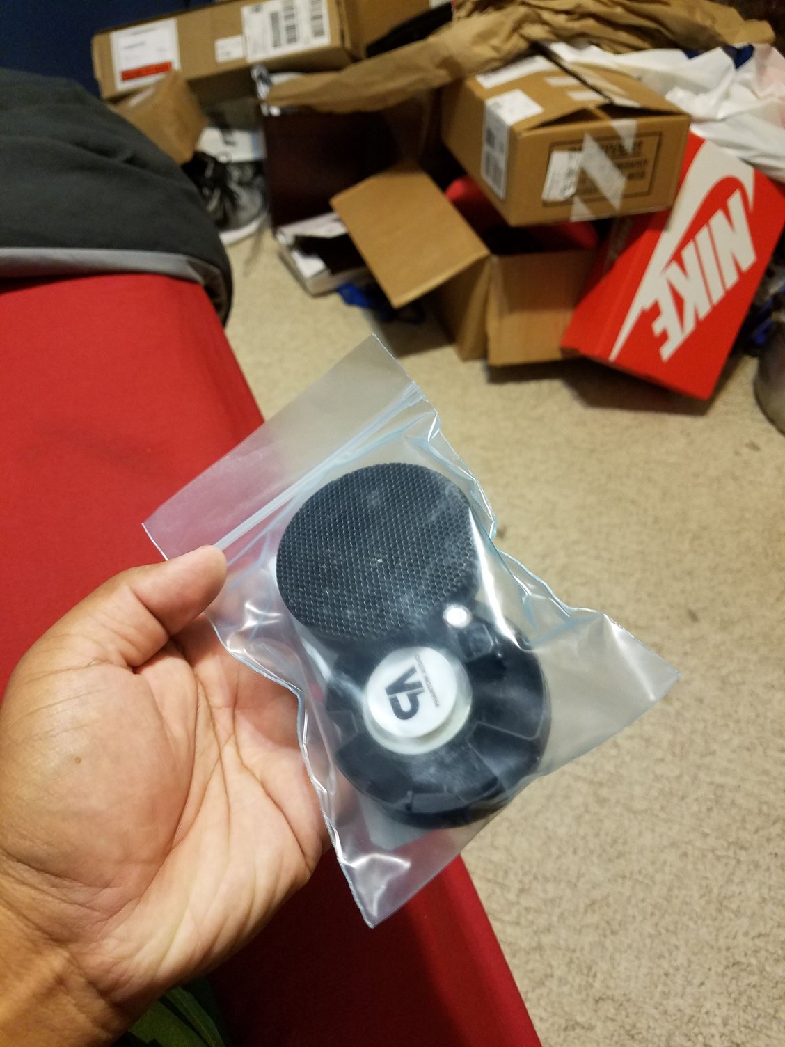

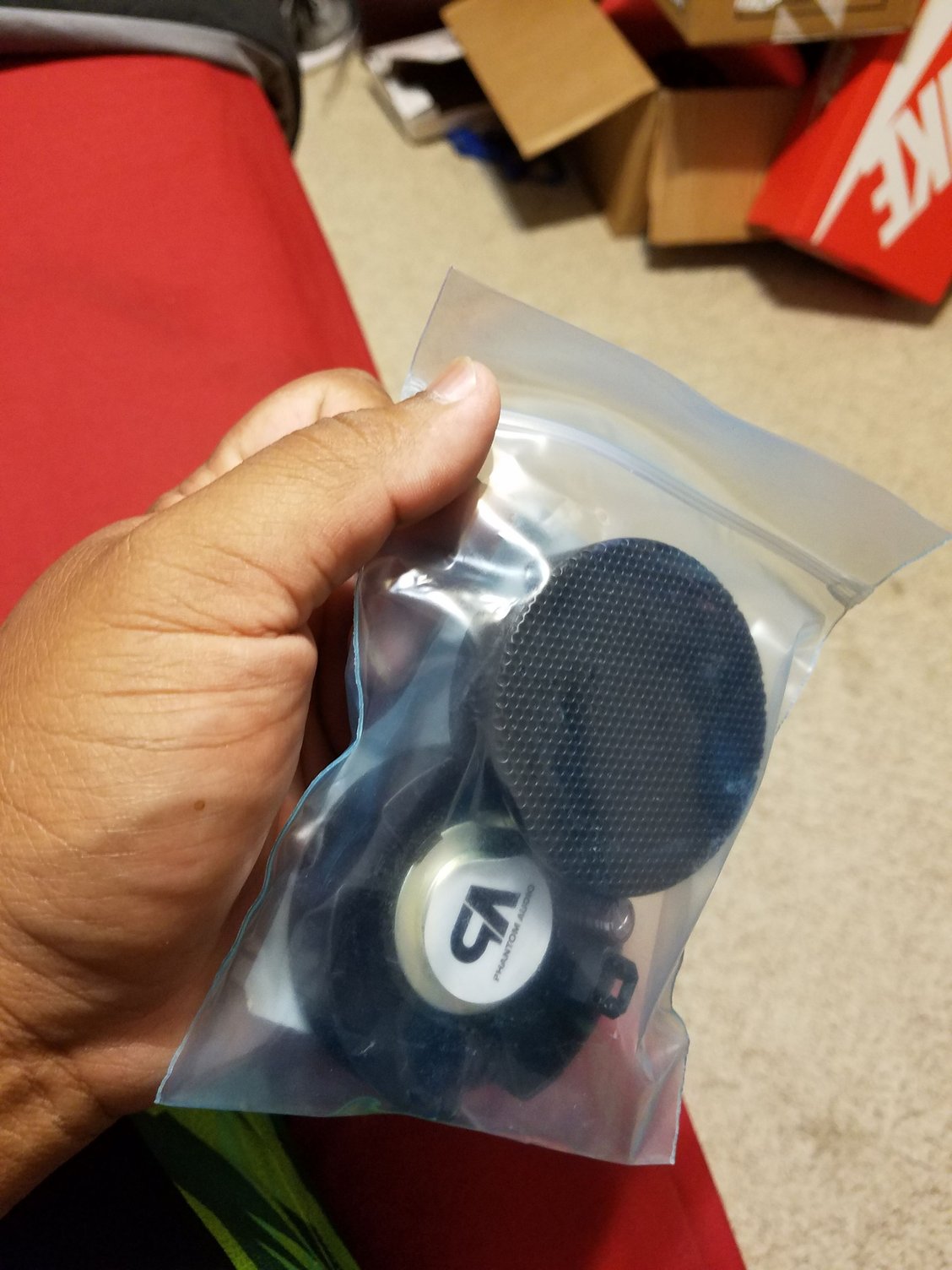

Unboxing
Input side (bottom)

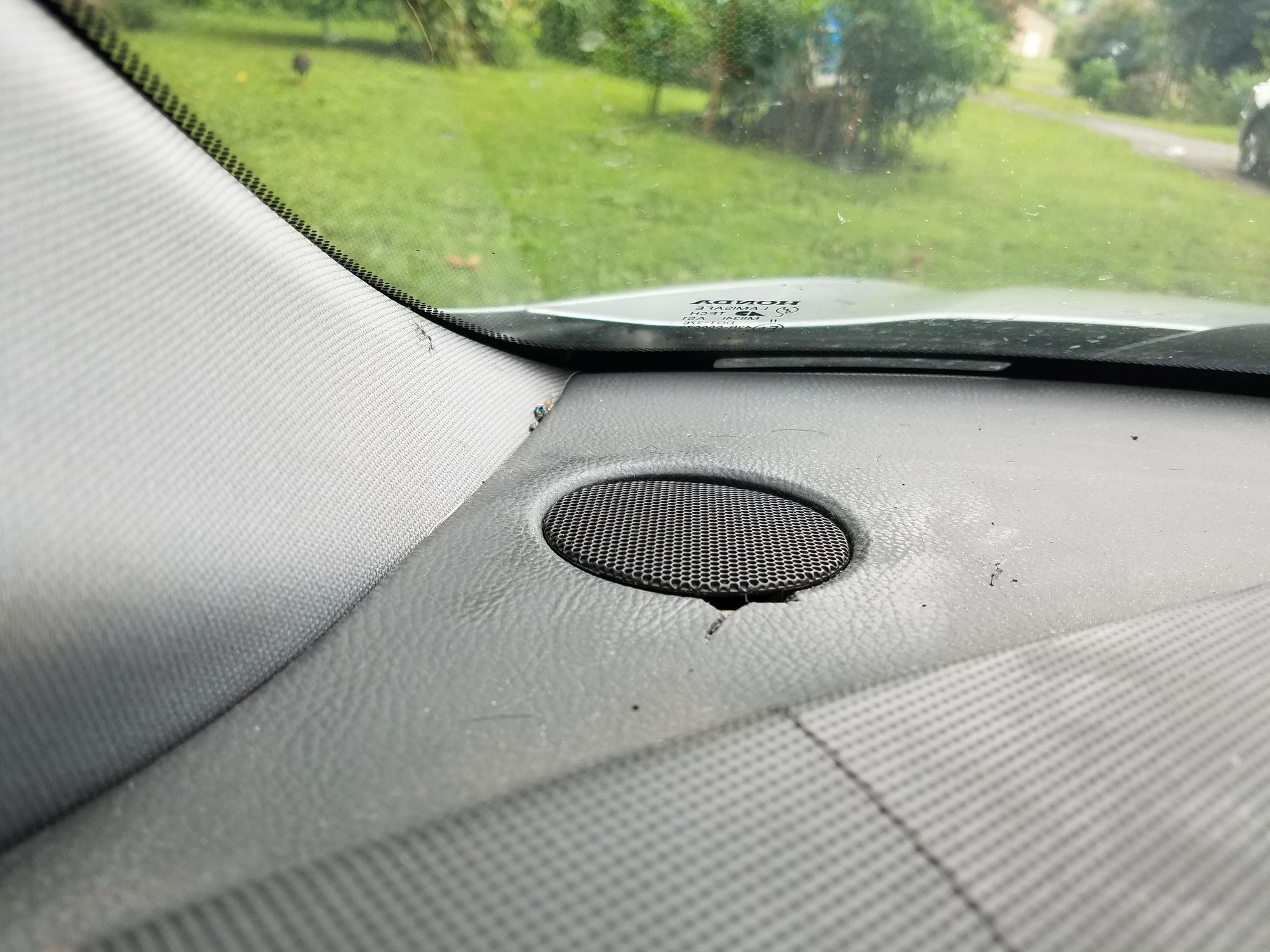

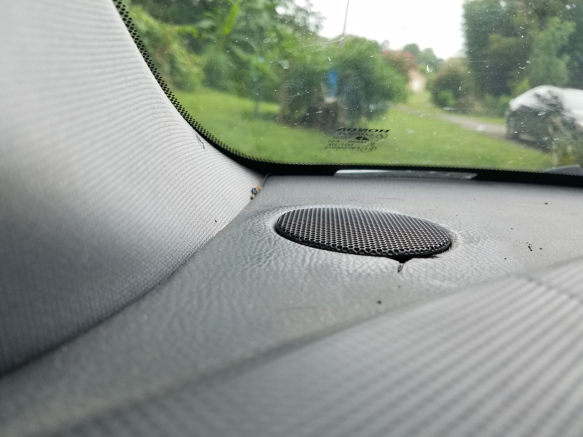

Tweeters

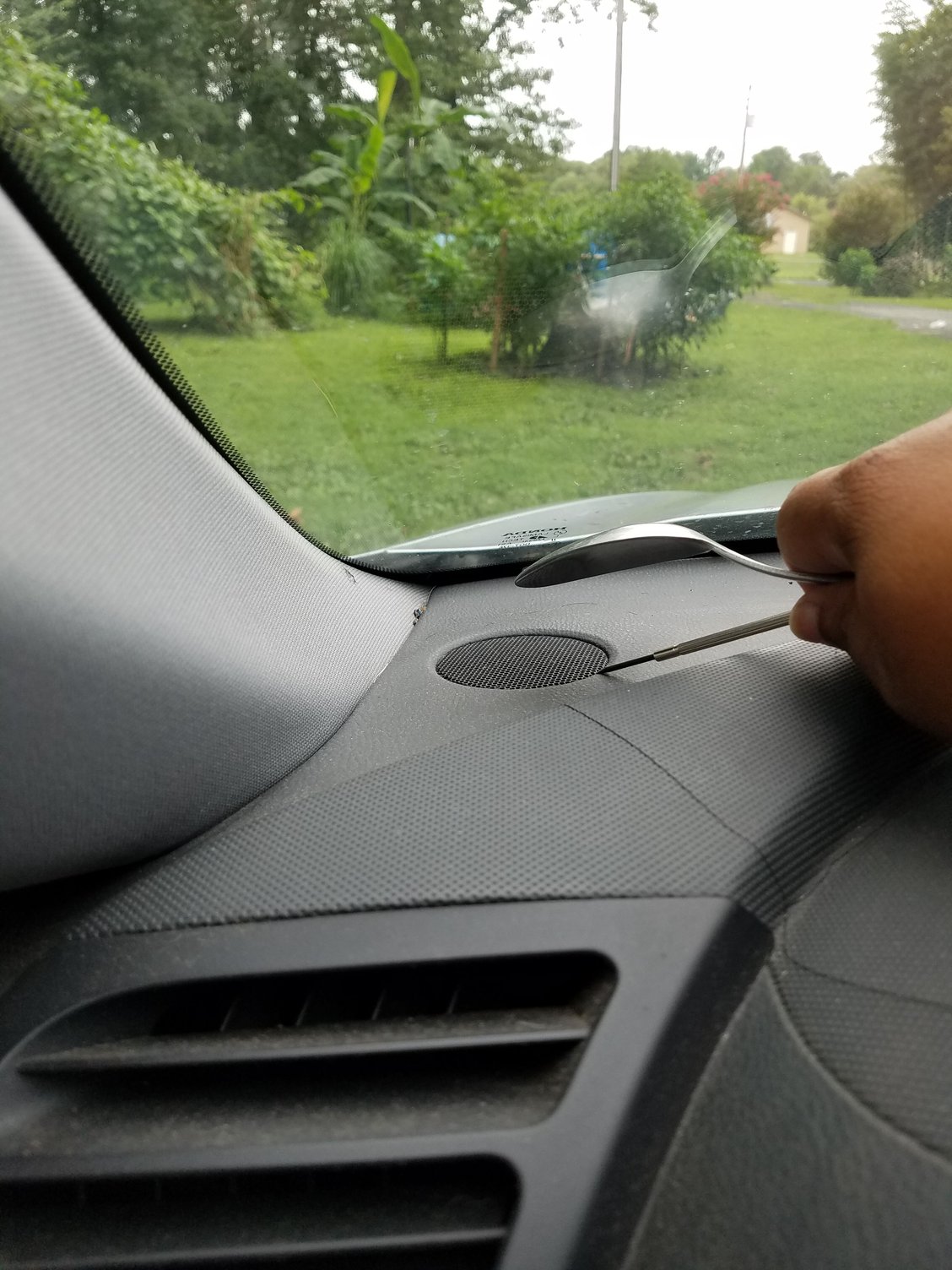

Misplaced my pry tools so i used a precision flat head and a spoon
Passenger tweet installed
Driver tweet
Didnt wanna come out
Got'emmmm!!

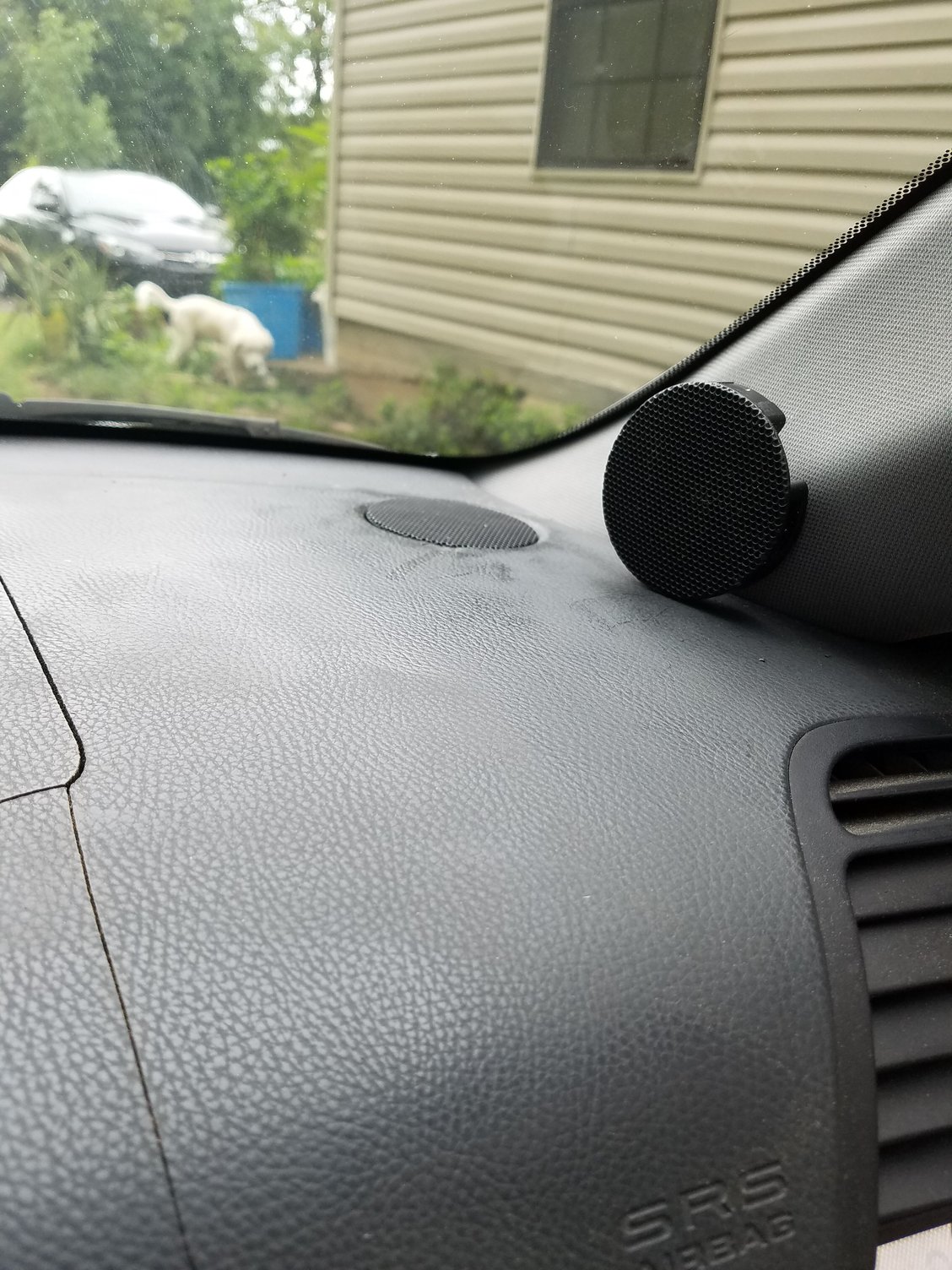

Driver side tweet going down
You gotta mess with them a little to get them flushed with the dash

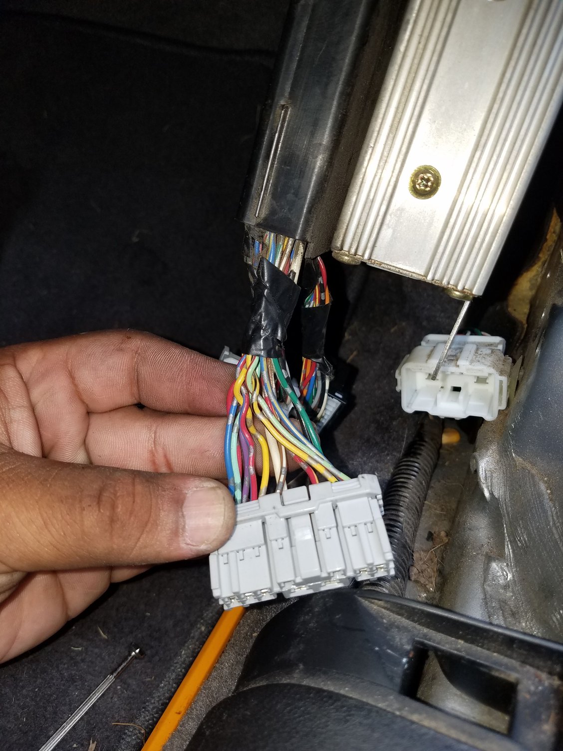

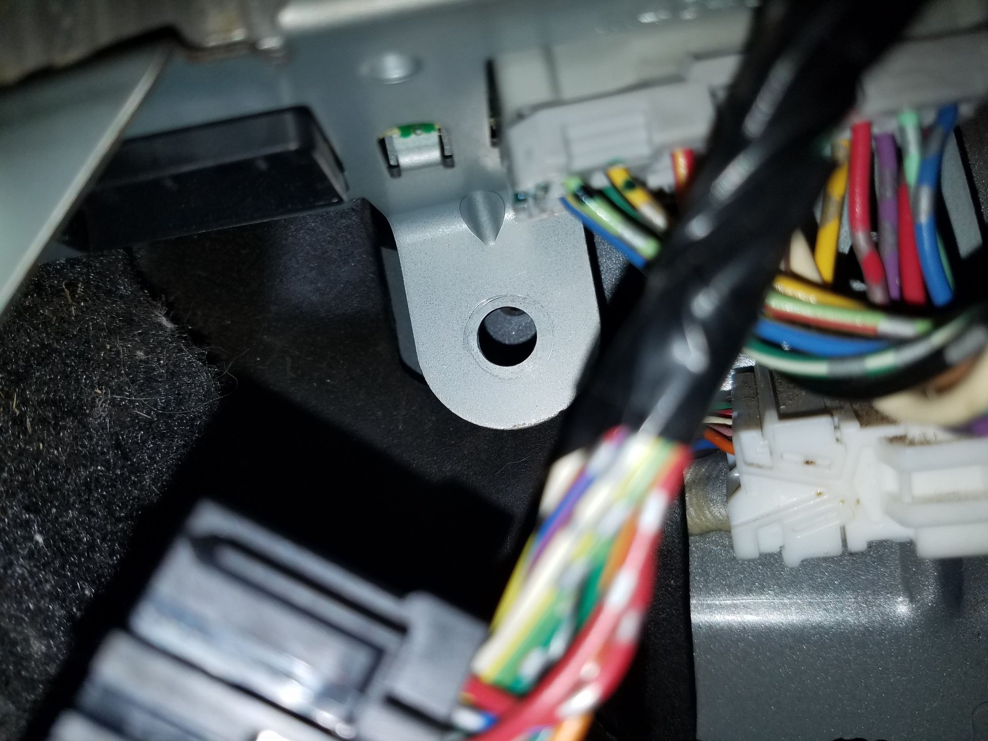

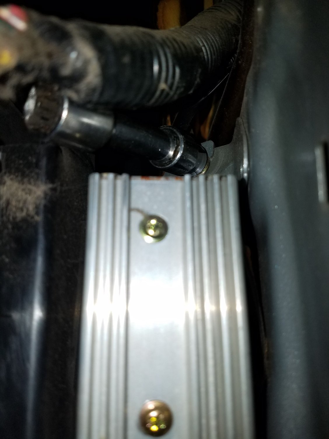

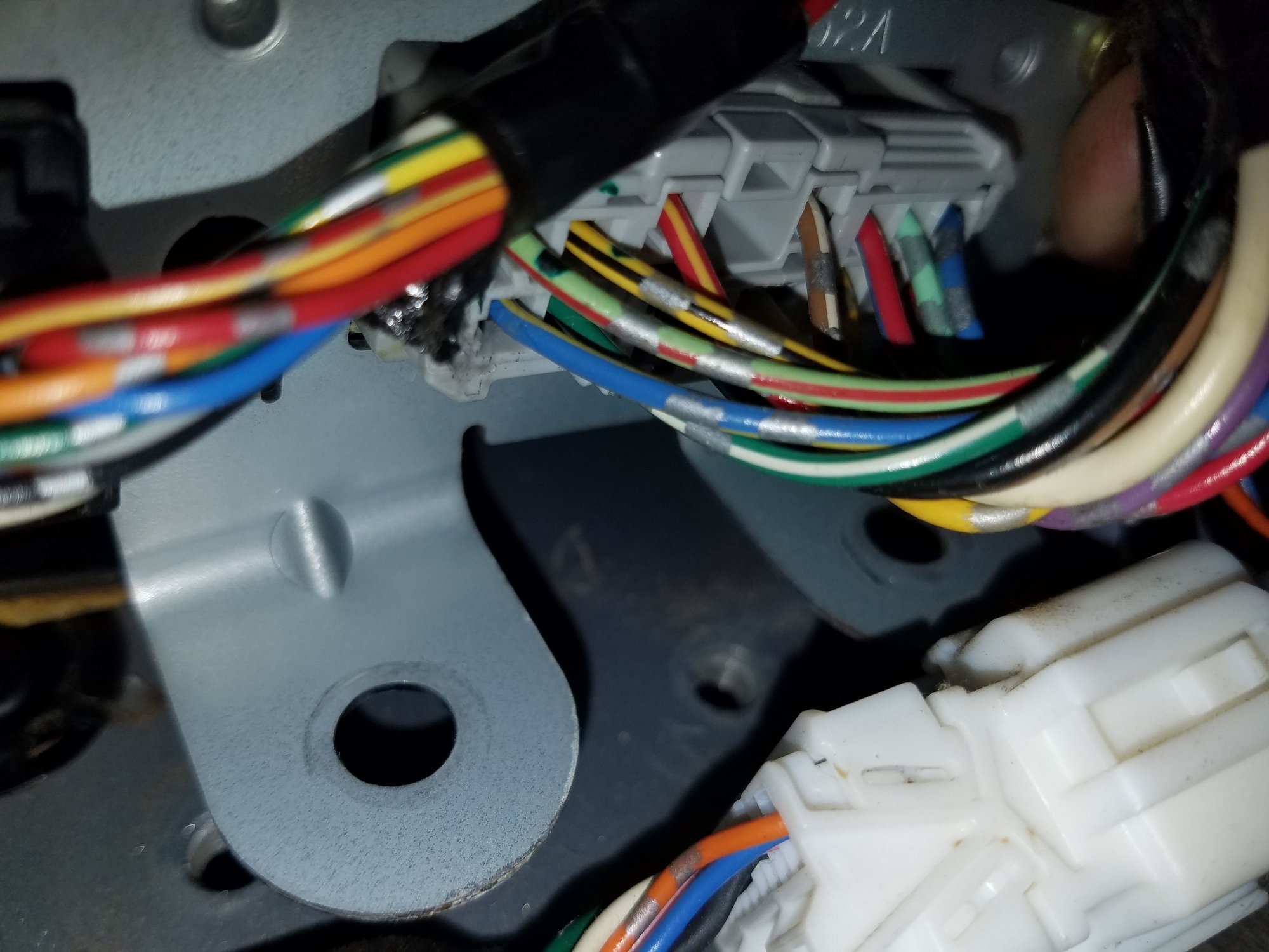

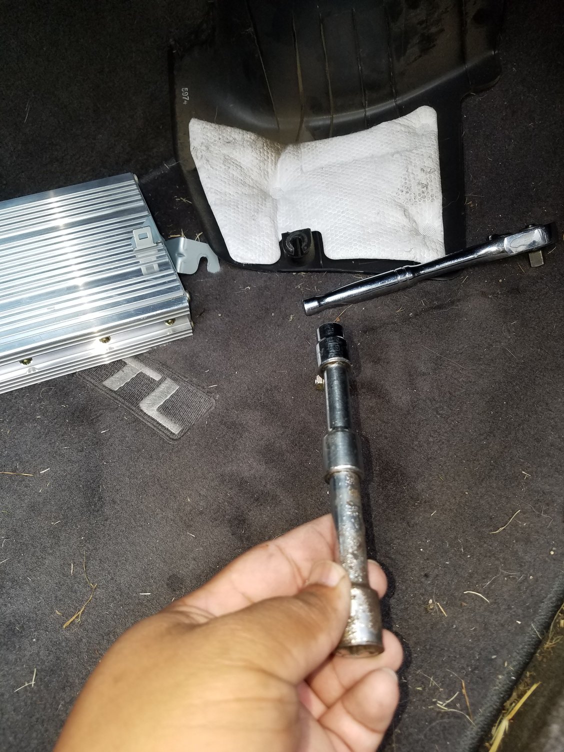

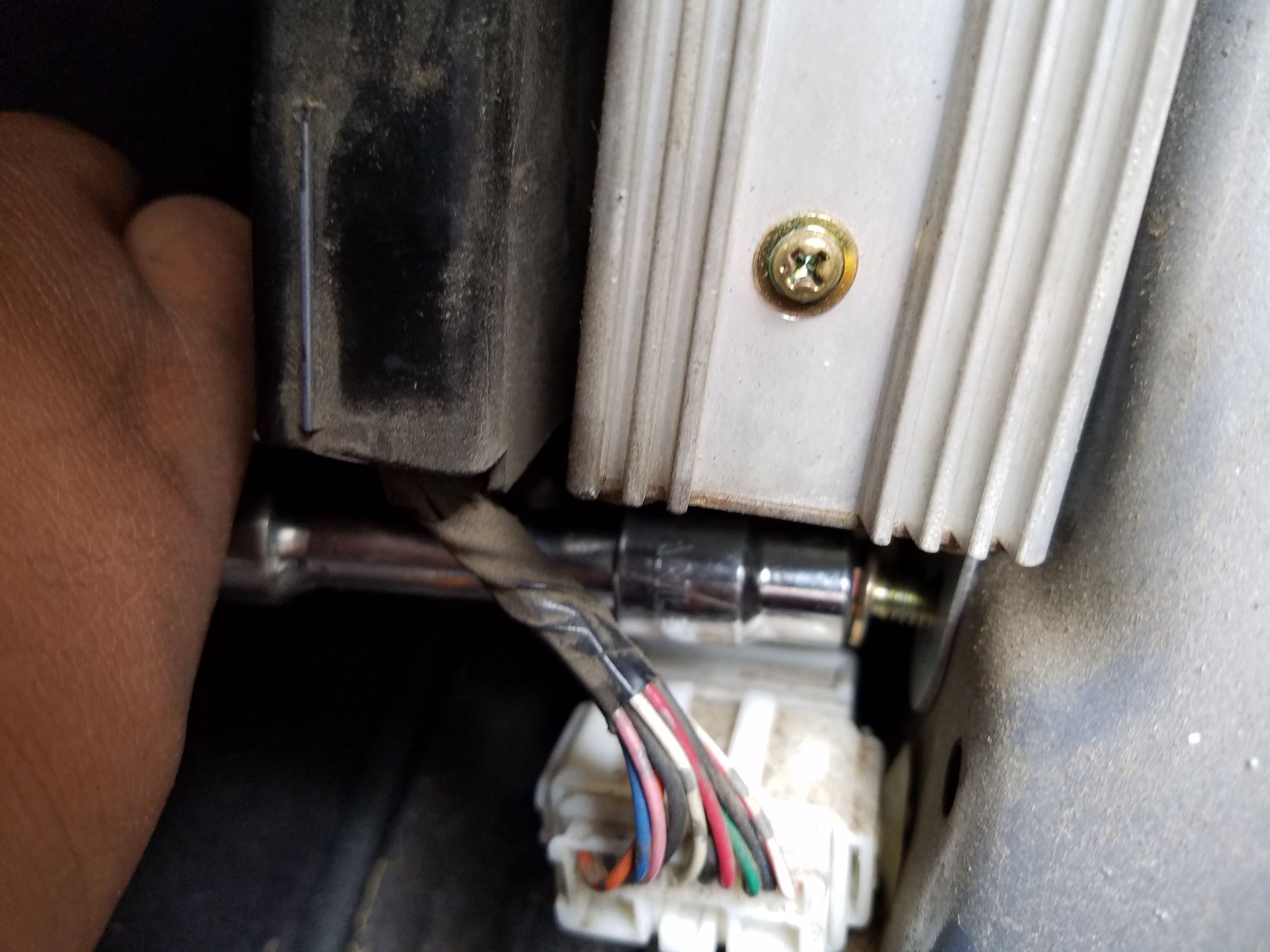

Amp install(old amp)

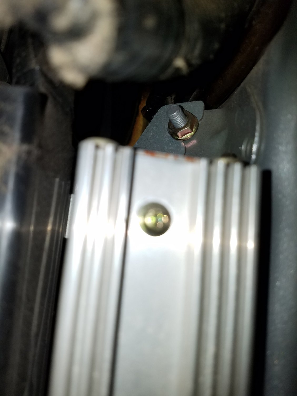

Taking out the first of two 10mm bolts
Top 10mm bolt in an slanted position
Amp install requires a few extensions and a 10mm socket
Finally got it at a certain angle

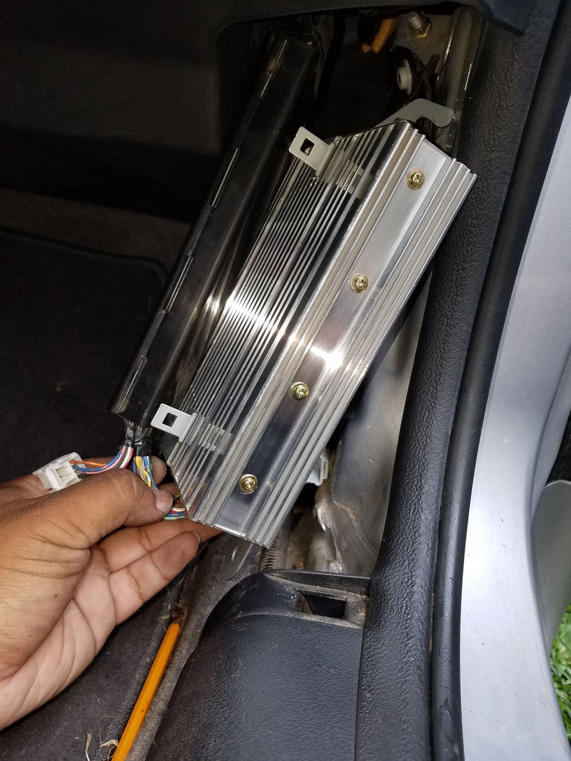

Damn thing didnt wanna come out
It finally gave in!
PA amp coming in hot!
Plugged back both harnesses and rescrewed the two bottom 10mm bolts

Dude, you just hacked the dashboard trying to take those tweeters out. Ouch. They come out so easily.

That dash was toast to begin with. Looks like it's got brittle bone disease.

Sadly the dash came to me like this. And yes, its very very brittle. I'm thinking about buying a brand new dash but I think I've put enough money into my TL already. I pretty much brought it out of the grave. And it looks a lot better than other TL's in my area.

Nah, OP just got careless when prying (pried on the wrong part of the tweeter) and cracked the dash himself.

true...The dash is already pretty f-ed up. And the dash was pretty brittle. This was my first tweet install and I didn't know where to pry.

I would just buy a good quality dash cover if I were you. A brand new OEM dash will run you like $750. A used dash in good condition will be (estimating) $300-$500. A dash cover will run you under $100.
I am looking at buying one for my car to protect my dash. Now that you have new audio equipment, the dash mat will also add to overall sound quality. There will be less reflection off the dash cover carpet then the plastic. A lot of guys in the sound quality scene run dash covers for this reason. So you win in two ways.

For future reference, if you don't have the appropriate plastic un-clipping tools, you can always use a butter knife or screwdriver with a microfiber cloth for protection. It's better than using a spoon

No the spoon was to support the screw driver that way it wouldn't cut the dash...But since my dash has seen better days. Also I'm Asian, we don't have butter knives. It's either a giant butcher knife, pairing knife, or a long cutlery knife lol. My house has every knife you can name. ALL but a simple butter knife.

so how'd that work out for you?

It kinda worked lol
