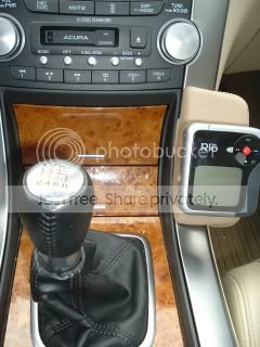

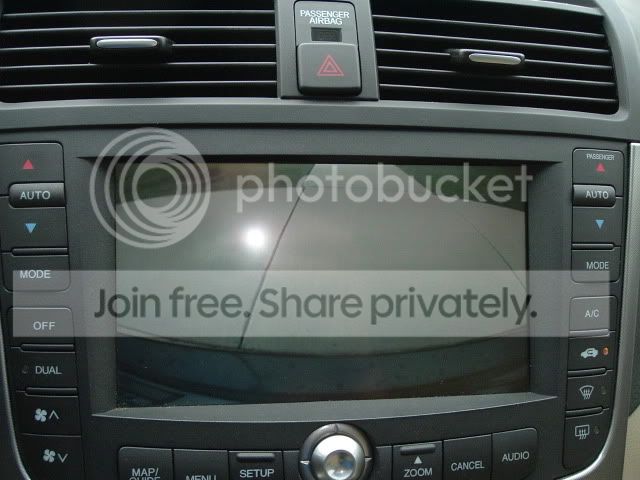

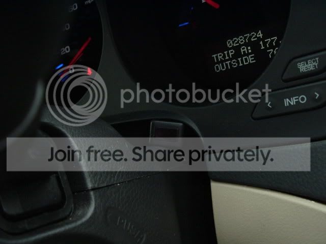

Ok Guys, I spent most of this wek in Nags Head for a family vacation and I took all my tools and junk with me. I had a DVD install done by the same people who did SlimmyJimmy's but to be honest, they did an incredibly piss poor job. I was really pissed at how bad an install they did, so I decided to chalk it up to a learning experience and do it myself. Here is what I came up with... Hadn't seen this yet, so I gave it a shot. Took some serious fabrication and several pieces of my baby were left down in Nags Head in order to make this work...
Components:
Doms Unit
Wendys Camera
DVD Switch
PIE X3
Myron Davis AD212 DVD Player
Rio Karma 20g MP3 player wired to PIE X3
Console
Camera
PIE X3 & DVD Switch
IR Sensor
DVD Screen
DVD Player
Wired MP3 Player
Let me know what you guys think... Wasn't too hard to do but it was the most custom thinghave ever done... The door works perfectly and everything is working this time so it is actually done this time and it is done right....

Originally Posted by bar2v
I can't believe you actually fit the DVD Player in there with the door! From the measurements I took, I thought it was impossible. Congratulations, looks great. Please show us how you did it!
It doesnt fit... and the one thing I forgot to take with me was my Camera.
There are two things behind the center console preventing this unit from fitting. A metal crossbar that holds a large wireloom in place and the black ducting for the AC.
The Metal bar was removed, just cut it off with a Dremel, then the ducting was 'adjusted' with a hammer to make it flatter. Once it was flat enough, the player fits. You can see the player is off center behind the pocket, this is because the left side of the pocket has the door mechanism and you cant mess with it. There is just enough room left for the disk to eject.
The pocket was cut down to fit the player, but the top of the pocket and part of the sides could remain intact...

Originally Posted by datmrman
Can't believe you actually cut that bar there. That was the bar that was standing in the way of me "mounting" the Mediagate in that top compartment. I didn't even consider cutting the bar was an option. How much of it did you cut/trim off?
About that mount for your Rio, where did you pick that up? It matches the parchment interior quite nicely. I wouldn't use it though, but just thought I comment on the match.
I cut off all of it... Made my cuts on the blue lines here:
The insert is called KUDA. Interesting that you comment on the match... this is the Camel color that matches the Camel interior. I bought this when I had my OTHER 3G TL with the camel interior. It is very close, but they do have a Parchment that is an exact match:
