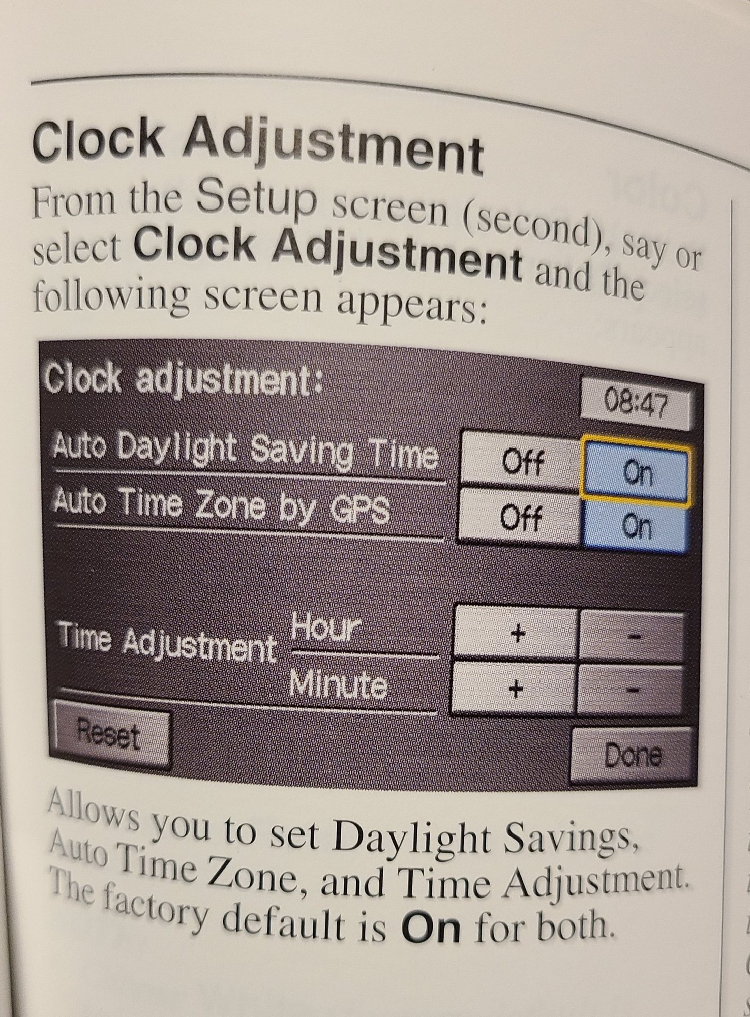

The only reason I want the disc is because the clock is not the correct time and I want to change it.
Can you change the clock without the navigation disc?3

My Trunk disc reader failed and I have had no Navi for over a year. My clock works fine.

Believe the dvd just has the maps. There are supposed to be adjustments on the navi screen, but can't confirm, i run an aftermarket dvd navi unit.

the clock not being able to be set is a known issue that there is no solution for. unplug battery at 1:00 to get accurate time

619rcr when I hit the setup button on my dash console it gives me the Disc Read Error. I can not access anything in the set up or menu.

Since you have a 2007/2008 unit you can buy a used unit from ebay (make sure you get the VIN of the car it came from) or you can send it to alpine for them to fix. With the DVD error, you can't get into the settings menu. DMZ is referencing the 2004-2006 TL issue with the system being dated and not able to change time. 2007/2008 drives do not have this issue.
